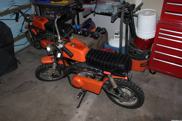

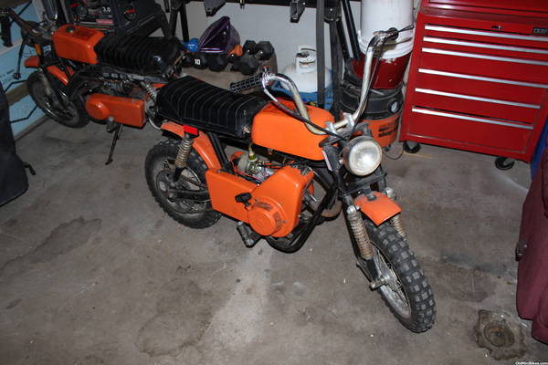

If you could take and post a picture of your bike it would be great because it would be easier to ID your engines. The 550 and 650 were the same, just different motors, 5.5hp in the 550, 6.5hp in the 650. The 5.5hp BSE had a full shroud and recoil, the 650 just had a recoil that bolted to the block.
ok we'll find out in a minute if I did the picture download thing properly:
Bikes
Serial Plates (not sure if this is at all helpful)

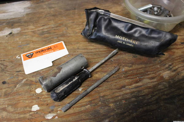

And just for fun and trivia, the original tool kit and 'service card'
Hopefully that helps?
You have 2 nice bikes there, and the original tool kit is cool too. Yes, those would be 550's, the 550's only looked like that in '72, in '71 they were the same frame as the 450.
