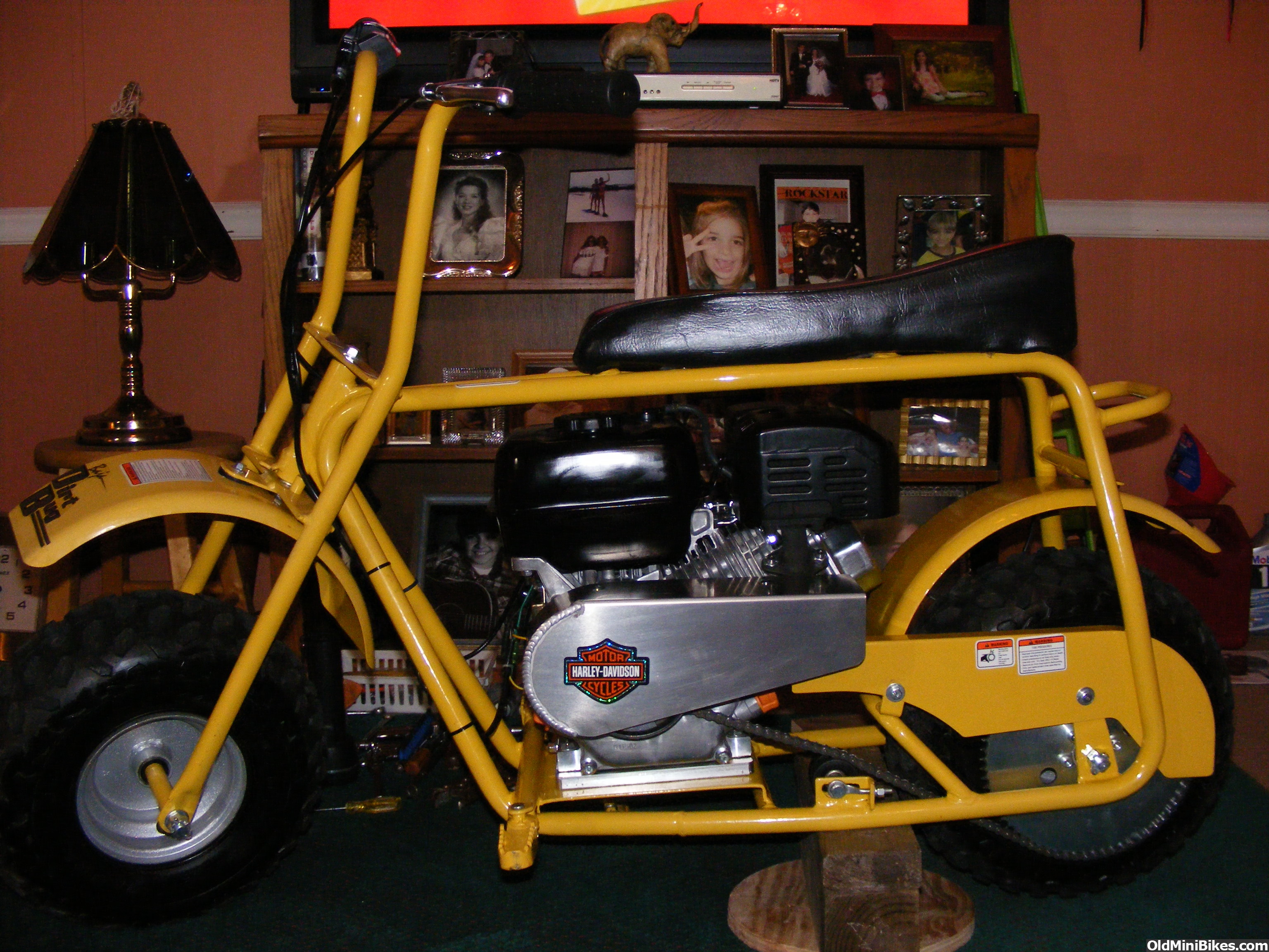

I just installed a 212 in old style striaght frame so I did not have to cut the fender, butt had to remove 2 chain links. I used a #35 tool for this. You can also use a drimel with grinder wheel. When you have more Q's I will try my best to answer. This was my 1st rodeo also. Came out pretty good...
