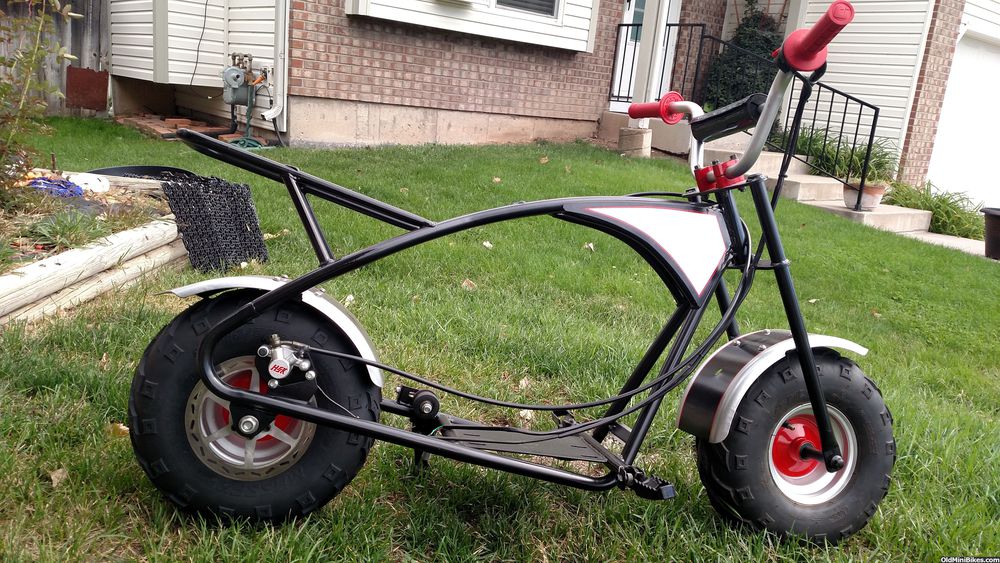

Nice job:thumbsup:..i like those style frames .those v tread tires seem to be pretty streetable..had em on mmb80
These treads are very streetable... They grip well and ride smooth. I like them because they're a nice in-between. They do well on dirt or asphalt.

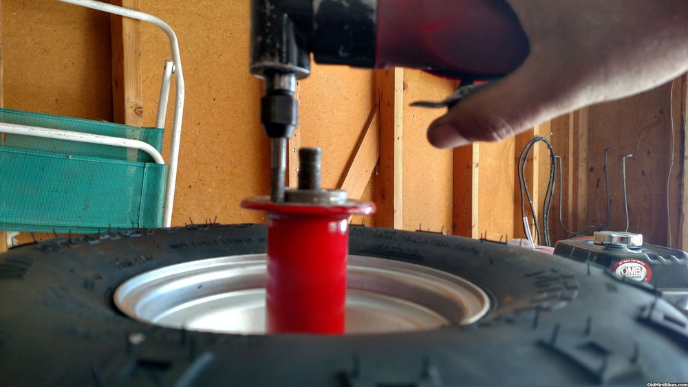

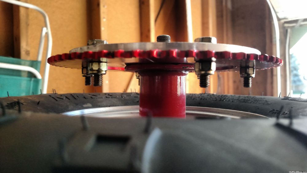

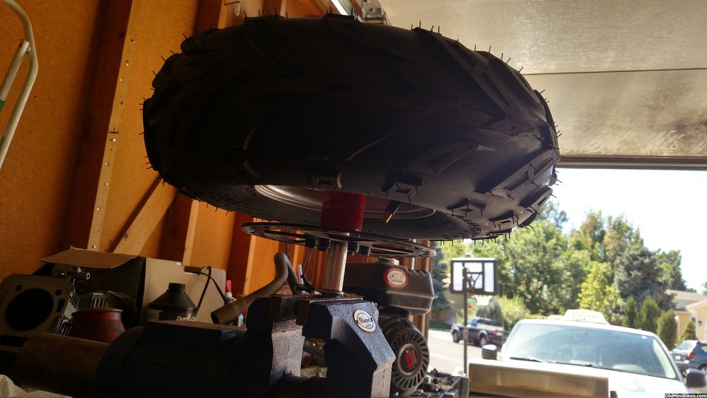

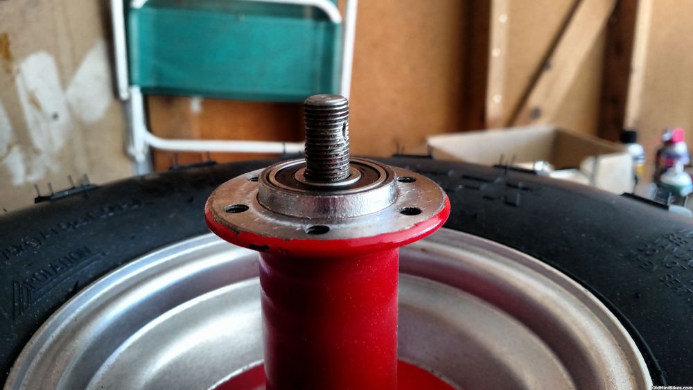

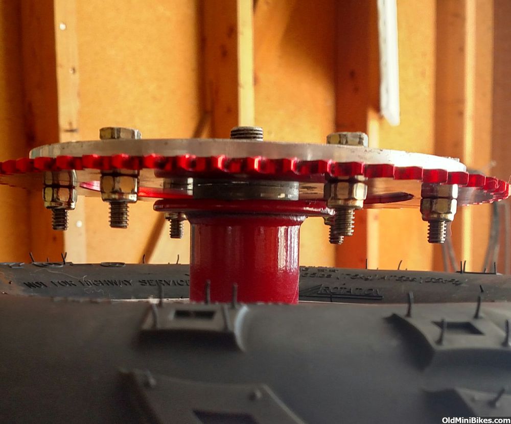

*HOW TO; MAKE A DOODYBUG SPROCKET ADAPTER FIT A MOTOVOX WHEEL*
I mentioned while building my daughter's Build-Off Motovox, how the DB sprocket adapters do not fit the larger wheel flange on the Motovox wheel. On that bike, I just used a spare DB wheel, but I'm all out of rear DB wheels...
Damn bench vice has gotta be one of the handiest tools in the shop. I use a spare axle and spacer in the vice to do my tire changes and that same setup comes in handy for this also.

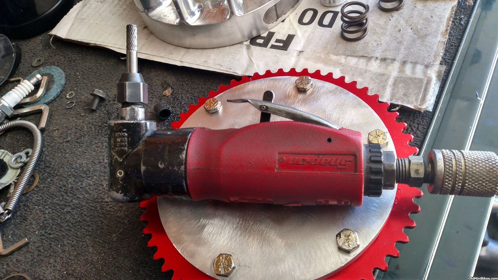

Another one of my favorite and most used tools, an angle grinder and various surfacing/grinding attachments. This time a small carbide bit.
I just spin the wheel in the axle opposite direction of how my die grinder is spinning and shave off the outside of the wheel flange. Might be crude, but works well for those of us who don't have our own lathes.

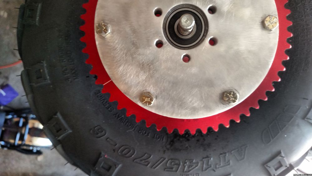

I'm always careful not to shave too much. It's better that the sprocket adapter fits a little snug rather than loose.
Perfect fit...
Now the rear wheel is on for good, shouldn't be any reason for it to come off again. I used a 57t split sprocket that I just happened to have laying around. I also installed a longer Doodlebug throttle control and tube to fit new red ODI half waffle grips. The Motovox throttle tube is too short and standard size grips are too long for them.

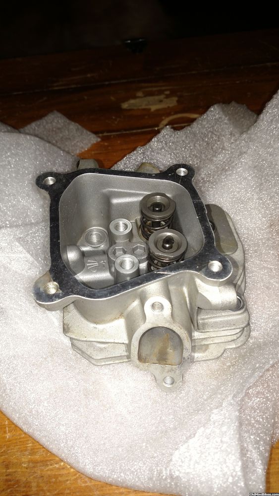

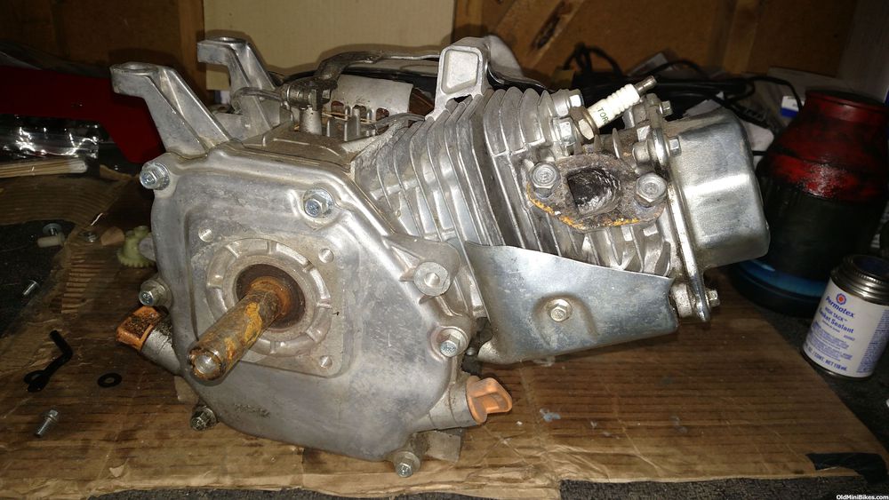

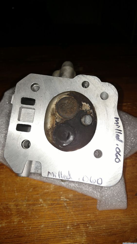

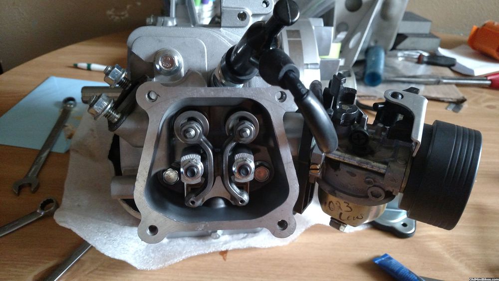

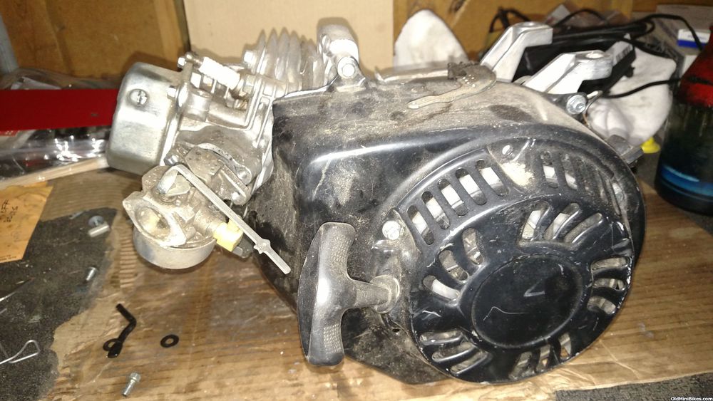

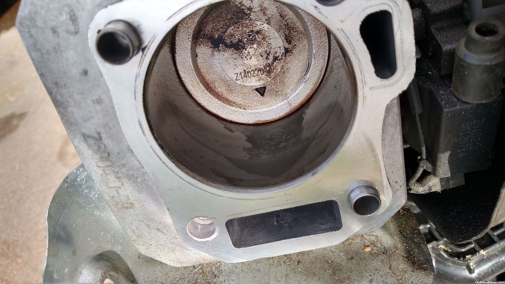

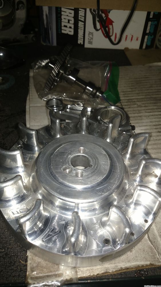

This bike will be getting an old non-running, non Hemi Predator rebuilt with the milled and ported 5 bolt Grayhound clone head from the Grayhound I blew up. The head was drilled out to fit the larger dowel pins in the non Hemi block and the 22lb springs were replaced with new ones. I'm re-using the stock piston but with new rings and a new .020 over ARC billet connecting rod, ARC flywheel and Dyno Cams CL220 cheater cam.

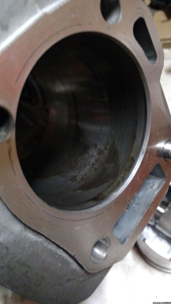

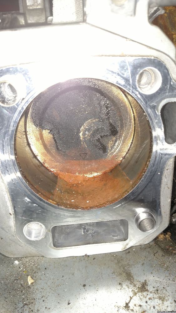

The block I determined to be no good. Water had sat in the cylinder and rusted, causing some pitting in the cylinder walls that wasn't going to clean up with a hone,

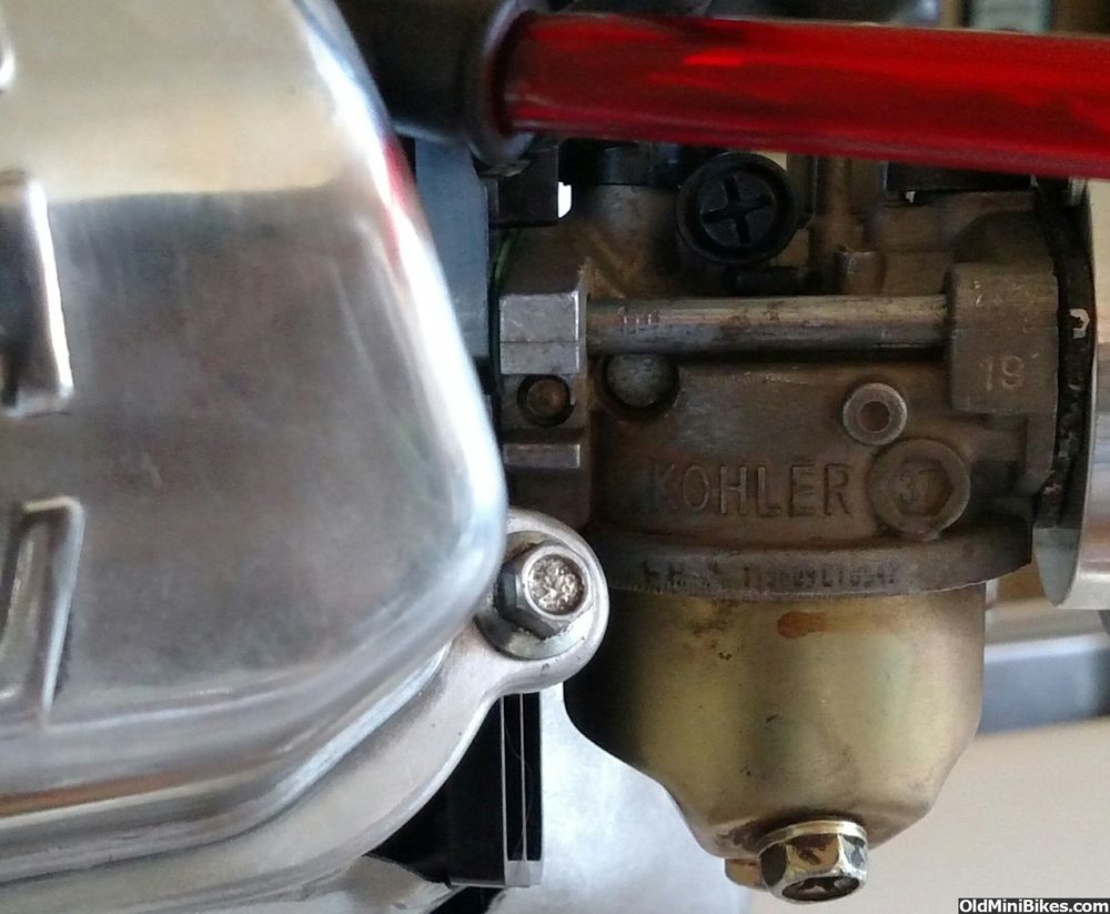

so I ordered a brand new non Hemi block from eBay and also have a big bore Kohler (clone) carb on the way from my dude Dan at Childish Concepts

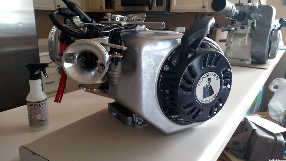

Depends on your​ offer, and funny that you should mention that, because this one will be for sale. I want to test the waters with a higher end fully built and complete mini bike for sale... Even though it is just a Chinese mini. It was rebuilt and customized right here in the good old USA with a bunch of quality American made performance parts in it's engine. Only see junk for sale locally.

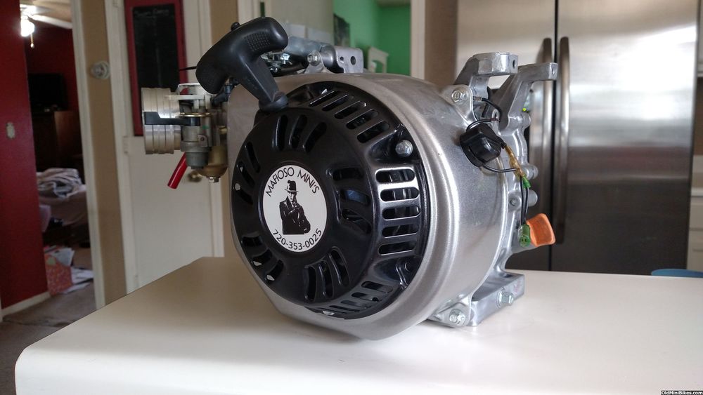

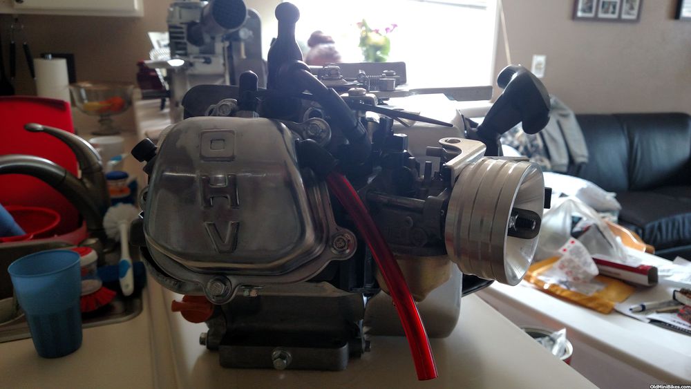

My "Junkyard Dog" motor is now complete. I need to get a new stock gas tank for it still. I spilled fuel all over my freshly painted recoil housing and need to re-shoot the silver, but she's done and a good runner. It's a bastard hodge podge of parts that seem to be quite happy together.

I like my new 212/clone head hybrid
too much to let it go with the bike and since this bike will be for him and his inexperienced 10yr old son to share, I will be sticking in my Box Stock Clone Project motor, with flat top piston, BSP3 cam and PVL aluminum flywheel,
minus the large valve, milled/ported clone head, Champion roller rockers, 22lb springs and big bore carb,
which I will be using to delete the Hemi head on my black DB. Instead it will get a .060 milled but otherwise stock clone head with 18lb Honda springs and stock "Mile High" re-jetted carb.
