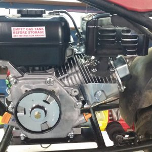

    Hi all, new to the forum. I got a lot of initial info on here before getting started, hoping I can contribute. Every time walking through Harbor Freight I've stopped to look at the bargain Predator 212CC motors but never had anything to put one in, finally found a good candidate for a swap...
  15. MBX10 Build
    MBX10 Build
    requires about 10 extra inches of chain

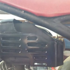

  16. MBX10 Build
    MBX10 Build
    Valve cover just clears the rear fender

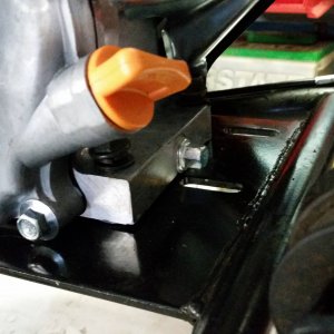

  17. MBX10 Build
    MBX10 Build
    Oil drain plug lines up great with stock motor plate

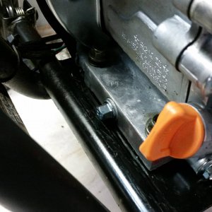

  18. MBX10 Build
    MBX10 Build
    Just fits
