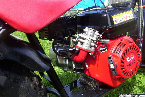

You know what's another nice carb no one ever talks about?
The HL 166...
It almost the same size as a stock carb ( just a touch larger )
But its turn a screw to tune without the hang ups that the big tilly race carbs bring to the table.
AND it has its own fuel pump built in!
I often wonder what became of this carb and Intake.
I have seen pop up a couple of times for sale here and there on the OldMiniBikes but I have never seen it mounted and running
This did work well once I got the linkage kinks out ( its link kit was sold with it too )
