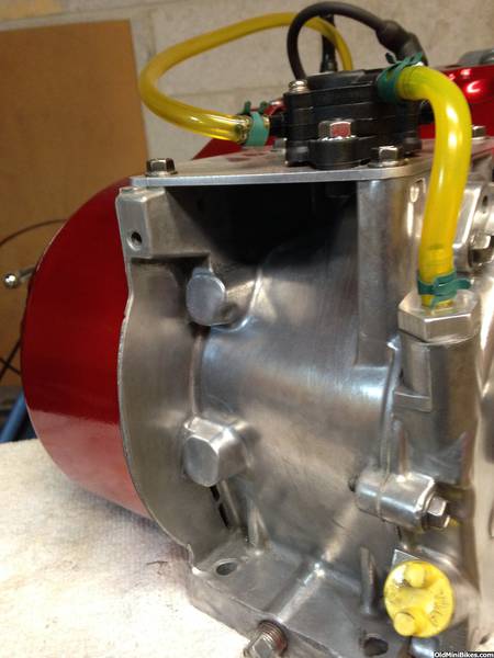

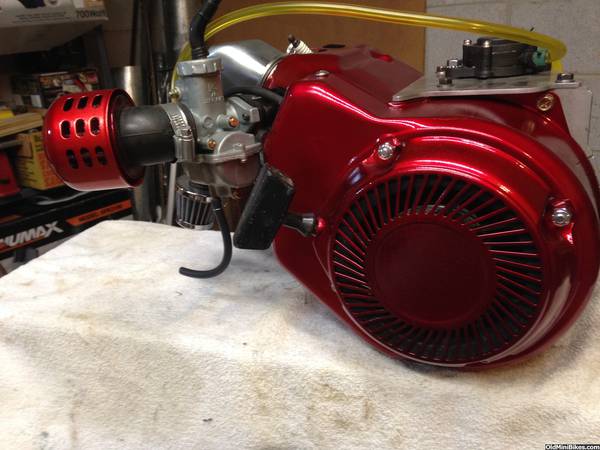

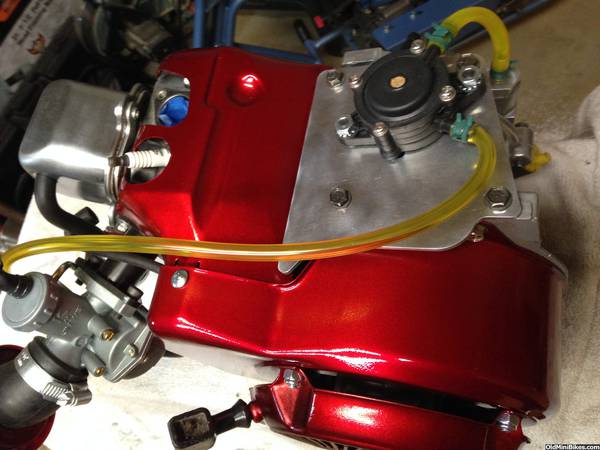

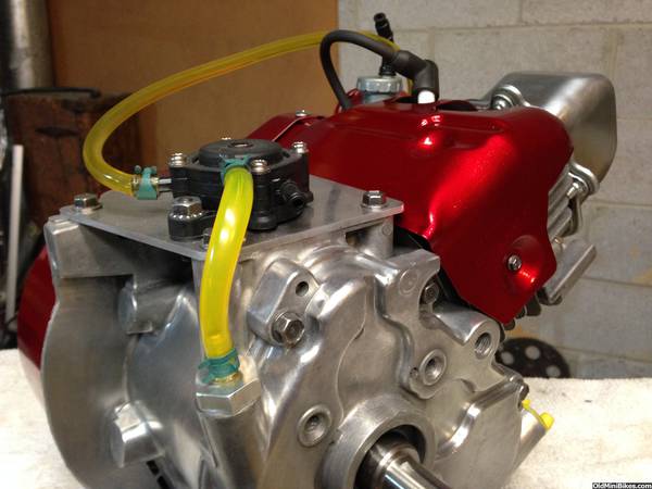

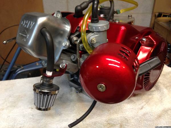

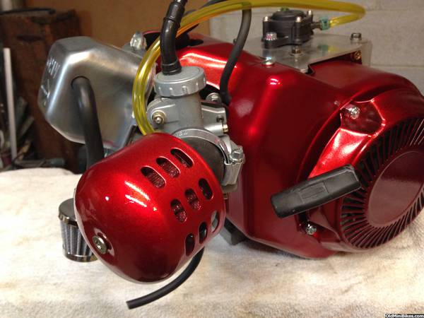

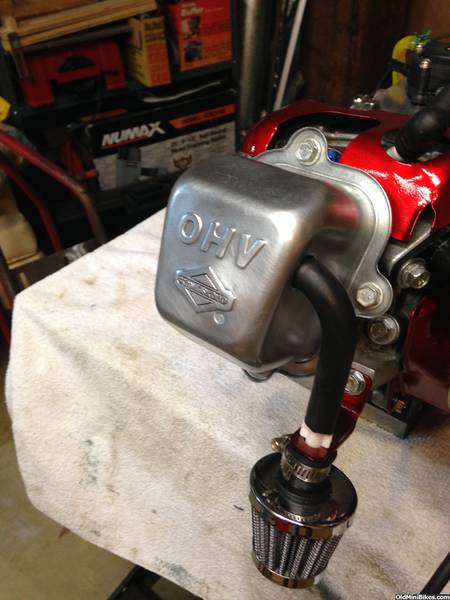

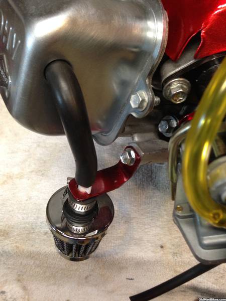

More pictures of the Quas-Animal
Per the previous owner's (OwenD) request:laugh:, here are pics of the engine assembled. The clear coat has to cure for a while before I mess with it any more. Stock exhaust will go on it for initial testing.
