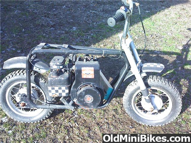

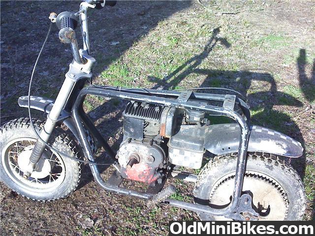

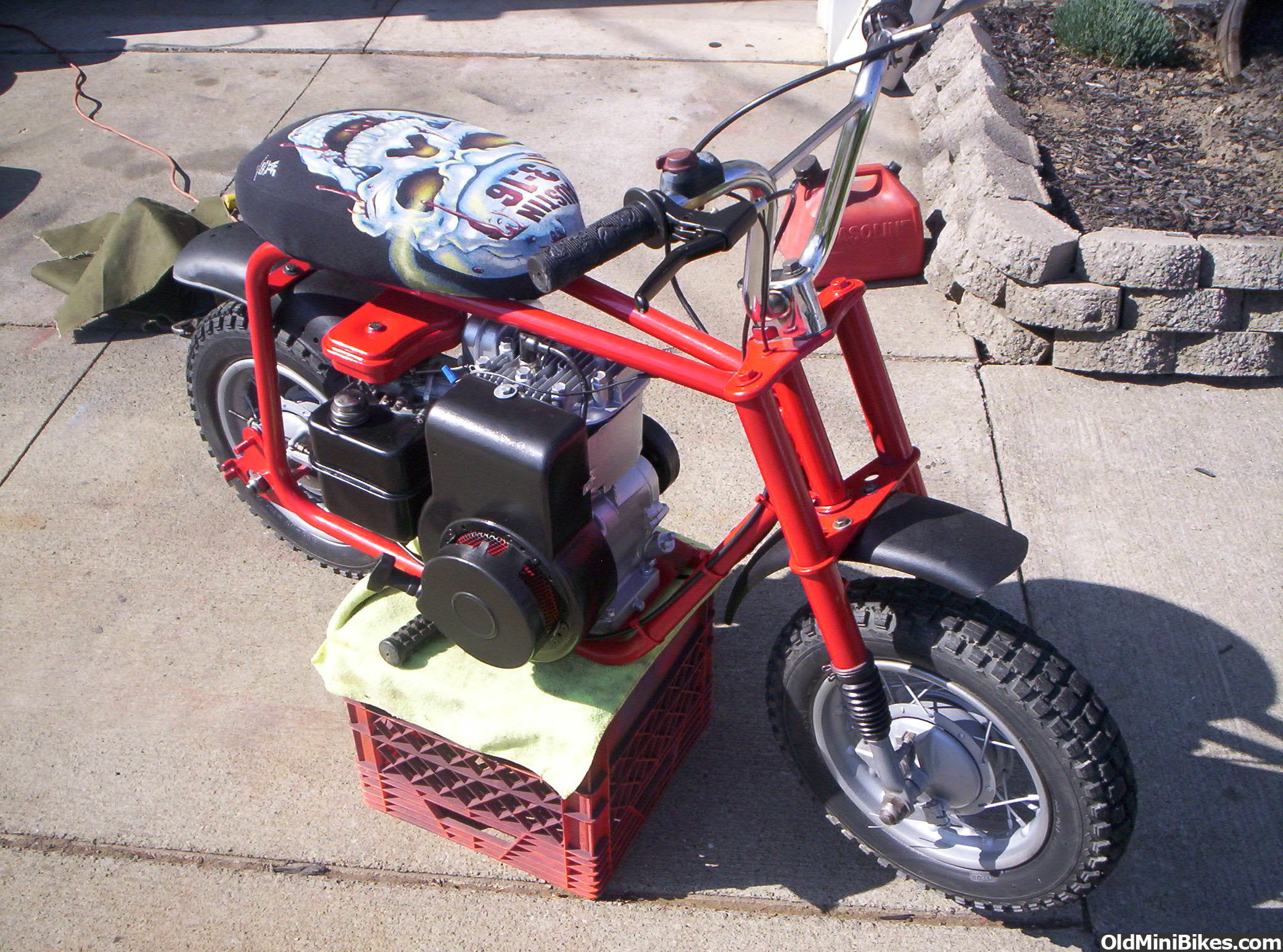

I bought this last weekend for $60 delivered.The engine was locked up and it was neglected for years.I stripped the motor down and got everything free'd up and got it running again.The frame was cut out to accomodate the 5hp and the plug position.I cut a piece of conduit and shaped it to the hole size and welded it in place and did my bodywork .Stripped and repainted it.I had an old manco seat ( I know Kenny will rip me a new one for this LOL ) but the seat had a rip in it so I covered it with an old skull t-shirt.
Long story short I sold it tonight for $275. Total investement $90 and The kid loved the skull seat.
Before
after
