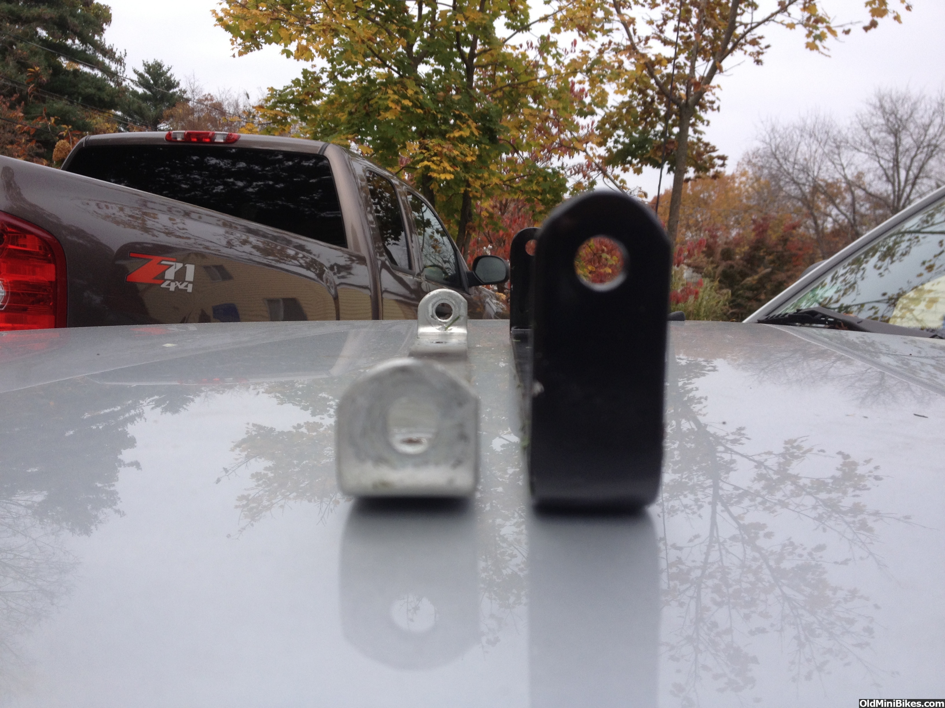

If I can figure how to get mine apart, mine have the lower eye welded on and don't match up with the Betor or Sebac shocks found on other SB's (found this out after doing a search on this site for how to take mine apart). If I can get the shock apart enough to open up the lower tube of the shock, I may start experimenting with adding springs inside the tube to see if I can get the shocks to stiffen up. Depending on how that goes (or doesn't), my next step would be to cut out coils and re-stretch the spring. I would like to keep the OEM look as much as possible, yet stiffen up the shocks since I am a heavier rider.
My last resort will be to order a set of shocks from Treatland.tv. They're more expensive than the set that the surplus/Northern Tool sites carry, but they are the correct size (340mm eye to eye, roughly 13") .
I can't vouch for them that they are stiffer than OEM, but they are at least adjustable and
appear to have a thicker spring than the ones on my SB.
https://www.treatland.tv/xtreme-black-adjustable-shocks-p/xtreme-340mm-black-shocks.htm
These are the Northern shocks, 12" eye to eye is 1" too short, so some kind of adapting would need to be done.

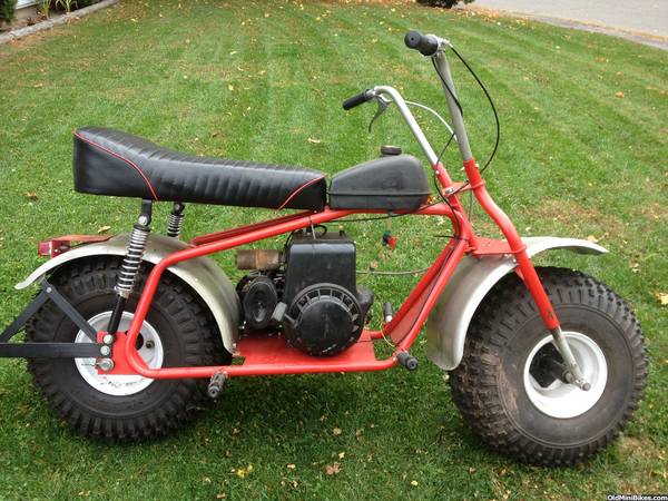

Well I am 350 pounds and with the shocks I put on and the extended mounts from Jeep. It is much stiffer than before. I like it much better. I want to say I bought the cheap shocks that were 730 pound compression or something. I don't know if that was each or probably for the pair. But With the extra height and stiffness I dont worry about bottoming out on the fender or muffler like I did before. I had to change the muffler because of it. I have changed it since this pic was taken.
I think I got them from MFGSUPPLY. I think they are the ones in this link. http://www.mfgsupply.com/gomini/gominisuspension.html
