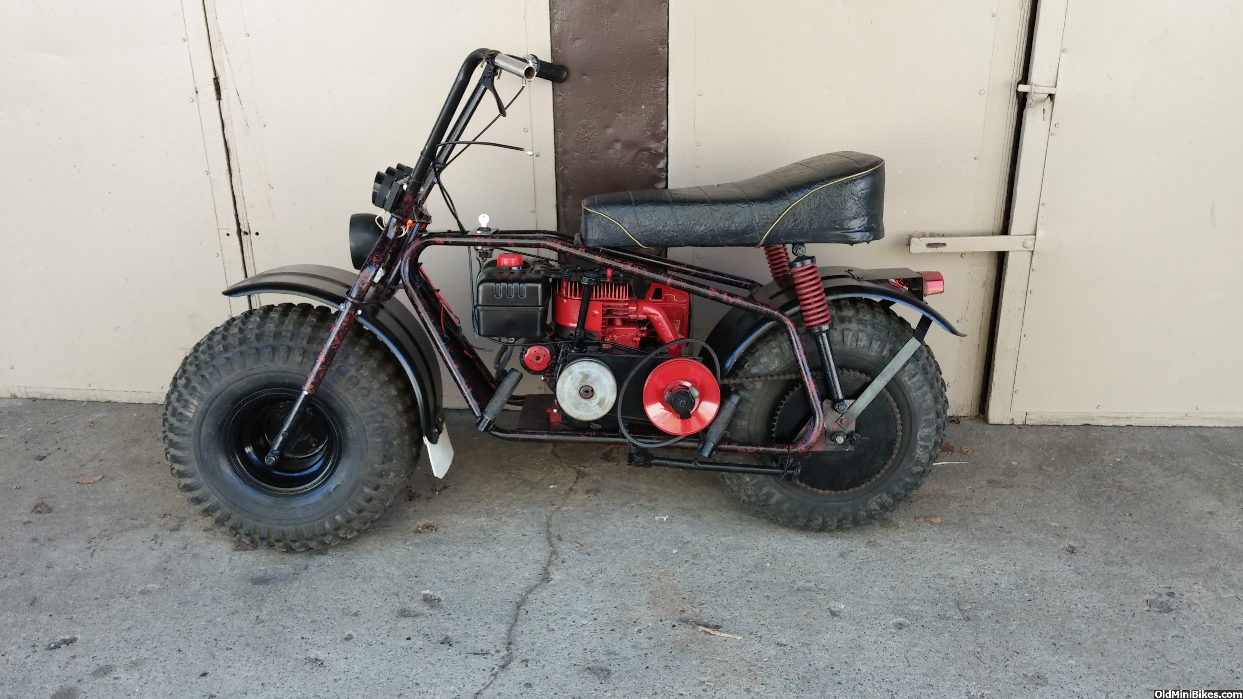

So here is my official entry photo, complete with my versiuon of a coffee mug.

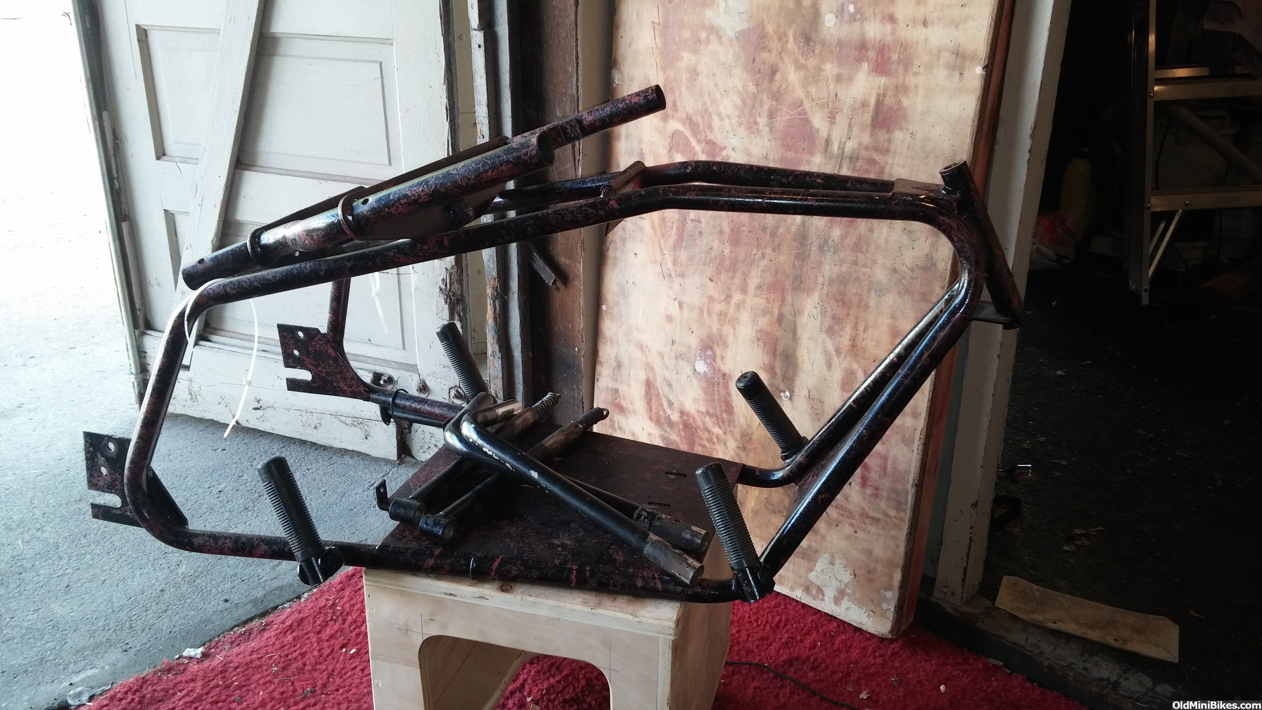

I've mostly been removing paint and working on the motor so far. In some places the paint was a 1/4" thick. I've got the fenders pretty well done, they'll be repainted, the chrome is trashed. The frame and front forks I'm still working on, may have to take them to a blaster.
I started on the motor mostly, it was in sad shape. When they painted the bike they used house paint and a brush and they painted everything. The carb was so bad the linkages wouldn't move. Started taking the motor apart, pulled the TAV bracket off and found they had used the wrong length bolts. 3 out of the 4 holes were busted out the back and 2 of them had cracks coming off them. So started the hunt for a new motor, found a 10hp Tec on craigs off a generator, but it had the wrong crank. Did some checking and discovered the 8hp and 10hp used the same crank, swapped cranks and now have a running motor and an upgrade, it's now a VT-10.
That's as far as I've got right now. I think I'm going with a military theme, have a lot of camo green paint off another project. Here is a partial list of things I need to do.
