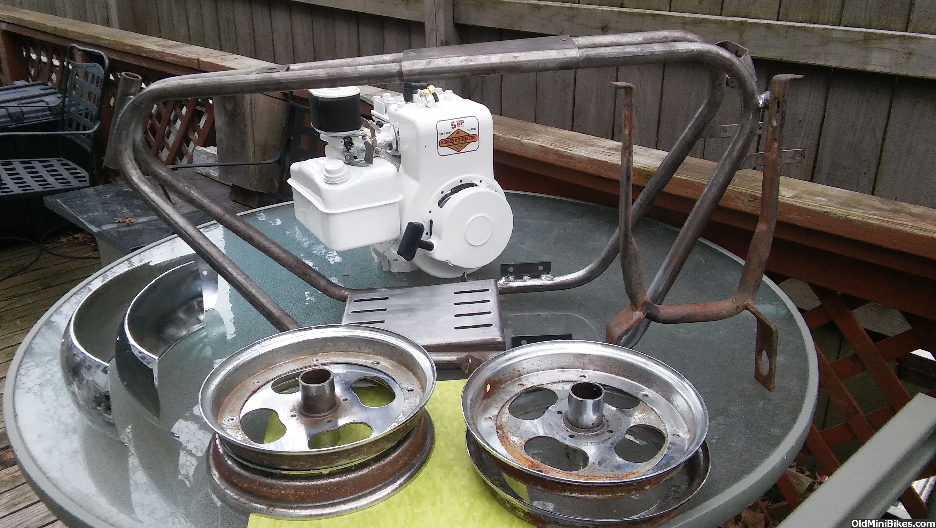

Sheesh! Getting sick of looking at this not going anywhere. So I picked up a few things to get my interest back up.
Forks came in this week for the custom triple trees.
I picked these over PW 80 forks, I thought they would be a little easier to work in a front brake.
Also picked up some 13" sebac shocks for the rear. Cleaning & prep. wheels so I can start mock up soon.
I'm going to need custom Sprocket & Brake, Spacers/hubs for these wheels. A very specific width will be needed for this to work in the Trail horse swing arm. After I figure what sprocket & brake drum to use. So that's my next Task, any suggestions are very welcome.
