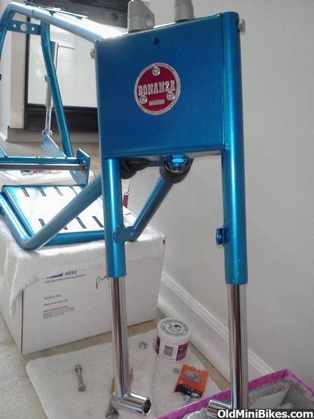

Hey Ken,
where you took that top bolt out, that is a round plug that holds the top of the spring, and normally that is what is getting hung up. That is the piece you need to get moving. I sprayed PB Blaster through the top of the handlebars and let it set for a couple of days. At that point I used a large punch to try and wiggle it up and down until it moved. Don't booger up your forks doing this! Once I get them moving, a little more Blaster was needed, but after that they pulled right out. It does take some muscle! A little twisting forth and back doesn't hurt anything!
Good luck!
