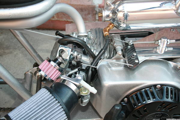

Perhaps make something like this?
Its a semi progressive linkage with a honda style rod off the bell crank.
It should work on your carb too.

CarPlayLB
I used the stock pred 212 carb and rebent the linkage. This is nothing special! All I used was some 1/4 aluminum plate, a bushing, some carbon fiber, a shoulder bolt, a funky domed piece that was laying around and some time. Easy! You can do it!

Looks simple and clean nice! Thank you LB and Newoldstock for pointing me in the right direction. I'll post a picture when my linkage is done. :thumbsup:

See that top plat he has?
You should make one and use it.

It can be a pain in the A$$, but ya gotta get creative. The top plate I did for my clone was fairly easy to build, but you need a vision to get started. Overcoming these obstacles for me is the appeal of minibikes! I am putting a GX200 carb on a Briggs flathead and trying to do a rear mounted cable. I will post some pics when I get closer. The hard part for me is wrapping my around the throttle on the carb. That funky plastic thing doesn't give ya a lot to work with. If I had any skills and tools other than a hammer and screwdriver, I would take the plastic thingymabob off and throw the shaft in a lathe. Then you could drill and tap a hole on the shaft itself and attach an arm to it.
