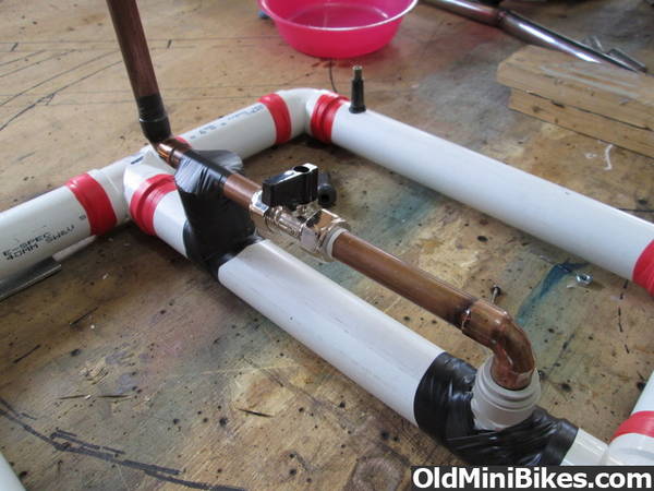

Could not find all I needed for the bike over the weekend so William Tom and I spent time in the shop and knocked this together.
Cheap as hell easy to make and an hours worth of fun running around catching rockets.
It's made from 40mm pvc plumbing pipe has a car valve for filling the air and a simple stopcock for the release. The rocket is made from 22mm pvc, slides nicely over the copper tube, turned down the end of a broom handle for the top and the fins are hot glued on from an inspection hatch sawed into quarters.
Shoots up about 15 yards good fun, started filling with the car foot pump, but the more dadda more made me swith to the compressor:laugh:
