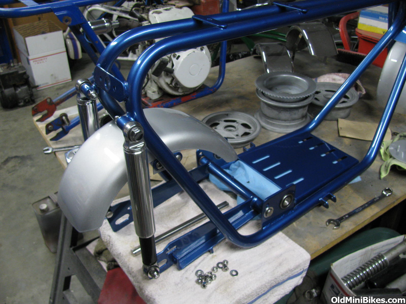

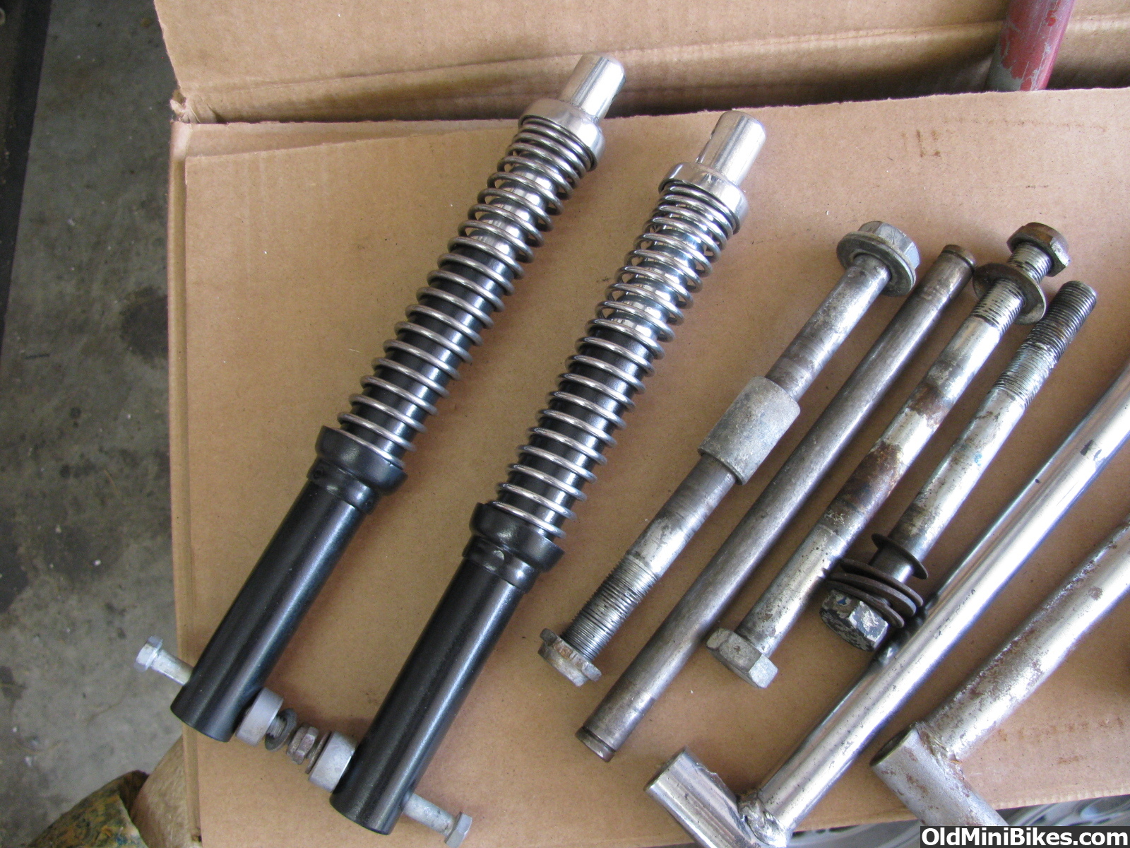

These were the typical ones on the mid peg 1400/1500 bikes which I believe were 12'
If your bike was not an actual 14/1500 though or an earlier frame you may want to double check the shock mount point as they used shorter shocks on the lesser frames.
If the frame is a 14/1500 you can use sebacs, or alot of other choices pretty easy. I used a set of moped shocks on a buddies bike I built for him to save some $$$ :laugh: sebacs are usually 11 3/4" so they are a smidge shorter that the OG ones

I just did a little searching and do see the different shocks (not Sebacs) on the 1400/1500. Had to find what looked like an unrestored bike. I see those same shocks in your picture Markus.
There's a set of the correct bc1400/1500 shocks on eBay right now. They belong to a member.markus has the correct set pictured with black bottoms
