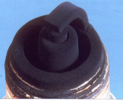

Make sure you aren't running too rich. Too much carbon buildup will kill a plug in a few hours.
Get a new plug, run it for a few minutes, and pull the plug. If it is black, you know your problem. You want the plug to be tannish/brown.
