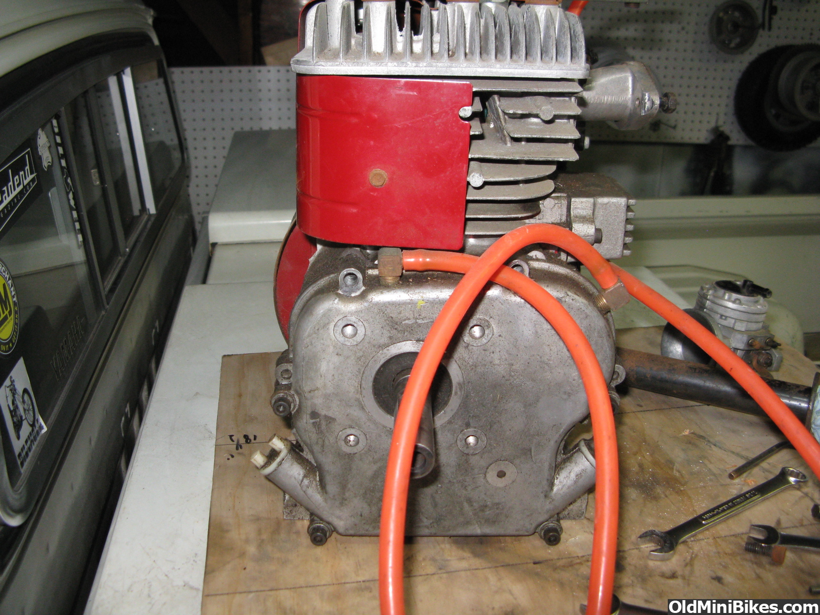

Hey guy's I picked up this motor for 50 bones at a modern go kart swap meet last week.
I couldn't pass it up price with the pipe and manifold and carb but I'm not sure how to tell if it is
a gas or alcohol motor?
Thanks Michael

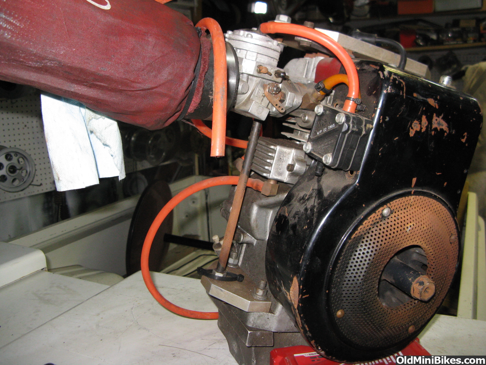

Get the numbers off the carb. Chances are, with all the fancy stuff on it, it was a meth or alky motor. Nobody uses a head girdle on a gas engine! Take the carb off of that and I'll double your money!:laugh:

Numbers on the Tillotson HL363A 521 looks like a 1 bore.
What is the purpose of the tubes coming out of the top of
the side cover? Their are 5 different hose'es on this motor
where do they all go?

Yes that's an alcohol motor, pull the head and look at the bore then pull the side cover to see what else
has been done to it. that was a very good score for what you gave for it. by the way that is a true Raptor motor.

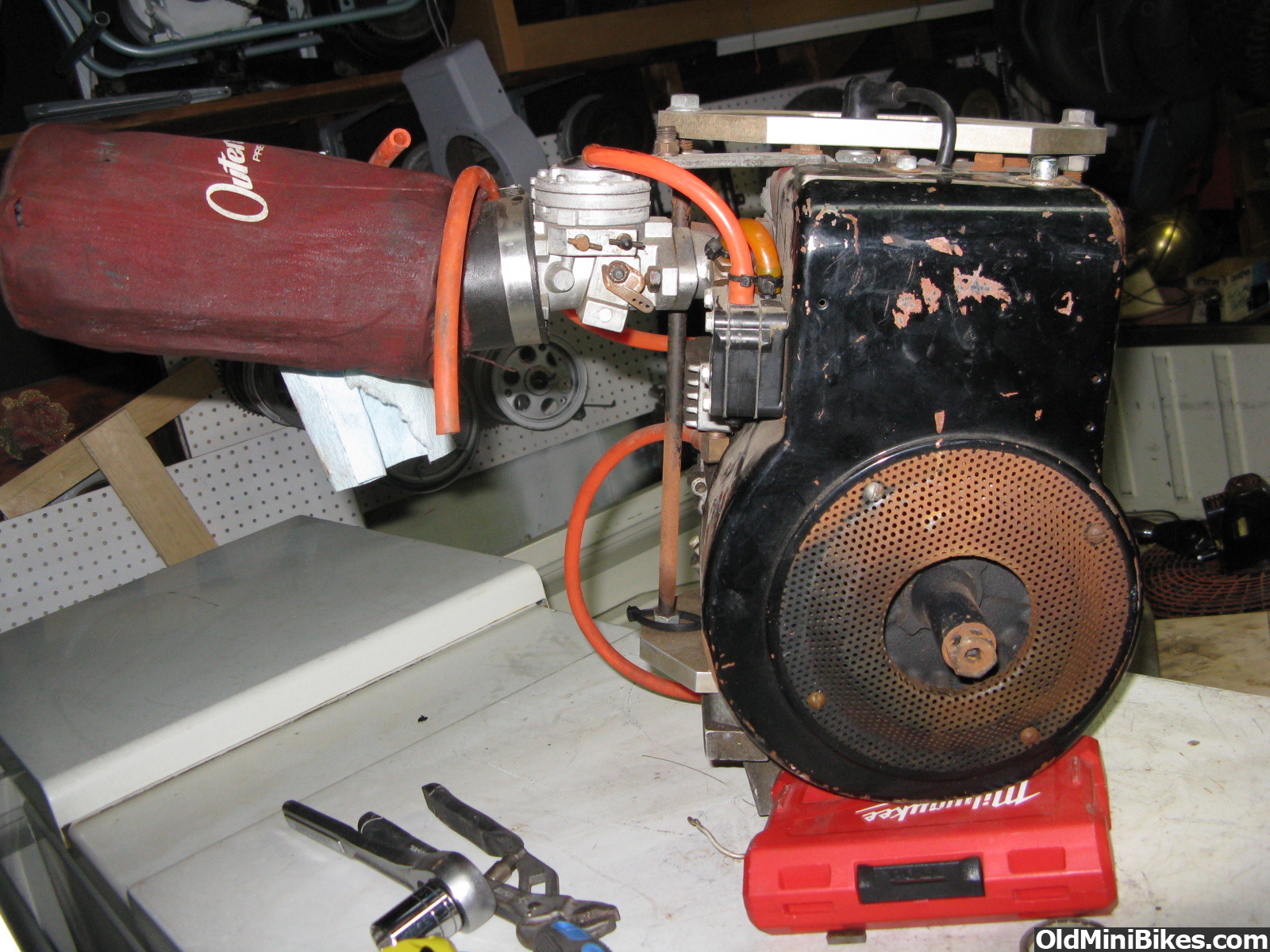

So how can you tell it's a early Raptor?
I got the starter nut off.
So what am I looking for when I open her up?
Did ya see the allen head bolt in the governor hole?

You also have a 3HP flywheel...which to me is kind of a boo boo! I would not run that....and Grandma's edger has not been used since the flywheel was jacked!
Someone could have drilled out the gov boss and threaded one in there to fake everyone out. Pop the head off and see if the valves are angled towards the piston, or flat like the rest of the flatheads.
I think he scored a $50 Tilly and a cool breather cover.
Hoses are for intake pulse to run fuel pump, as well as fuel lines.
