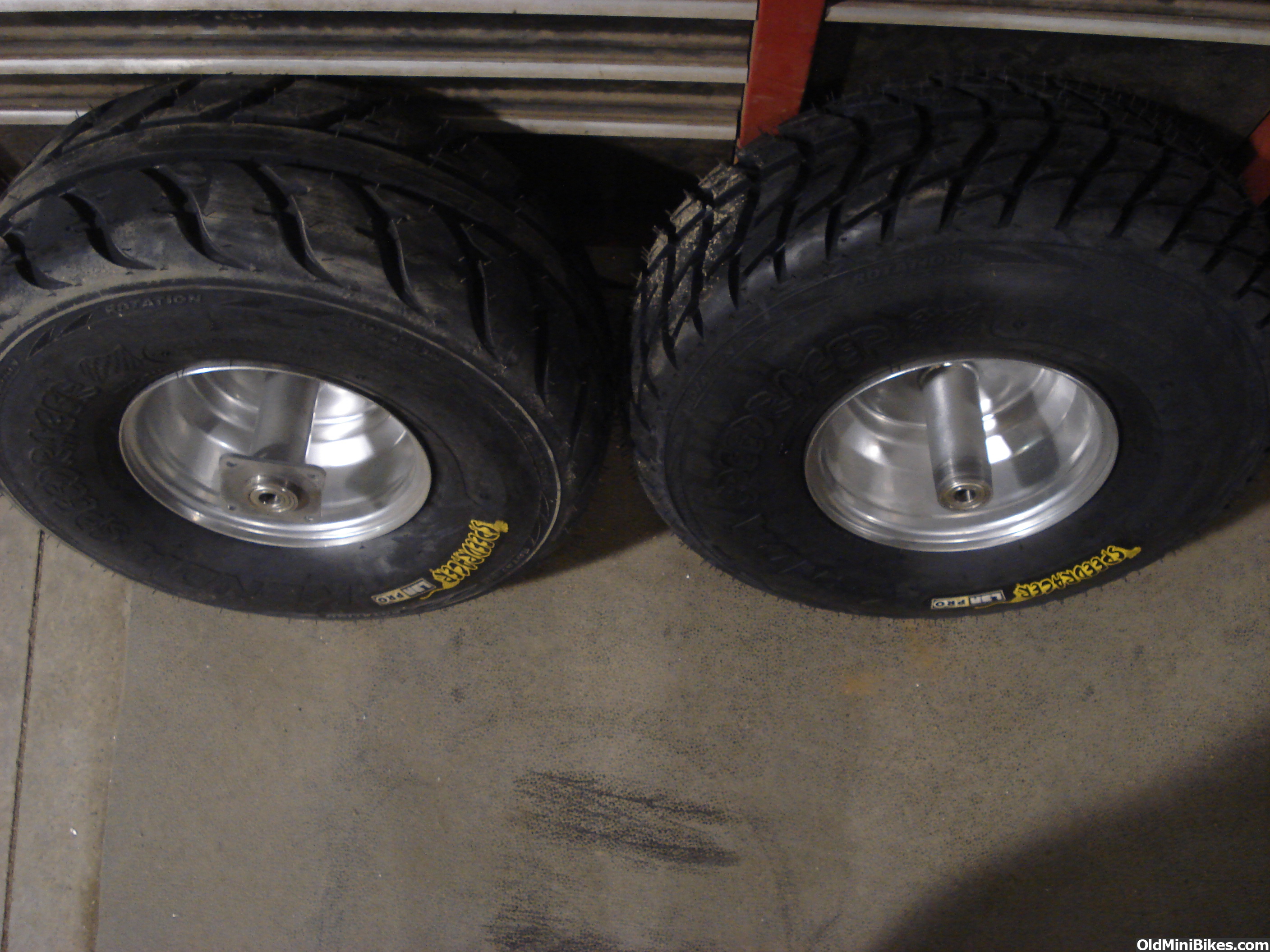

Highly recommend these tires as well as Joe. I got a pair & am very pleased with handling & ride. They wouldn't be a first choice in wet grass, but since I live in Tucson.....
