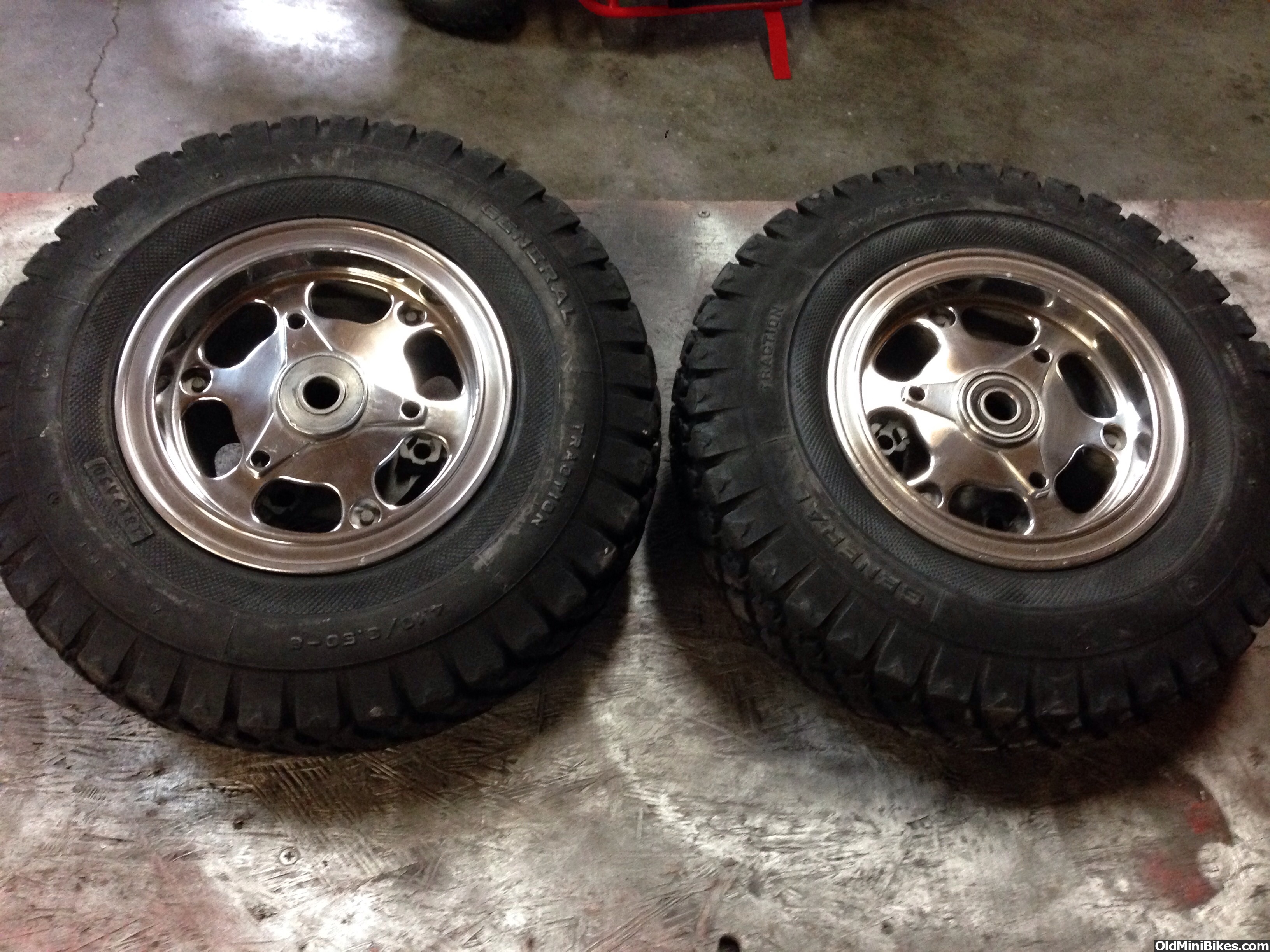

if you bead blast them and the media is not clean its gonna gray them up . you could always polish them if you have the time and patients :thumbsup: lomart wheels are some of the coolest wheels out there and one of my personal favorites

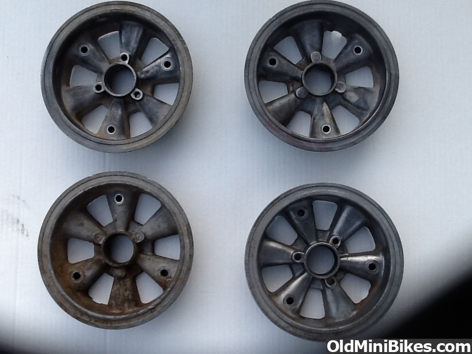

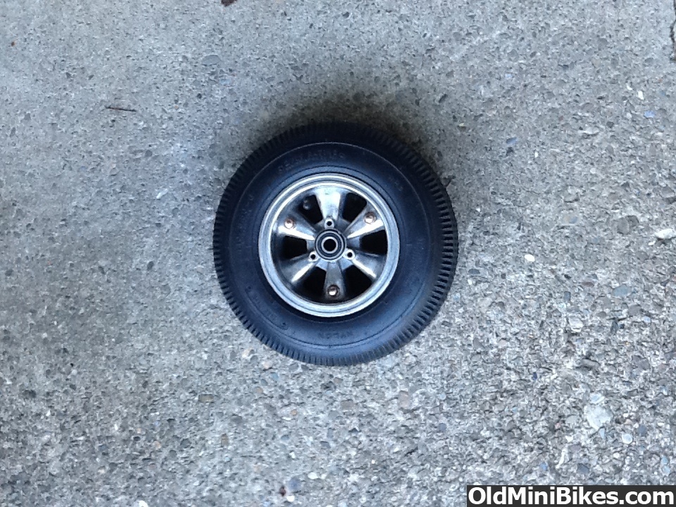

They look nice and shiny for sure! But if you want to restore them to original finish, they need to be ball burnished. Dougco in Oakland Ca. Were the original finishers for the Go Power wheel Co. Back in the day. I have over a dozen wheels there right now and will post pics soon.
