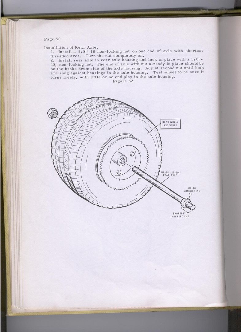

Hi everyone, Don't have a manual yet, but was wondering how does the rear wheel come off. I want to dismantel the wheel from the frame, but it looks like there are two screws that mount into the brake area that are free spining. I am not sure how the back wheel comes out. The two bolts have nuts that are attached to the frame, and since I can't get those loose, I was wondering how do you remove the wheel. Thanks
