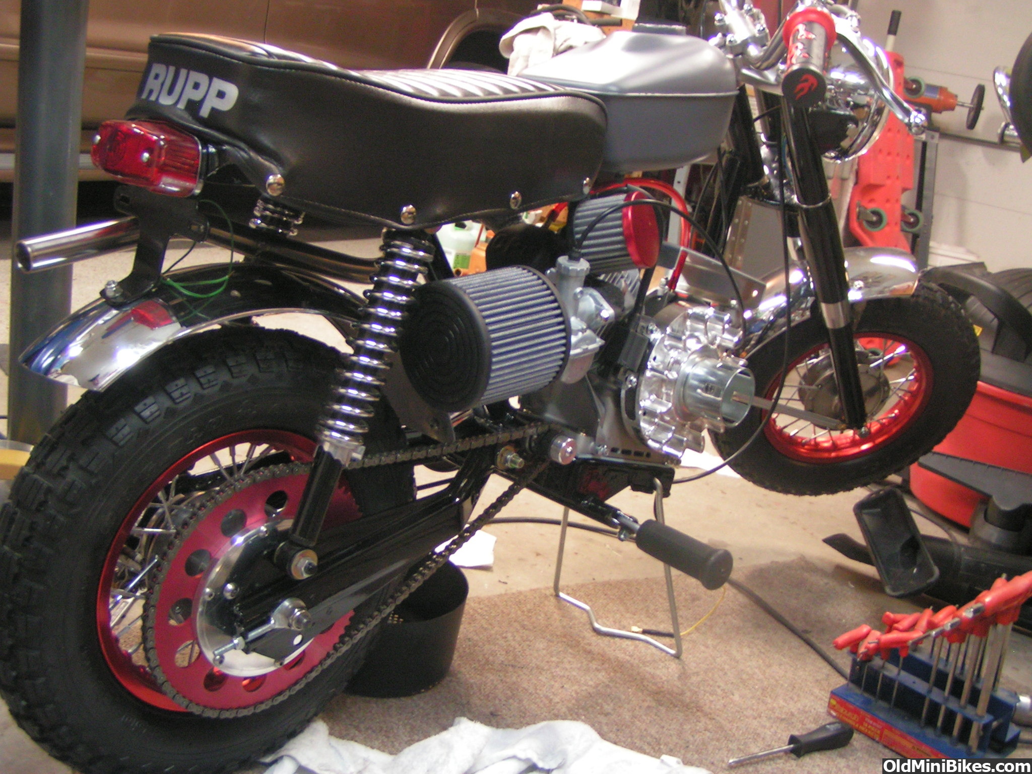

I have the same setup but on my bike it does not get in the way. Are you using the angled air cleaner to point the aircleaner back?
#3
Nice bike! Yeah they have angled rubber connector filters..even cone ones..or maybe use a piece of radiator hose. danford1
#6
On mine I have to deal with how much the Predator itself sticks out and the air filter on the right side peg.
I swapped out the OldMiniBikes filter with a shorter one I picked up at Advance. My carb is still angled, doesn't seem to mind it.

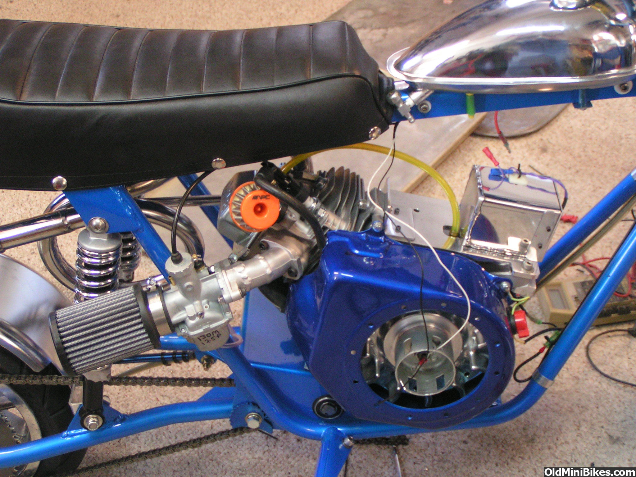

The problem is the carb linkage. If you go with a mikuni carb you can get a intake to swing back out of the way. You could always make an intake for the stock carb but wouldn't have the governor and would have to come up with a linkage for the throttle.
#11
I agree with not so mini, the linkage would be he hard part, not terribly hard, but nobody makes a kit, you would need to make your own.
The very last picture on the below link shows a clone carb with the throttle linkage, looks complicated.

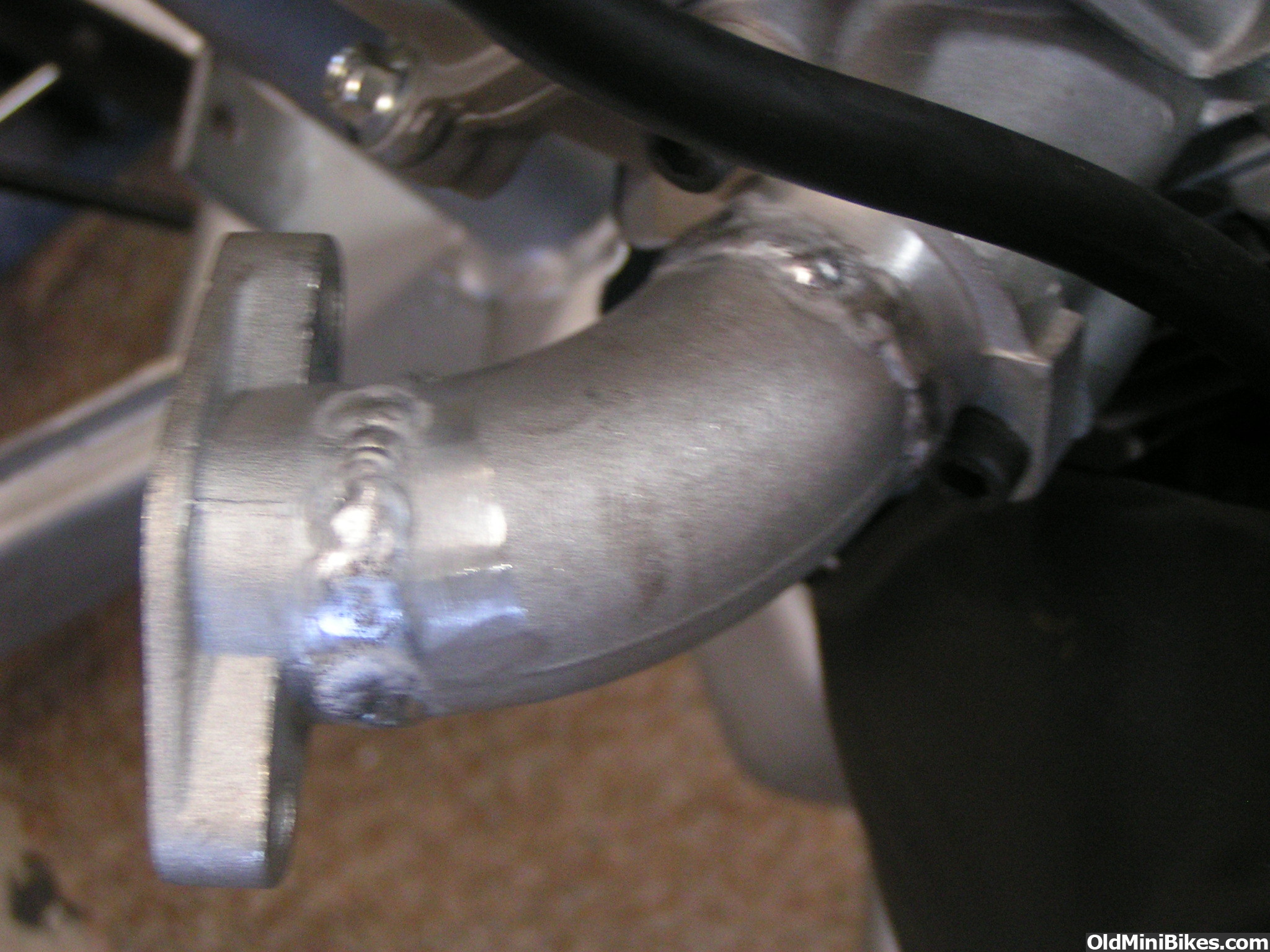

Curved Manifold
#17
You have to cut a bit out to reduce the 90 degree bend then cut the head end so you can rotate it till it sits how you want it. Then I mRk it with a sharpie then weld it.
