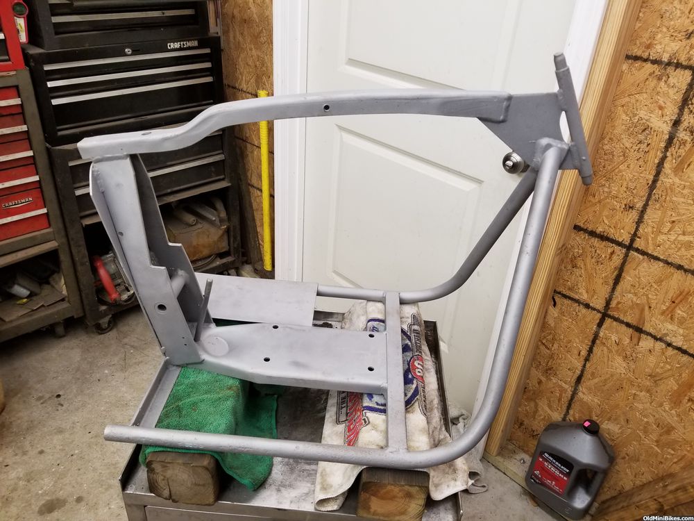

We got like 5" of rain yesterday so my sand blasted frame stayed in my truck . Decided to tear down a lightly broken in Hemi I had , it literally was close to broke down:doah:

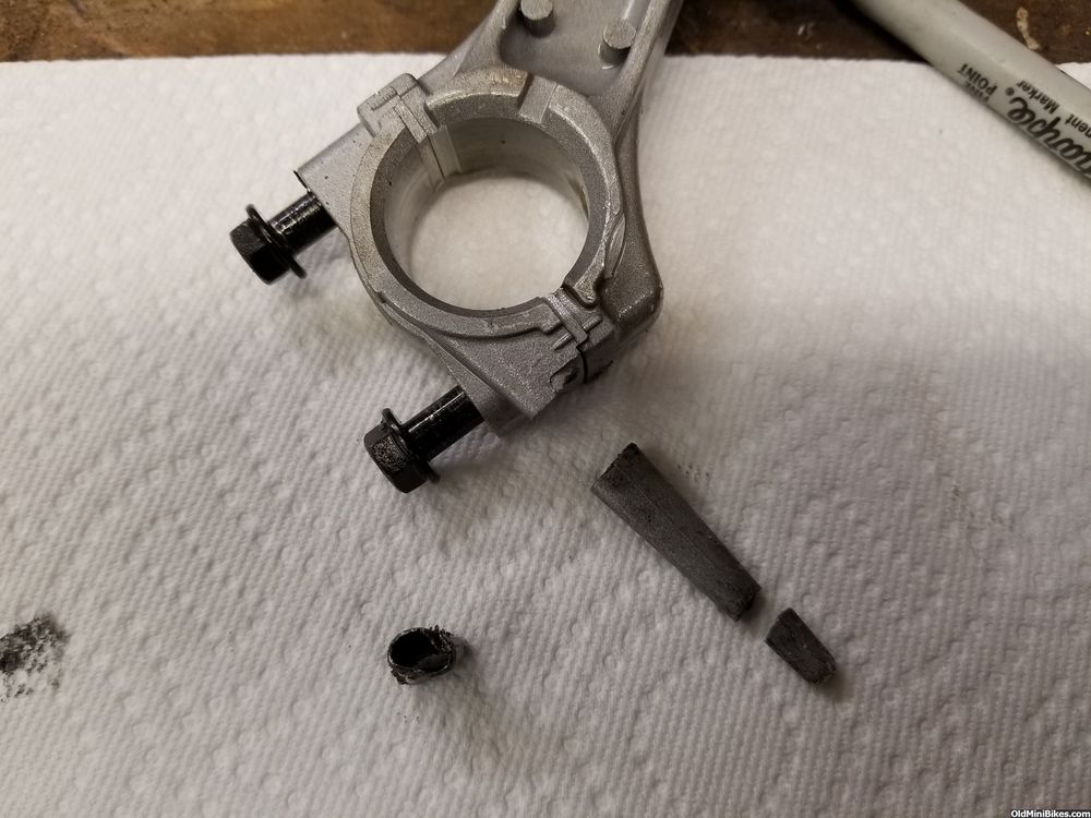

obviously during assembly little Long Wang dropped one of the side cover alignment sleeves into the block , as you see it broke the dipper clean off ! Luckily the engine only had a couple hours of run time and all is good
This Hemi has the piston .028 in the hole so 20 over rod it will get , I'll be ordering all the shiny engine parts tomorrow.
