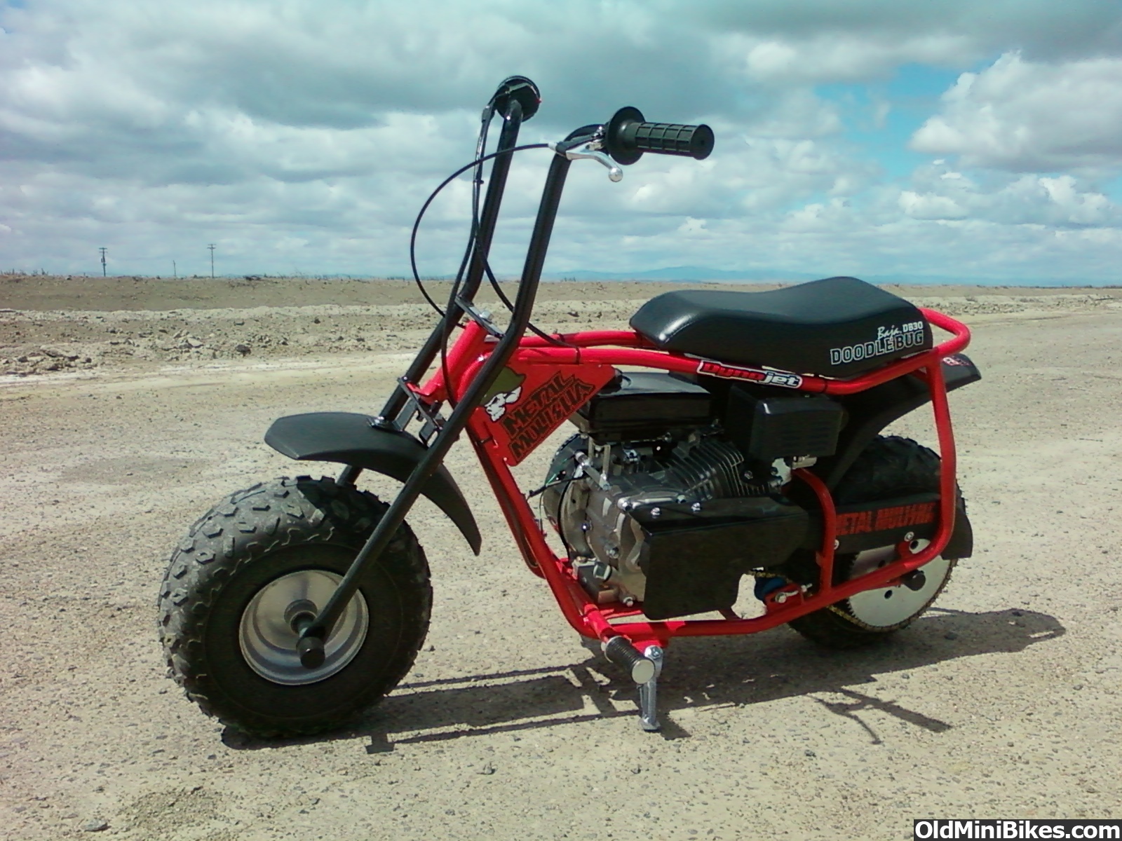

Budget build as well, used as many parts as i had laying around as possible
Had a problem with the old cylinder tank and Still need to figure out a better way to mount the old 2.8hp gas tank onto the frame, also still need to weld the bracket for the front brake and slap the brake caliper on.
Thinking about getting a clutch cover, fuel filter, muffler cause this exhaust is freakin louddd and speedo any suggestions for these?.
Not going too crazy with this mini its just for cruising, having fun not for racing or anything serious, you guys have any questions or comments let me know. Or if you guys have any suggestions on improvement, thx.
Gearing is 12/59 goes around 40-45mph and pulls hard :thumbsup:
