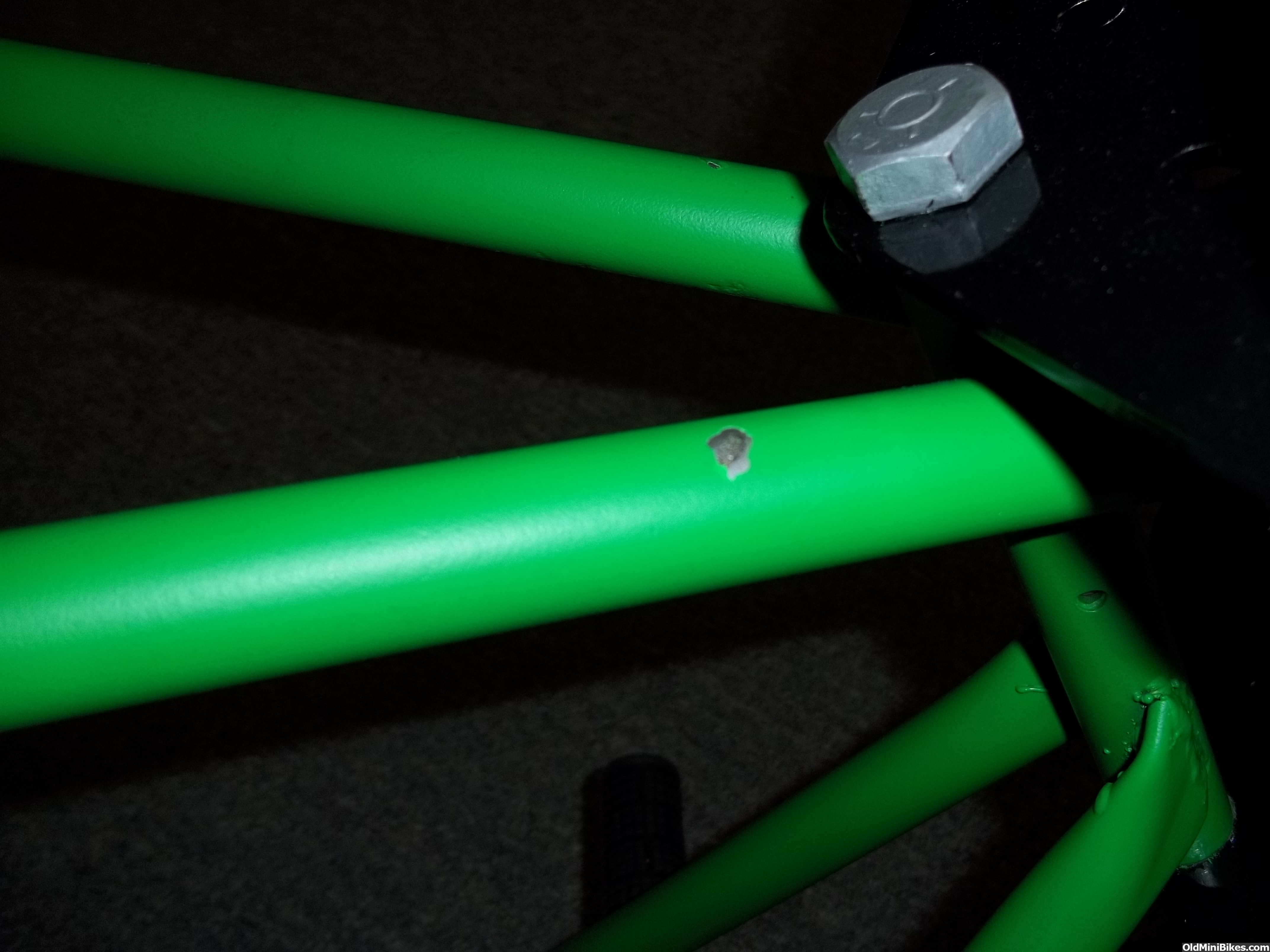

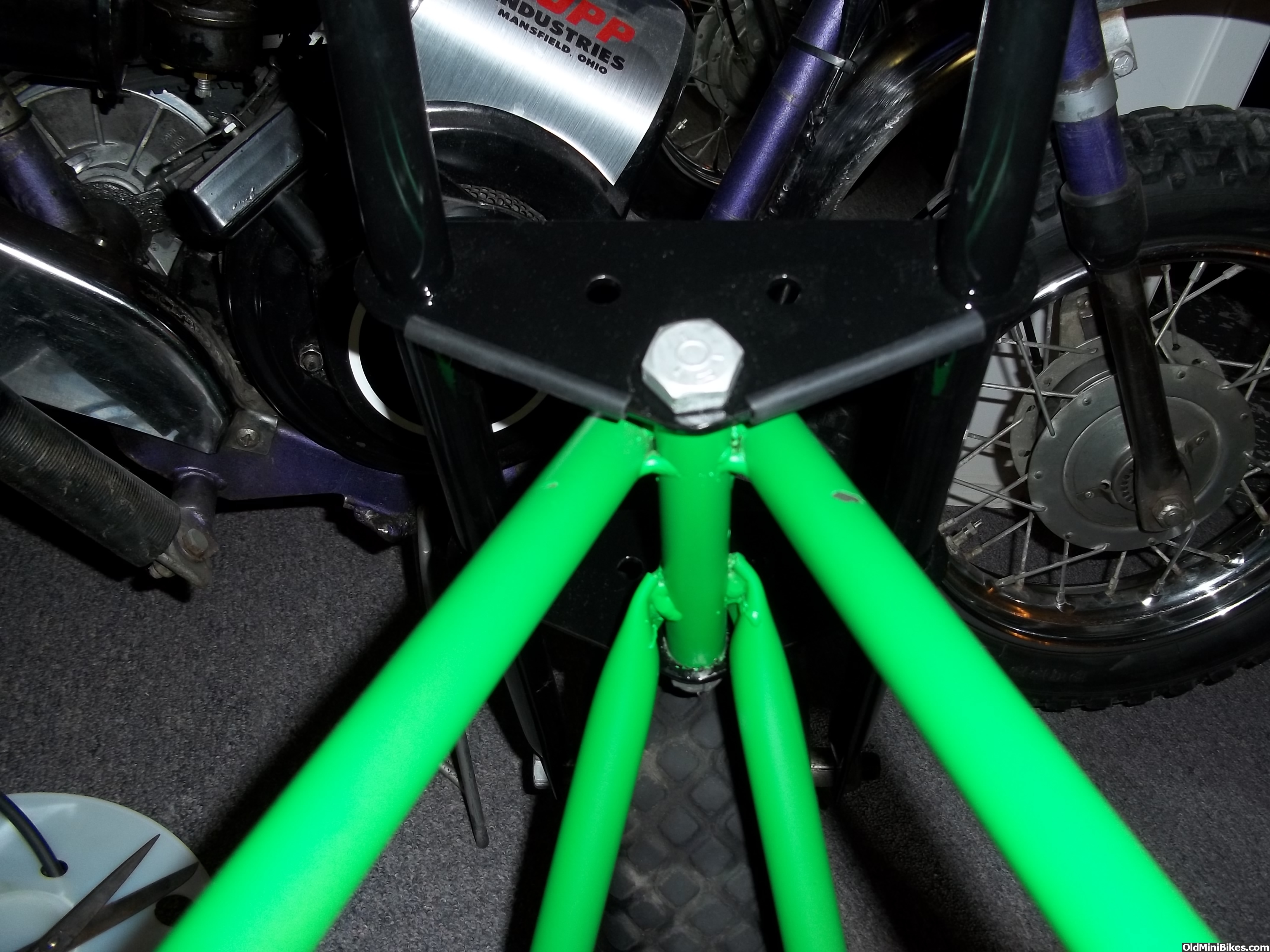

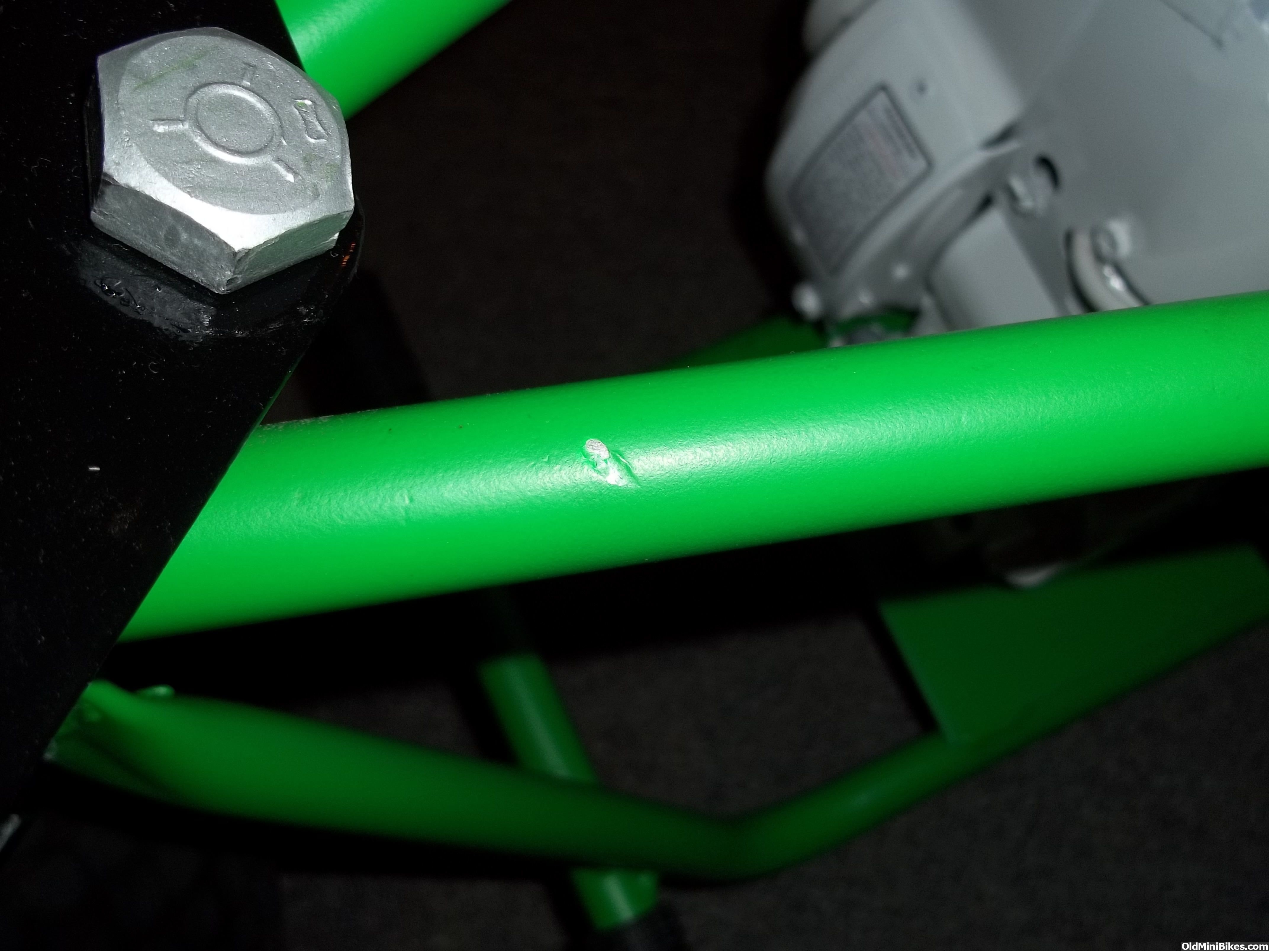

Clear electrical tape works for like where kickstands touch the frame when up and even wrapping around the tubing where the forks meet as well, Just gotta use clean rubber gloves or not touch the sticky side or that will show
dunno if you can see the little square there or not:
The clear tubing is a little bulky but its safe for a manchild such as myself, Yes they look like Stevie Wonder cut them, they are just chunks I cut and have at the ready to stick on the tubing in spots when I build (these bikes are both still just rollers). I'm so used to them being on the bike that I think I may just make "nicely" cut ones with just a dab of clear silicone so they wont move/slide when the bike is in use.
