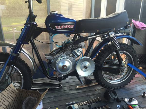

Hi,Will a Predator run correctly if mounted on an angle like in a Rupp or an MTD? Will the carb or exhaust need to be modified? Thanks
Barely clears on a T-Bird, but carb doesn't seem to mind the angle. And like said if you go aftermarket on the exhaust it takes some work.
I took the OldMiniBikes header for the flat mount set up, cut it into pieces and welded it back together to get the right angles to fit the under the seat and over the fender.
