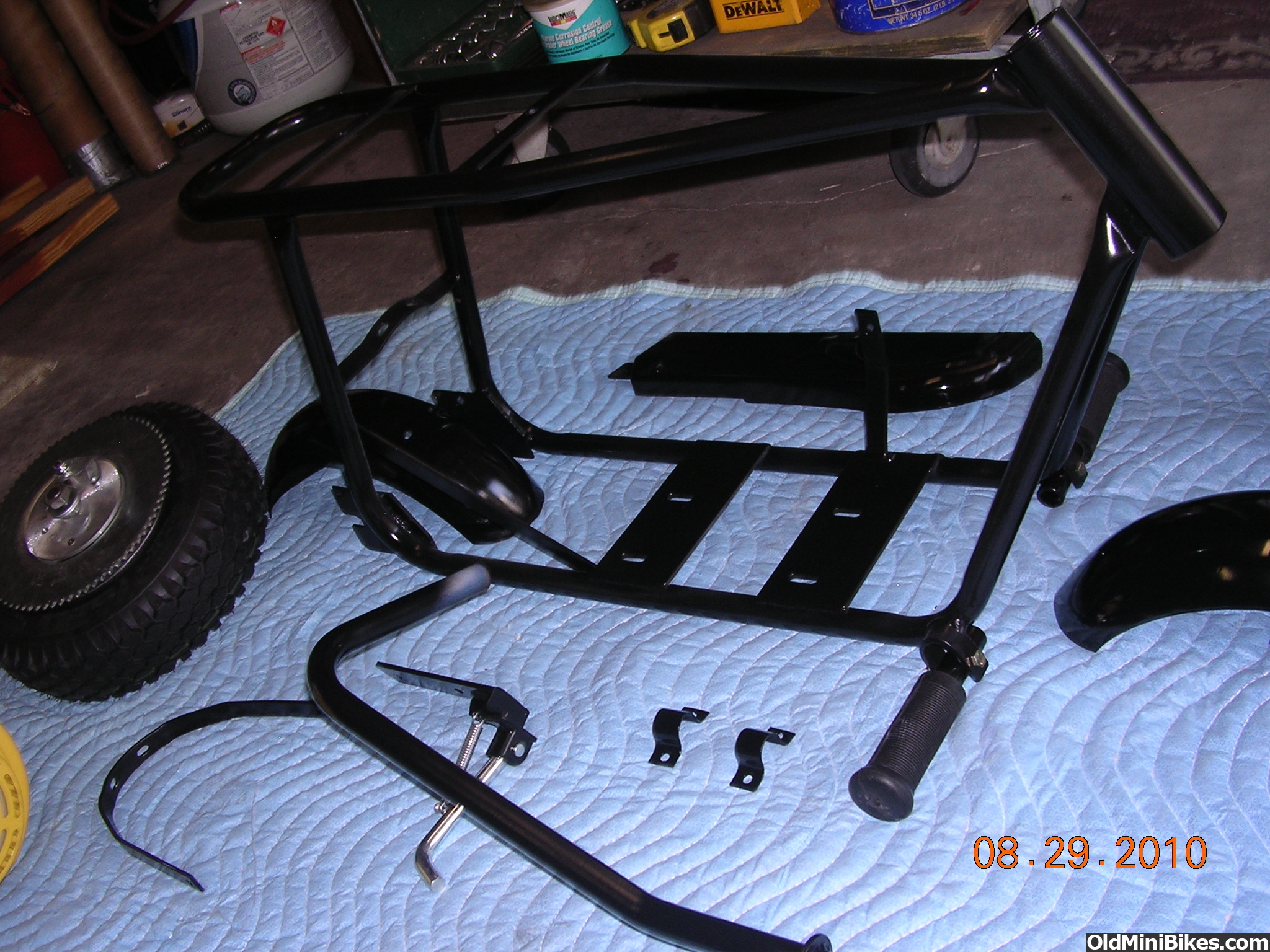

Ok, so I bought this kickstand from OldMiniBikes and I'll be dang if I can figure out how to mount it.:shrug: Do I use a clamp?:eek:ut: If anybody has a photo of this on there mini, I would love a photo:thumbsup: Sometimes I think I am border line retart:lol::lol: Thanks guys
Oh, Thanks Bill. :thumbsup:. Not sure I want to do that. I don't want to alter the frame. Its for my Indian Sabre. There is this extra hole in the motor plate and I'm not sure its suppose to be there, or thats where the kick stand goes. :shrug::shrug: I searched photos and can't seem to see the kickstand.:confused:
The original 'if it had one, some did not' was held on with just one engine bolt. Some of the newer ones used the left front engine bolt and then a 1/4" carriage bolt also.

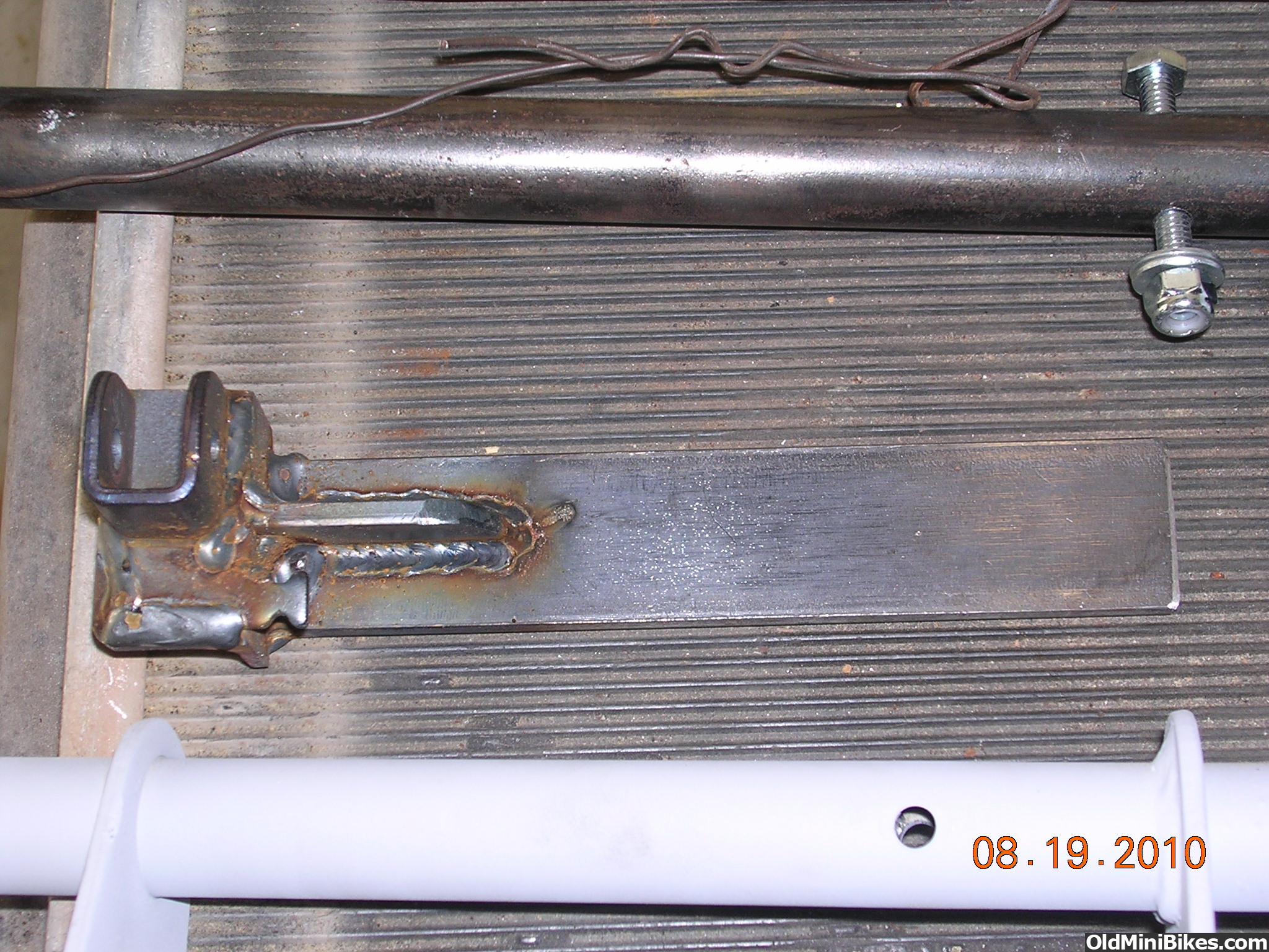

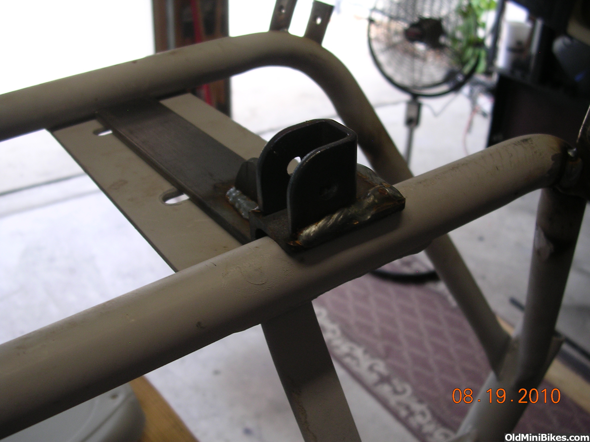

here are three pictures that show how I made a bolt on bracket from angle and flat iron to bolt on an OldMiniBikes kickstand. works great and is not welded to the frame.
