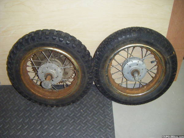

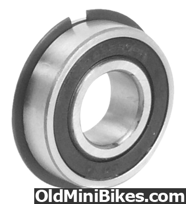

Hi Rod burner, If I am not mistaken, The 70 model wheel uses a inner sleeve to keep the correct bearing spacing in the hub. Then the bearings use the clips to keep the bearings from moving in or out of the hub. So yes you will need to have those clips in place. If you dont and they move you will have chain alignment problems and wheels rubbing on the swing arm ect....When you bought those bearings, they should have come with those clips! I would call Jim Kise at blackwidow tell him they were missing and have him send them too you. On a second note I would try to find a steel spacer for the axle, your local hardware store should have them, (I have bought them at ACE in the past) and then cut it to the proper length. When you tighten the wheel the pvc might not hold up, and the bearing will move. Good luck, let us know how your progress is coming
