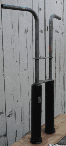

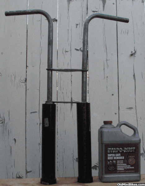

I came up with this idea for removing rust from the lower section of this Bonanza MB 1210 front fork which are rusted to the point of not being able to remove the lower spring section.
It works by placing the front forks into the 1 1/2 PVC and letting them soak in a rust removal solution. :thumbsup:
There still soaking so I will post the results in a few days.
