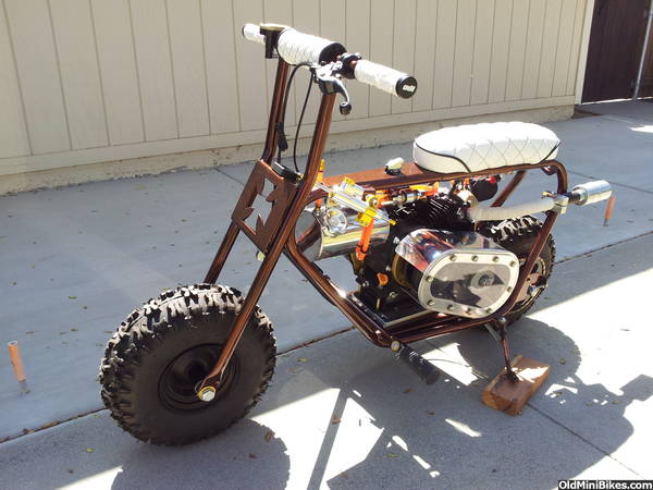

Ridding my Baja doodle bug with predictor hemi motor . It's kinda more shaky on front. Like to add a steering dampener to the system. I saw one doodle red with steering dampener but that guy would no pm me.

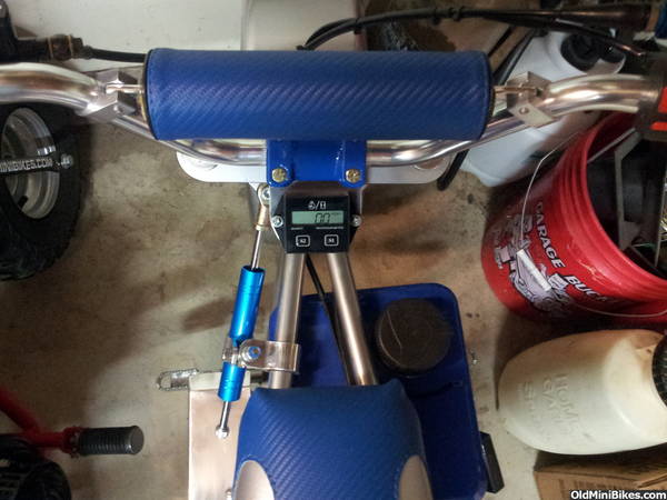

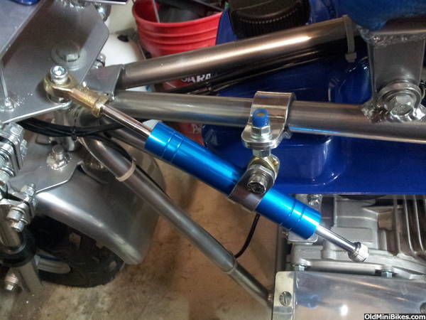

I did use a gsxr damper on my DB trike with good results and got it off ebay for $12

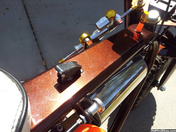

Wow nice stuff guys pretty slick dampeners.

Appreicate all the sweet pic guys.
