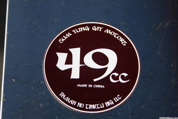

I can make you a recoil sticker that says 49cc for it! Nice and PROfessional like!
Made one for Cheezy that says 22.88HP! I turned a 5HP Briggs in to 15HP Briggs with just a sticker
I have only been able to find a few 49cc stickers from my research what do yours look like?
