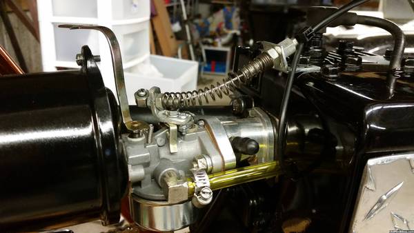

been done a ton...at my house alone! Tec carbs use the same mounting pattern as the Tillotson carbs. Use a billet manifold or the oEM piece listed. Here is the OEM manifold mounted
