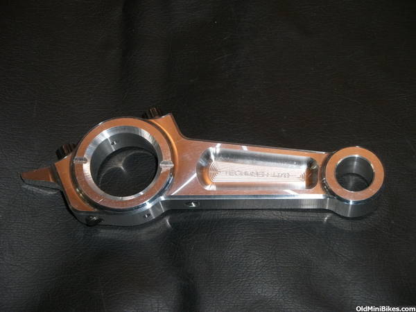

I have a new billet rod for an H70 sitting in my tool box. A member made them a couple years ago.

Yeah the H70 Billet rod was a limited production run that some guy decided to invest in.
I think only 25 or less were actually made & he had people pay pre-orders before making them.
I was lucky enough to receive one to inspect and take pictures of before sending to the original buyer, my friend in Canada.
There wasn't any mention of test runs or revisions, so I don't know how much time was spent on R&D.
