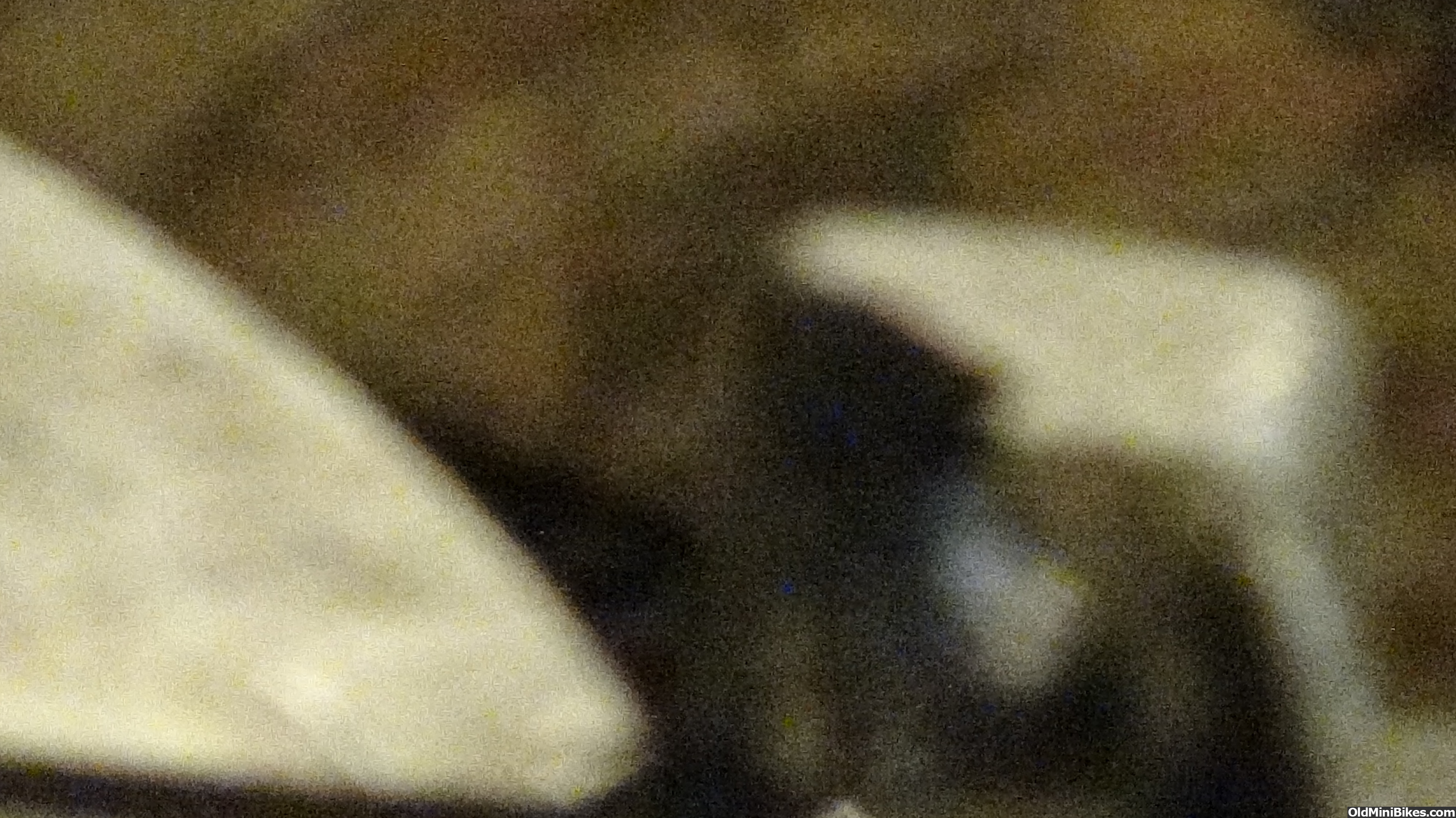

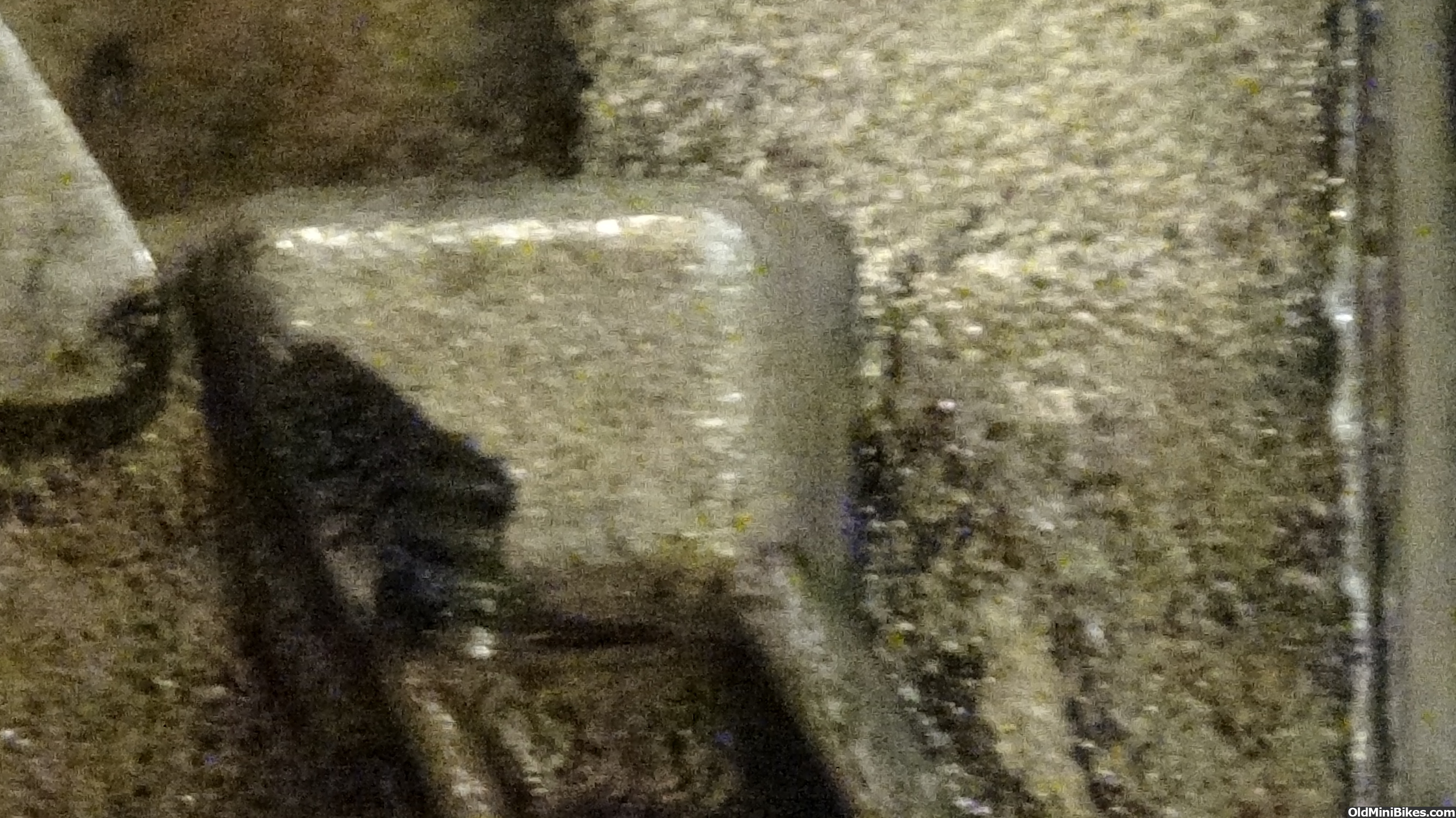

I was all set to get the Manco Briggs 5 HP engine running today.
How ever a new issue turned up, the bottom anchor bolt holes won't hold tight.
I wonder if my brothers friends stripped out the threads on the left anchor hole?
When I removed the flywheel, I found that the right anchor hole had a blowout in the casting.
I doubt a heli coil will work here.
So back to my brothers shop to see it he can correct this issue.
I hope he doesn't take long to do the work.
I am wondering if I can used JB Weld and a couple of T Nuts (used to anchor mini bike seats.) would do for this repair?
