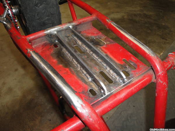

Your engine plate flex is why the vibration is amplified but I didn't say that. One member now banned rode me like a rented mule about my theory but just take a step back and look how it's barely perched. I'm gusseting mine if I ever tear it down for paint and curing the problem, I'll gusset the middle outside and bridge the factory tube joint strengthening it all at once. I have three here me and the kids and none stock, the little engines shook like a junkie needing dope due to the plate flex and struggling to pull the thing and they run smooth if they run at all. I deduced that the plate was just improperly mounted on the cheap. Maybe I am wrong but I'm convinced.

The motor is Mounted to the thin factory plate only. My son is in welding class at school. Should he weld a thicker plate to it,, or reinforce the factory plate??

Reinforcing the plate is a sound additive-if you are looking to isolate the motor by rubber bushings you need to create a top end of the motor to frame mounting that is also rubber bushed so as to restirct the motor's top end movement---remember that the motor needs to move for and aft (chain adjustments) so your top mount will have to adjust as well. Four on the bottom and one on top will hold the motor inplace, with a re-inforced plate and bushings that would be a proper isolation job. Should be as smooth as silk on good pavement.
