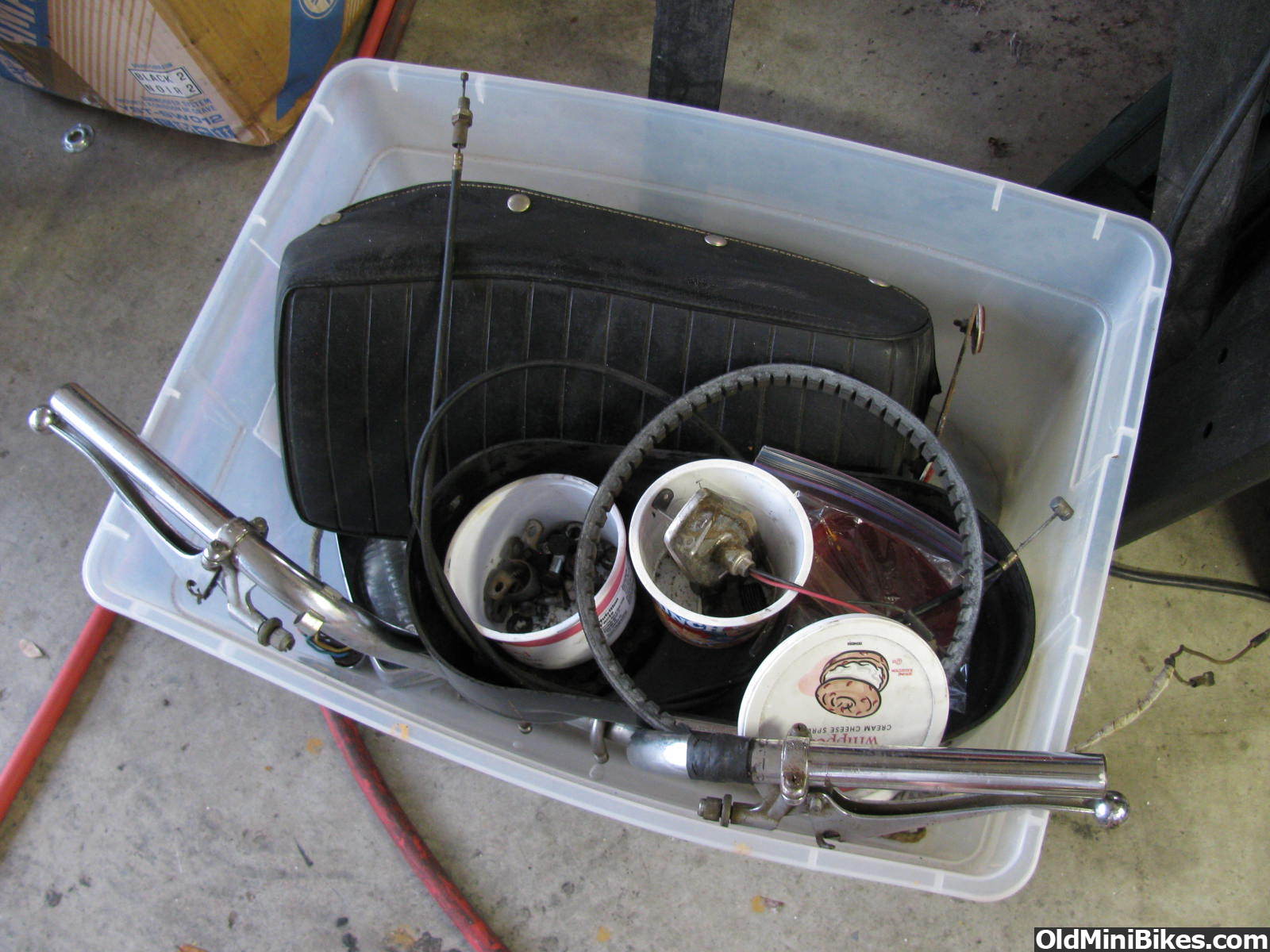

Rest of it is all here in the box:

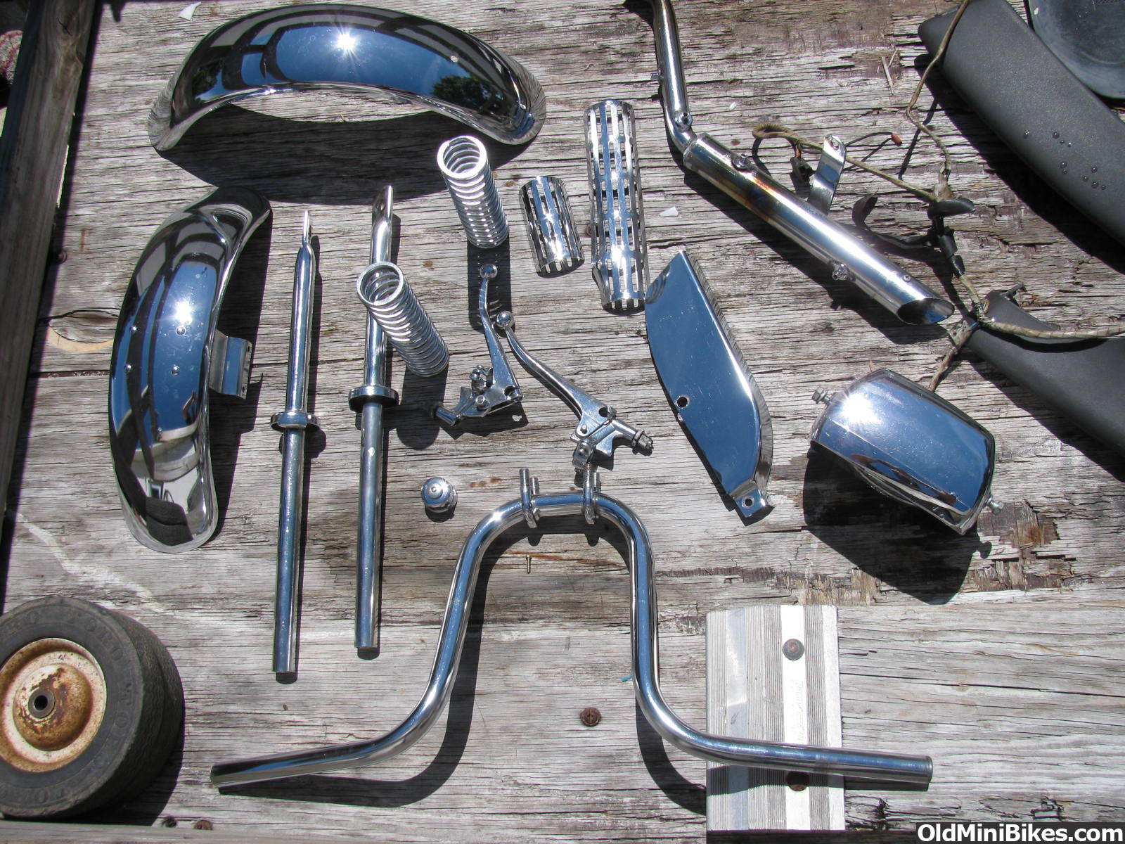

Most of the chrome is near perfect, I soaked most of this stuff for a few hours and then a little steel wool cleaning and everything came out really nice! the shocks and wheel bands for some reason did not fare so well, there is peeling and pitting on them unfortunately, but I will get them shined up as best I can.
drying in the sun:

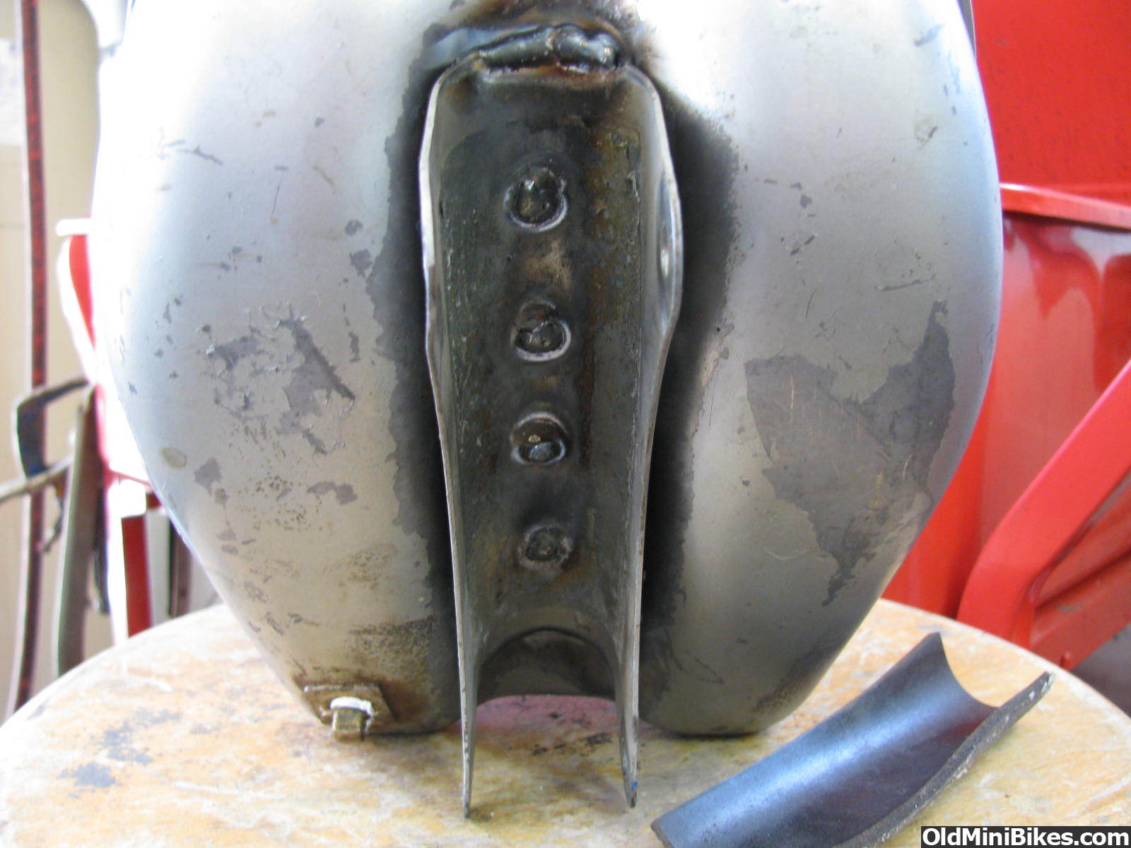

Some issues with the bike were that someone had broken the mount from the tank, and then tried to fix it with JB weld. Not to mention that the tank itself felt an easy 3 LBS heavier than it should because of the molasses/carmel/rust mess inside. so for the last few days I had filled it with rust911 (I use it instead of evaporust) it broke alot of it free, but it was still pretty messy inside. Yesterday I used some POR15 prep clean in it along with some drywall screws and shock it around here and there throughout the day. its pretty dam close to spotless inside now:thumbsup:
I also cleaned off all the JB weld and used the pre-existing holes that are drilled in the mount to weld it back to the tank, I shot quick bead on the front edge as well:
I filled it with some of my parts washer solution and am leak testing so far its been about 2 hours and its dry so hopefully its all good to use:thumbsup:

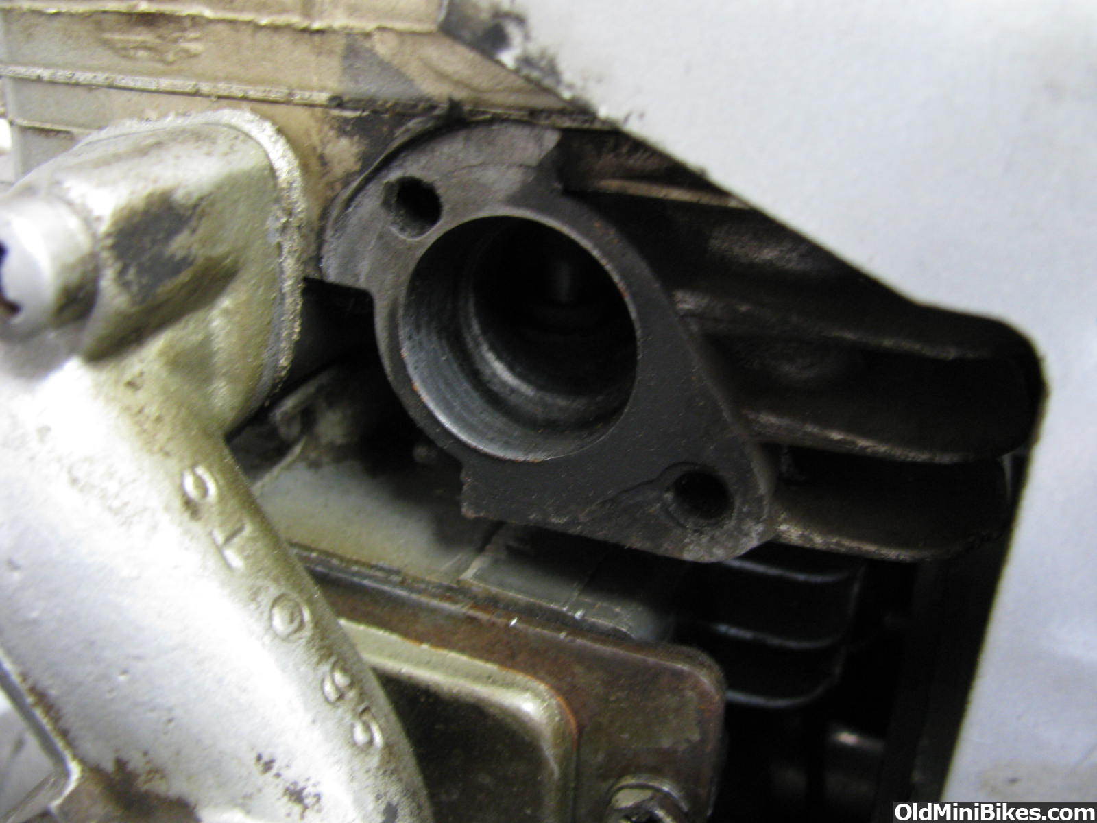

This was another interesting thing I have never run across, I think the pipe got jammed or something through the years, it managed to I guess put pressure on the screw in header/outlet and it literally ate the threads right out of the block:doah: Luckily the threaded holes are still good, so i am just going to clean up that area and install a blackwidow style header/outlet that I had in my stash. it does fit tight where it slips in the original pipe though so I gotta do a little thinning on both pieces I think.
