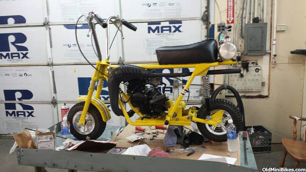

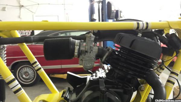

Working on the throttle cable, I need a 90 degree bend where it goes into the carb. A motorcycle shop a few doors down hooked me up with that.:thumbsup:I think I have a cable kit somewhere.

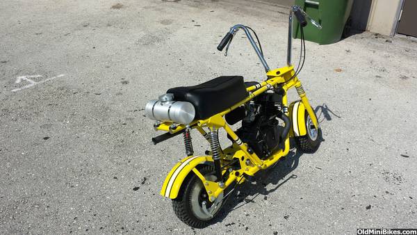

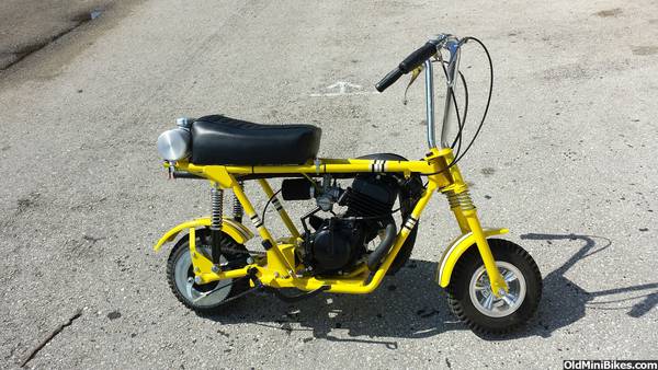

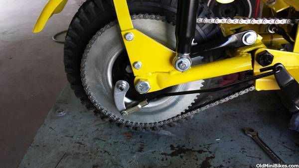

Took it out and gave it a shakedown, found a couple of issues , carb is off a bit , from me redesigning the exhaust pipe. I should be able to adjust it out. The jackshaft box moves when I hit the power band causing the chain to loosen ,I will try some different lock washers, may have to drill a couple more holes for some more bolts. The pedal ratio is off on the rear brake. Good news is I got the math correct on the sprockets,and the brakes work much better than I expected.
