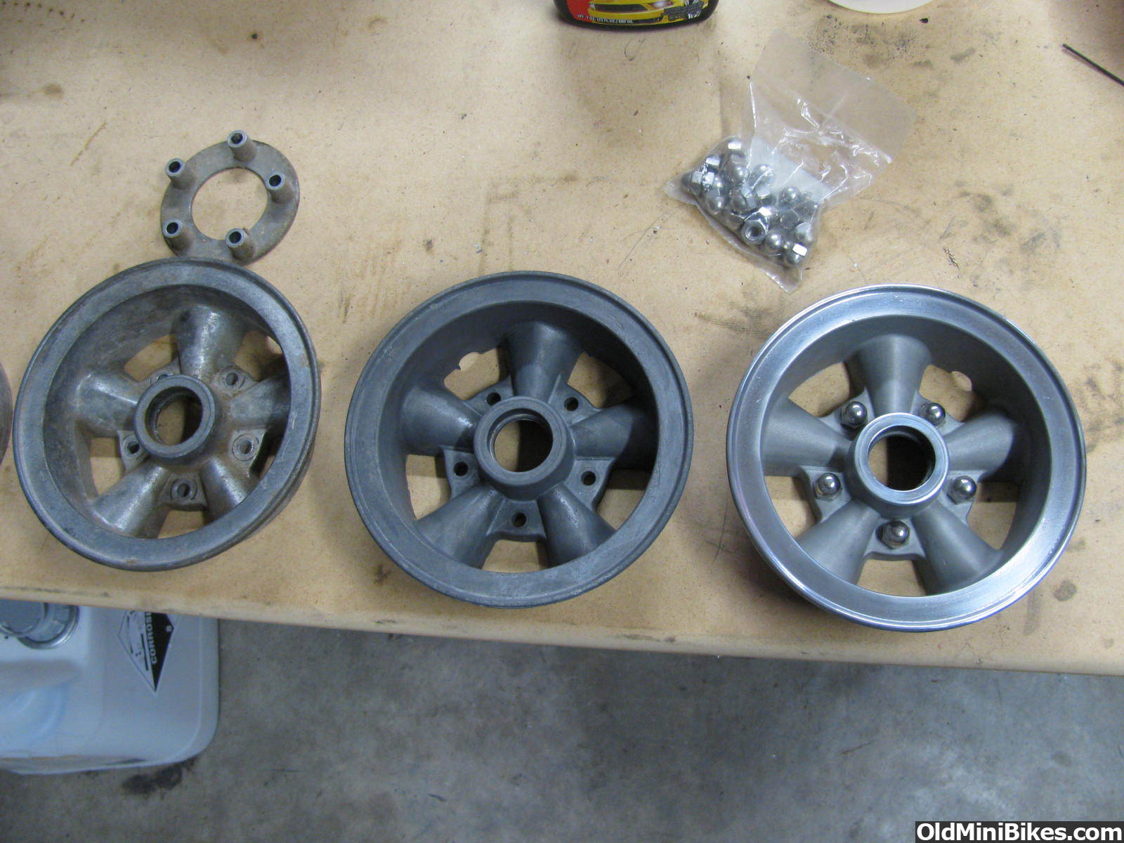

going at a snails pace.... I have been needing to detail the wheels out of for this bike. I want to keep an old look to them but they gotta be clean and uniform. These Tablocs like to stain/discolor so I was trying a few different things.
These are actually the wheelset from My George Barris super stocker but they are the same wheels as whats on the bike, they were already loose in a box and they need cleaned anyway.

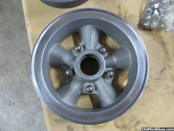

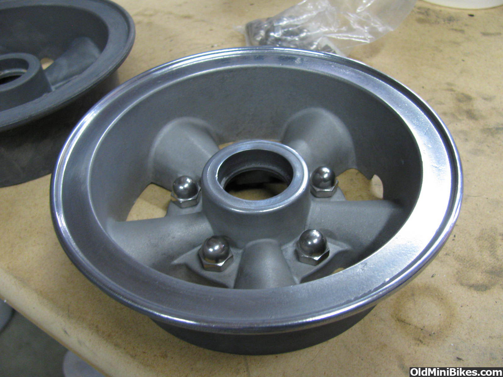

Left is pretty much what I am starting with, I tried a light media blast from this but discolorations were still pretty noticable. Center one is after a VERY SHORT soak in some industrial degreaser. This stuff will eat aluminum, they start foaming and as you can see after washing them off they come out looking almost black. right is going to be the final outcome...most likely. light media, lightly polished up lip and center, liquid wax soak and scrub on the raw center.
the wheels have to look good, but I don't want them to look new. They are already easily mistaken for Astro wheels and I want to avoid that. I like the way they are turning out, except this is basically the same thing I did with my Mickey bike wheels so that kinda sucks but I just cant think of anything else so I am gonna just roll with it.
