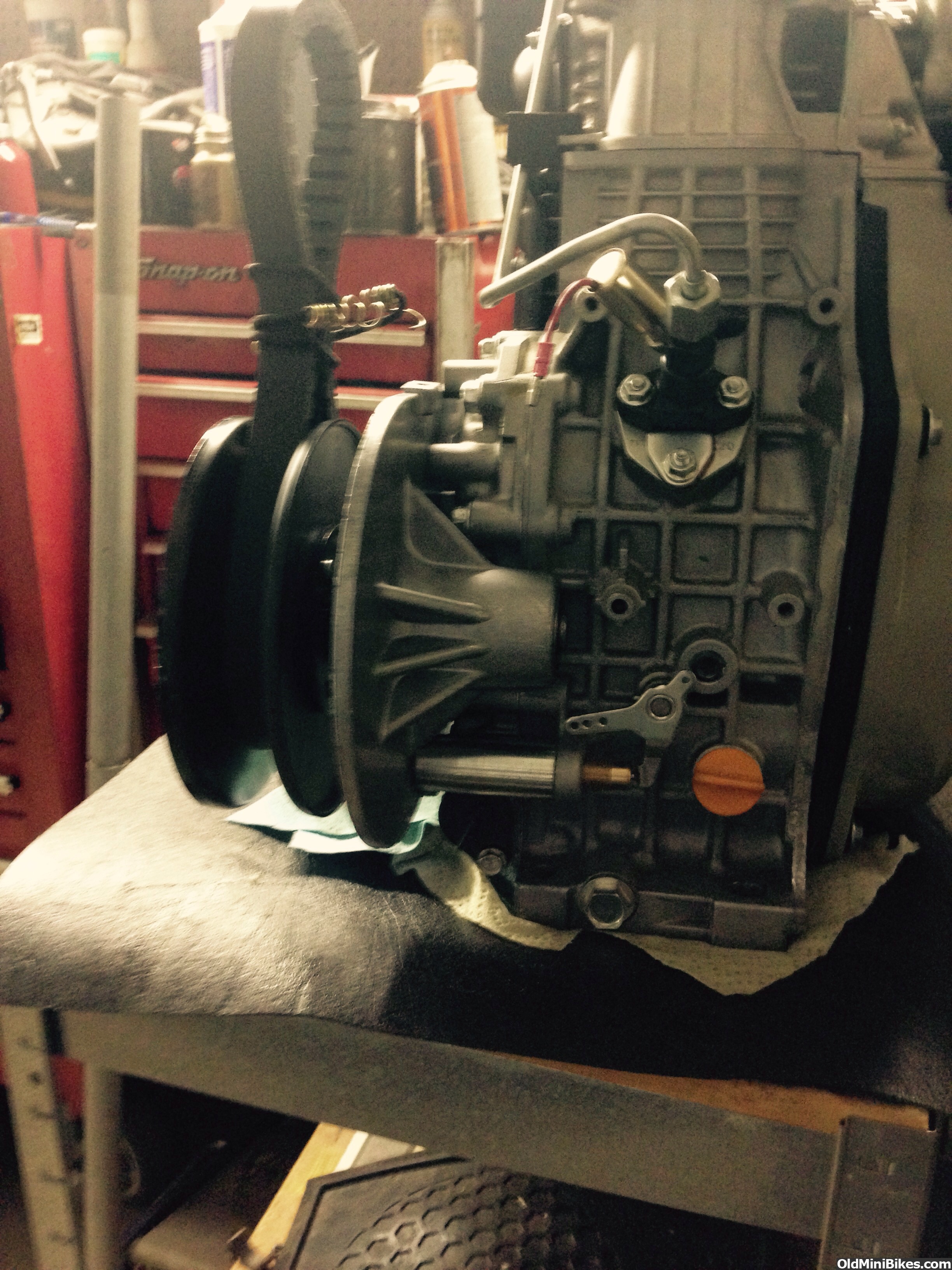

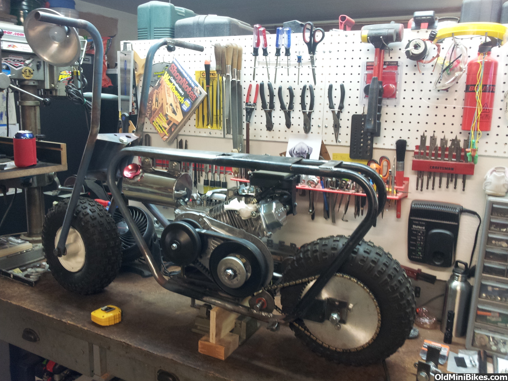

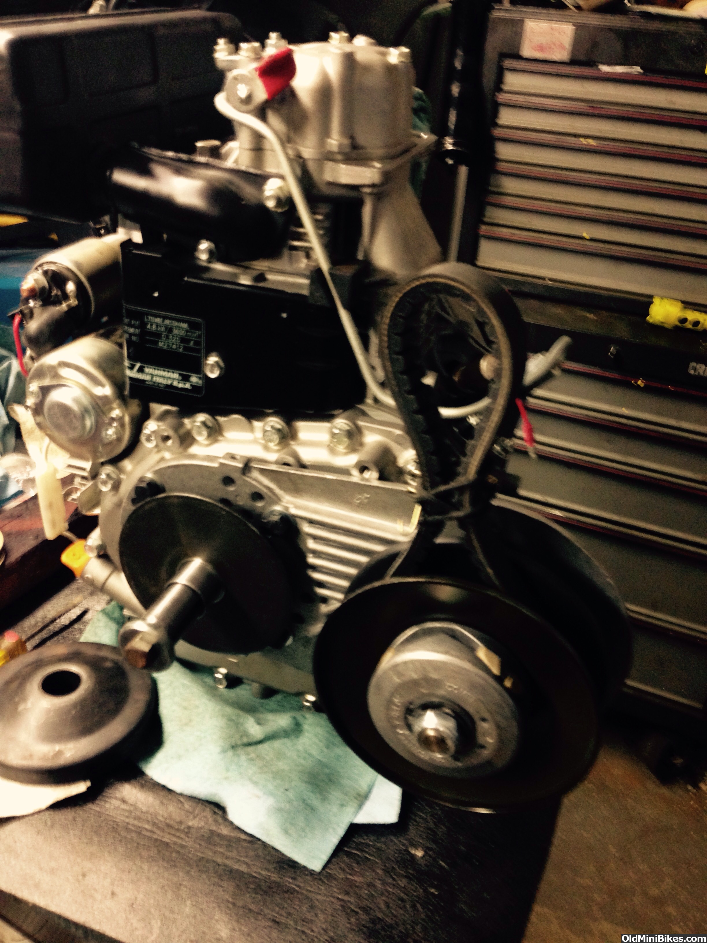

The Comet 30 uses a belt where the flat side goes towards the motor so if you flip the driven and not the driver I think your belt angle would be wrong on the driven unless you flipped the driver and driven together but you would also have to keep the same driver/driven offset as it was originally.
#3
Jackshaft would be the way to go! You could run the driven to the outside of the jackshaft but would need to cover it for safety reasons! :thumbsup:
