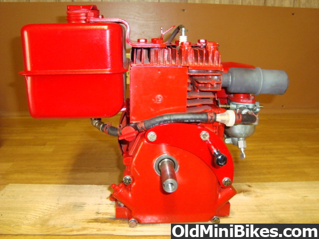

I think you will need to drill out the threads and use a longer bolt going through that piece. Be real tough to get the threads to match up! They all should be 5/16-24
I am buying a 3/4" keyed jackshaft from OldMiniBikes warehouse..taking to a machine shop.cutting to size..coring the center through for the 5/16 x24 and extending the shaft that way for a tav. The driver of the tav will be placed over the seam and locking it together with the permanent tav key.. hope it works.. lol
