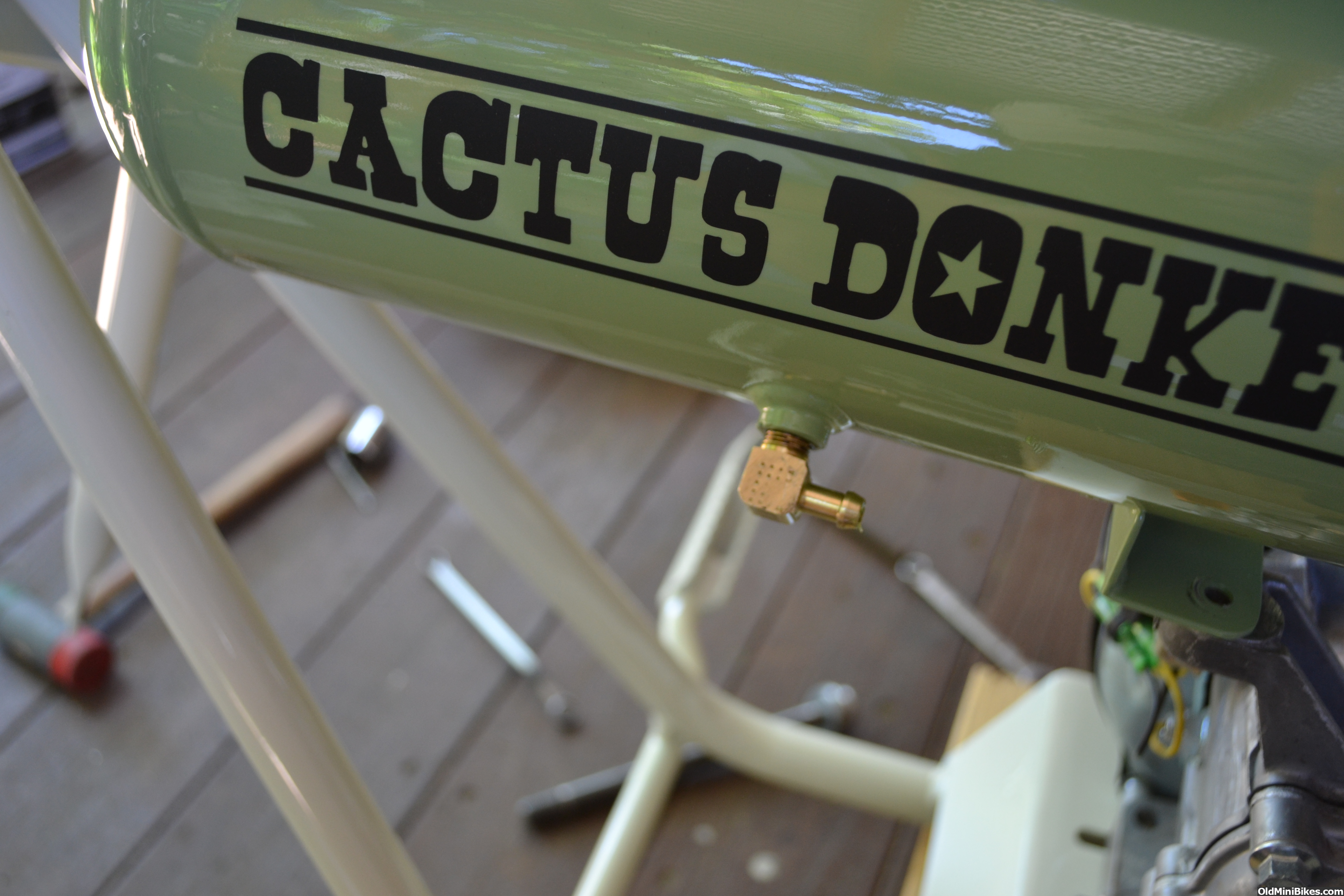

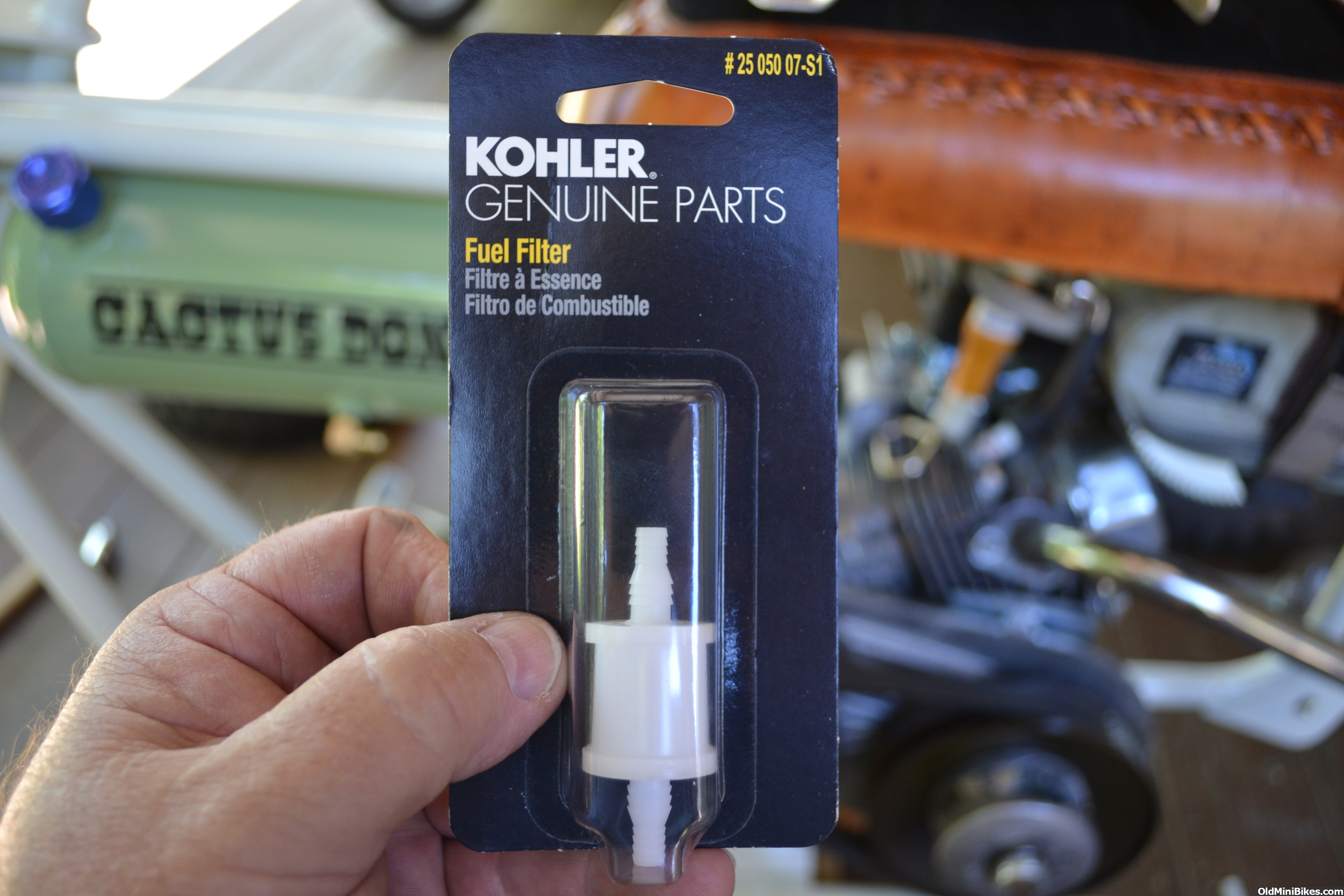

Got my fuel lines and filter figured out. OND (Eric) sent me some 90 degree fittings. MikeZ and CarPlayLB suggested this fuel filter that has both 1/4 and 3/16th barbs on it. There is the part number. I found it at Tractor Supply.
I used an existing bung and tapped it with a 1/8 npt thread.

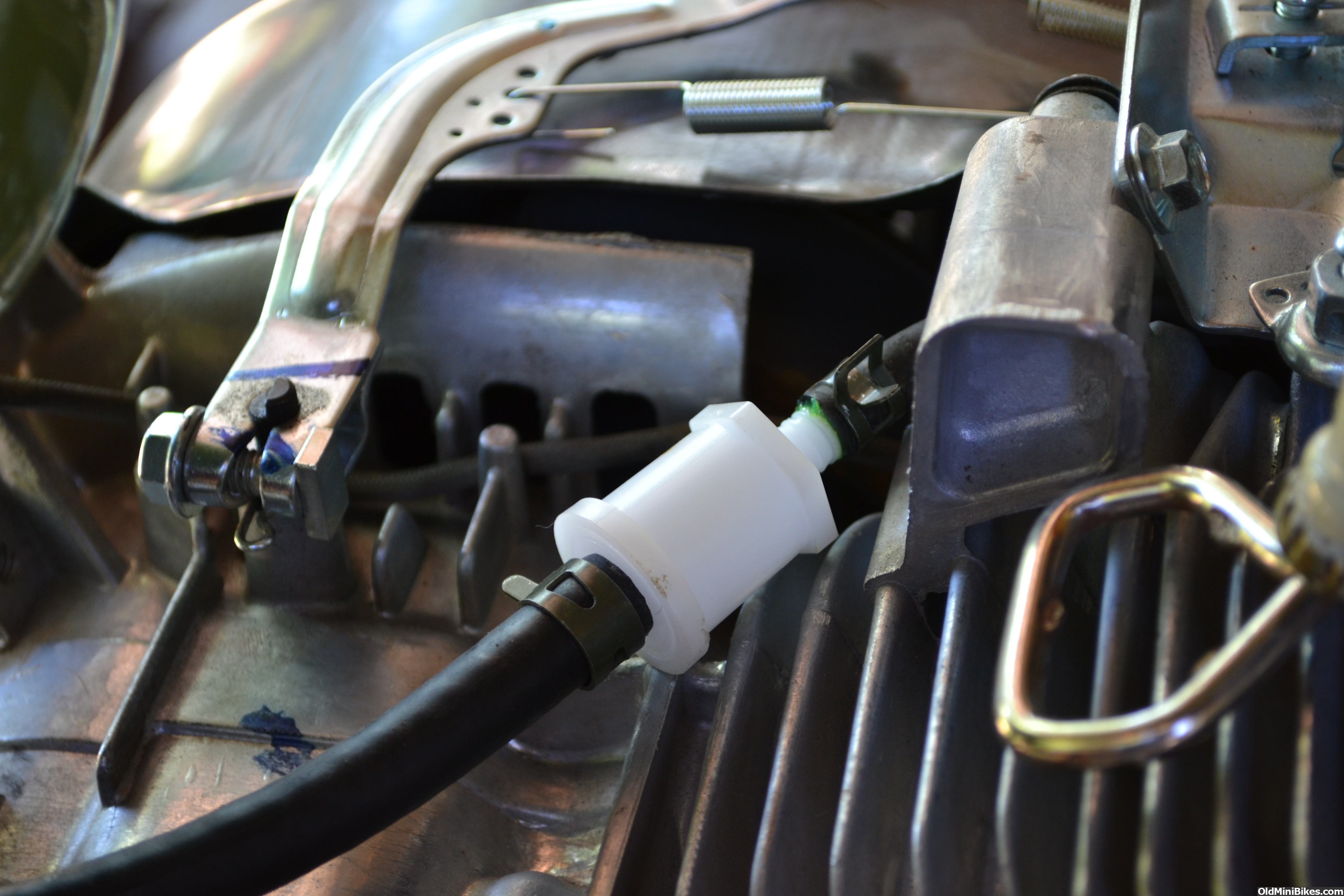

Here is the filter used with both size fuel lines.

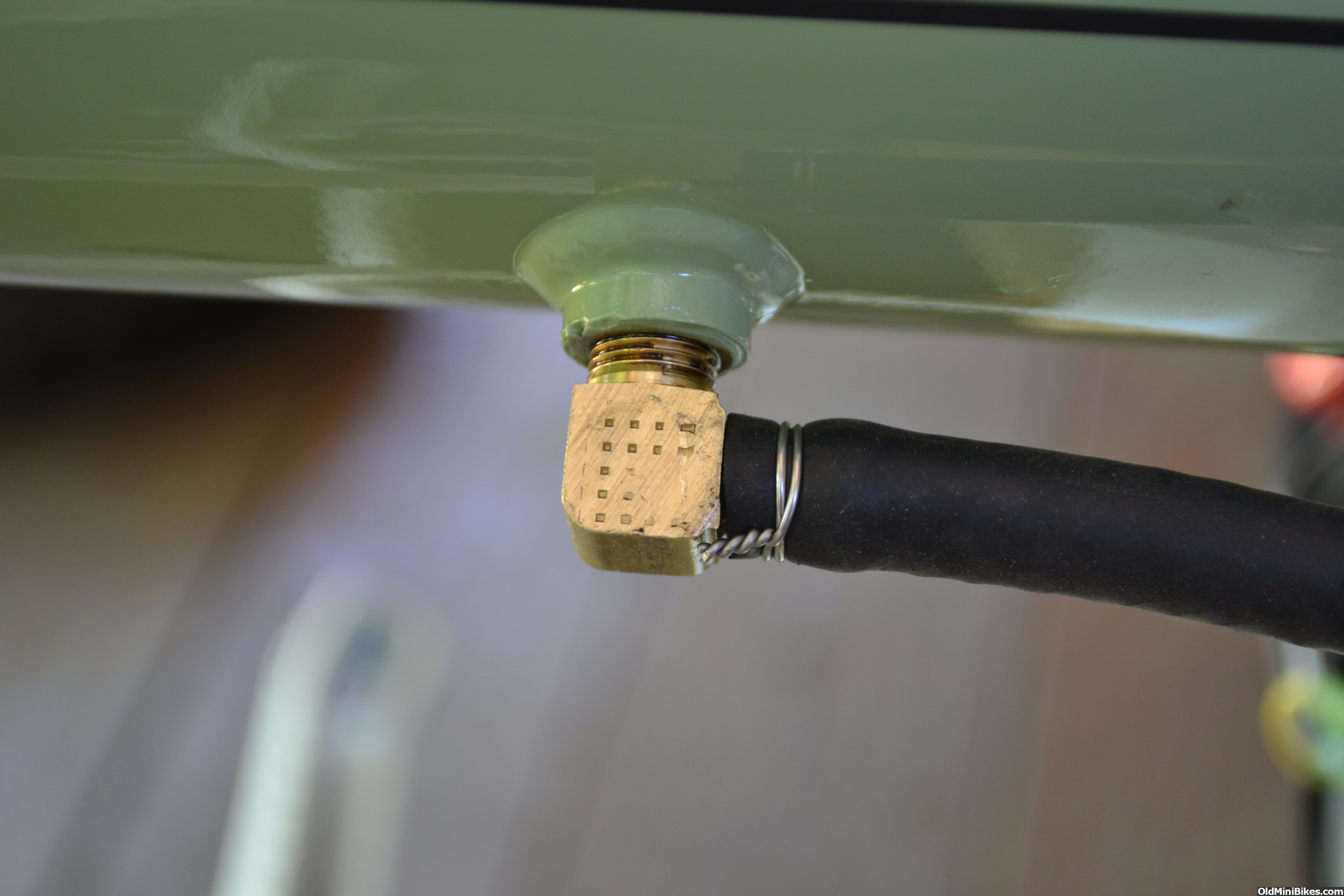

Safety wire clamp. I had to use safety wire somewhere, it makes stuff look fast and racy.

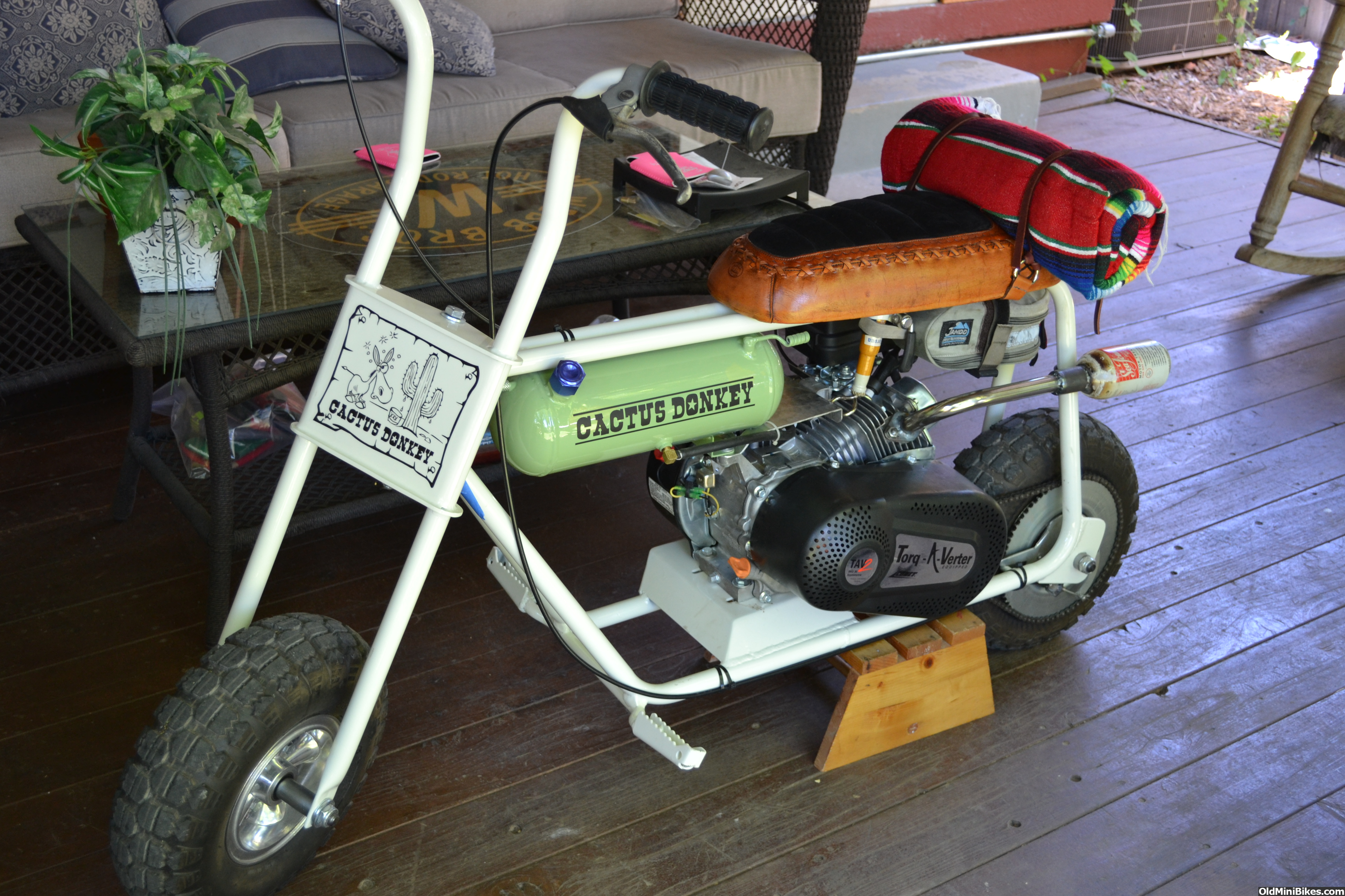

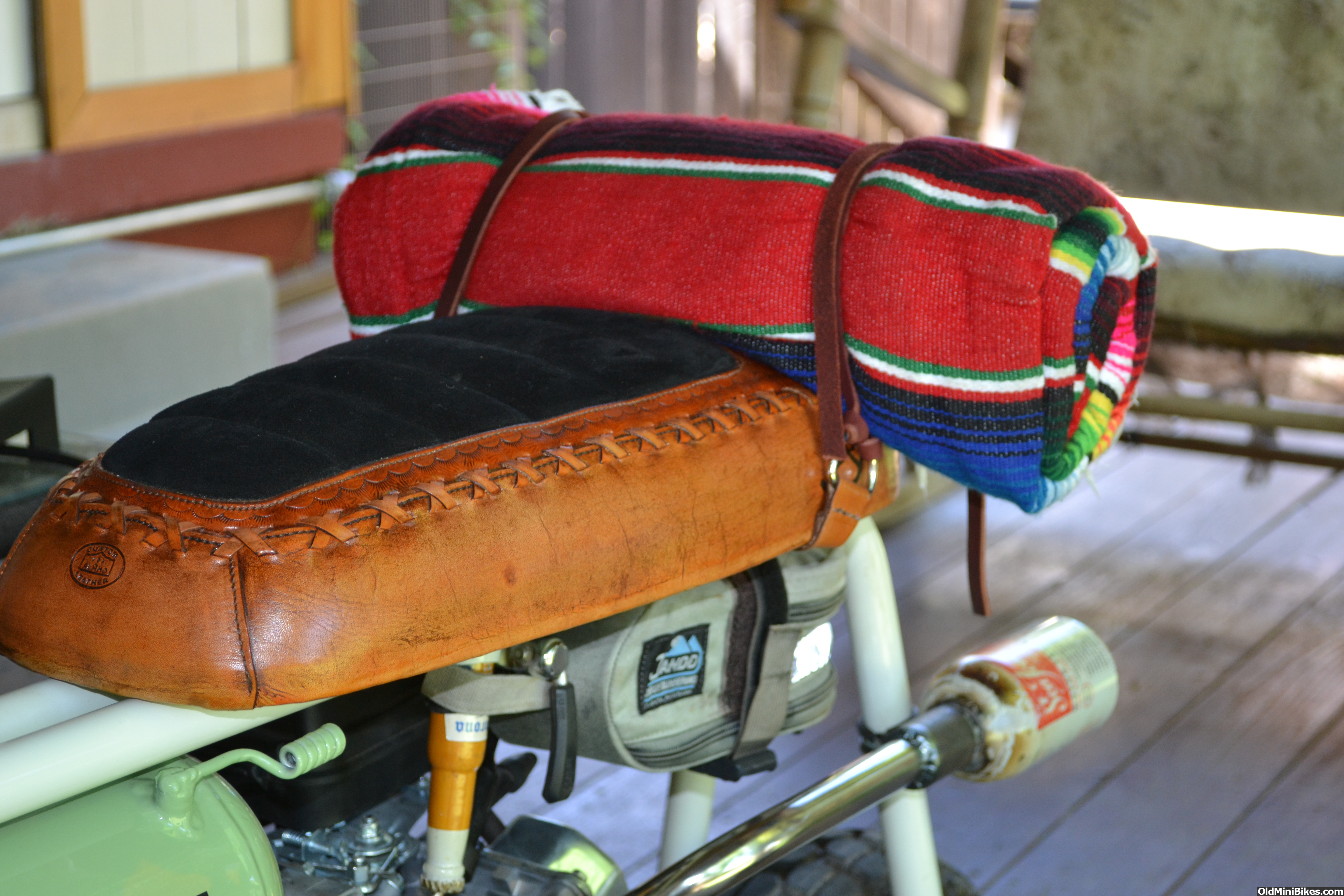

I found a Mexican blanket to tie on the saddle,

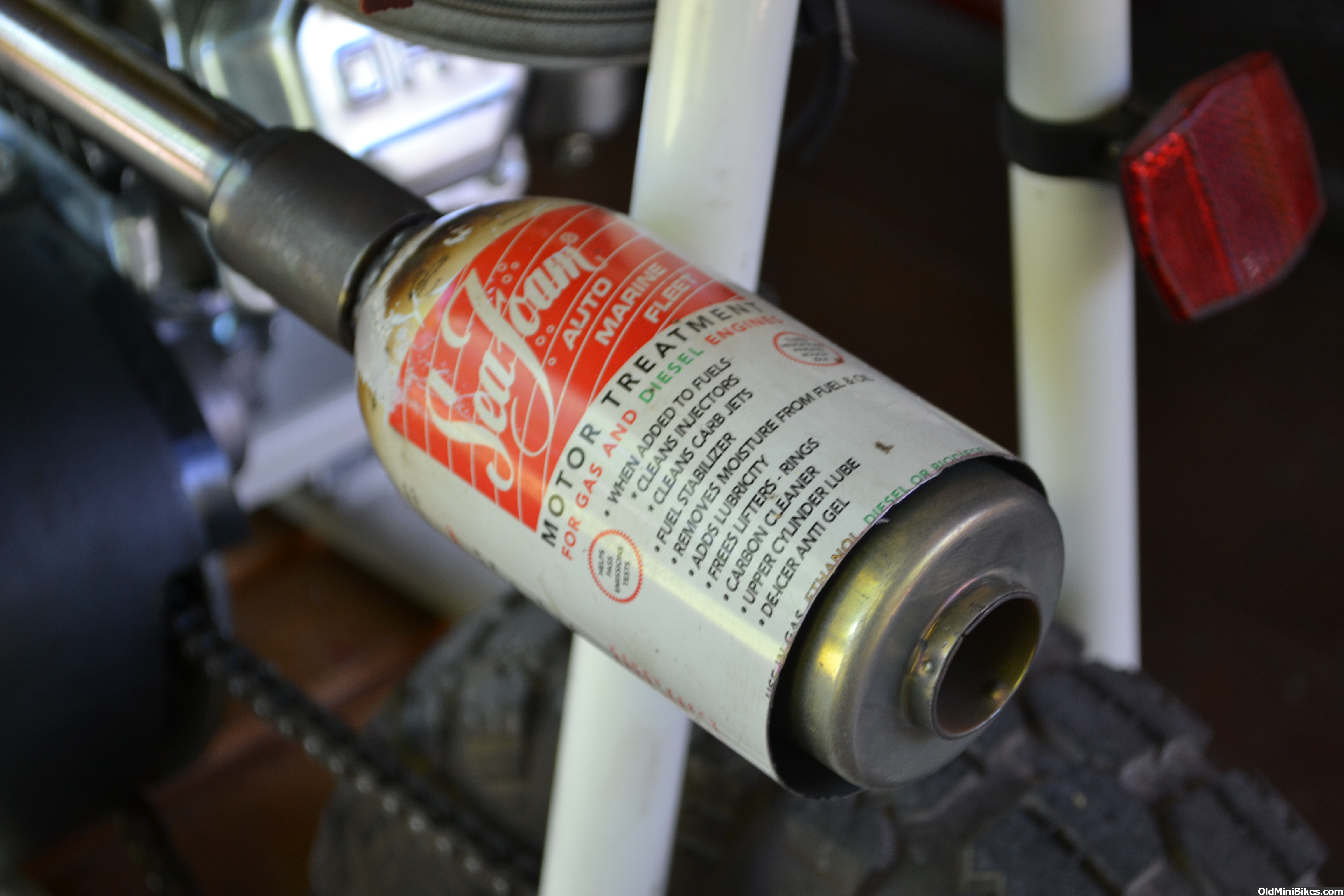

I also make a quieter exhaust manifold and muffler, I used a 8 horse Kohler muffler and a SeaFoam container heat shield.
