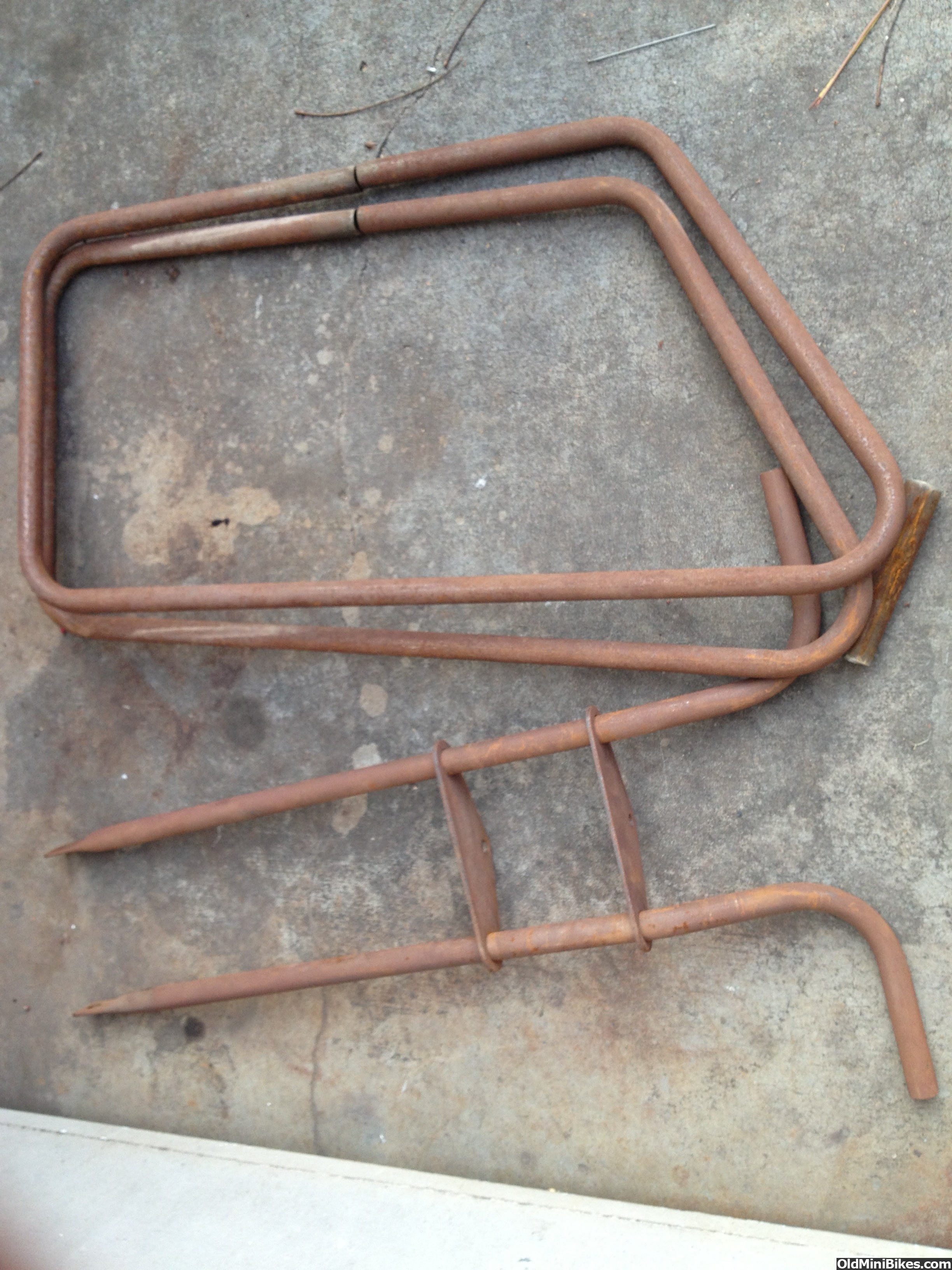

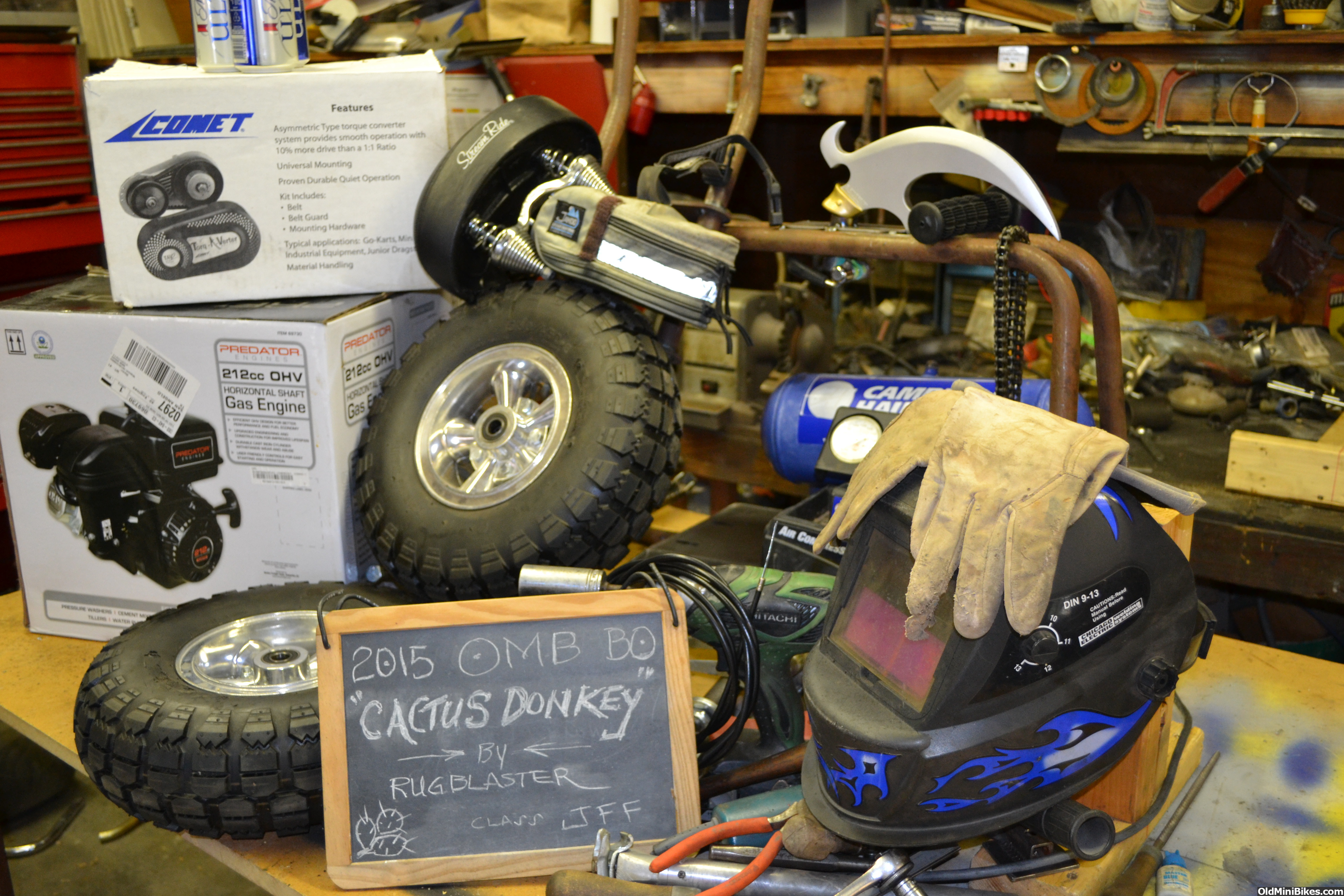

This is my first attempt at this. I'm building this bike for my younger brother to take camping, general pasture riding. So, it will be used primarily off road. They have a Honda Trail 70 now, and they need one more in the stable. They bought a little Sprinter motorhome, so they need little bikes. This frame is a NOS item that was bought out of Missouri. My older brother bought it and some hotrod parts off somebody on the HAMB. It came in an old Bird box, but I'm not sure it is a Bird. It is half again as large as a typical mini bike. It was a kit (just bent tubing, front fork and that front piece the fork bolts to) that was never welded together. The size is ideal because were all 6'+... 250-300 lbs.
I already tacked the frame, otherwise it would be a scratch build. This is my second mini bike I've done. My first is a '70's K&S.
We ordered all new parts from OldMiniBikes. Comet converter, wheels, tires, chain, spacers, brake, axles, beer, hardware etc. Also a new Harbor Freight stove. I have some parts to make heavy duty foot pegs, and a cratered Campbell-Housfeld mini compressor to make a cool gas tank out of. Also will paint and pinstripe it.........should be fun.

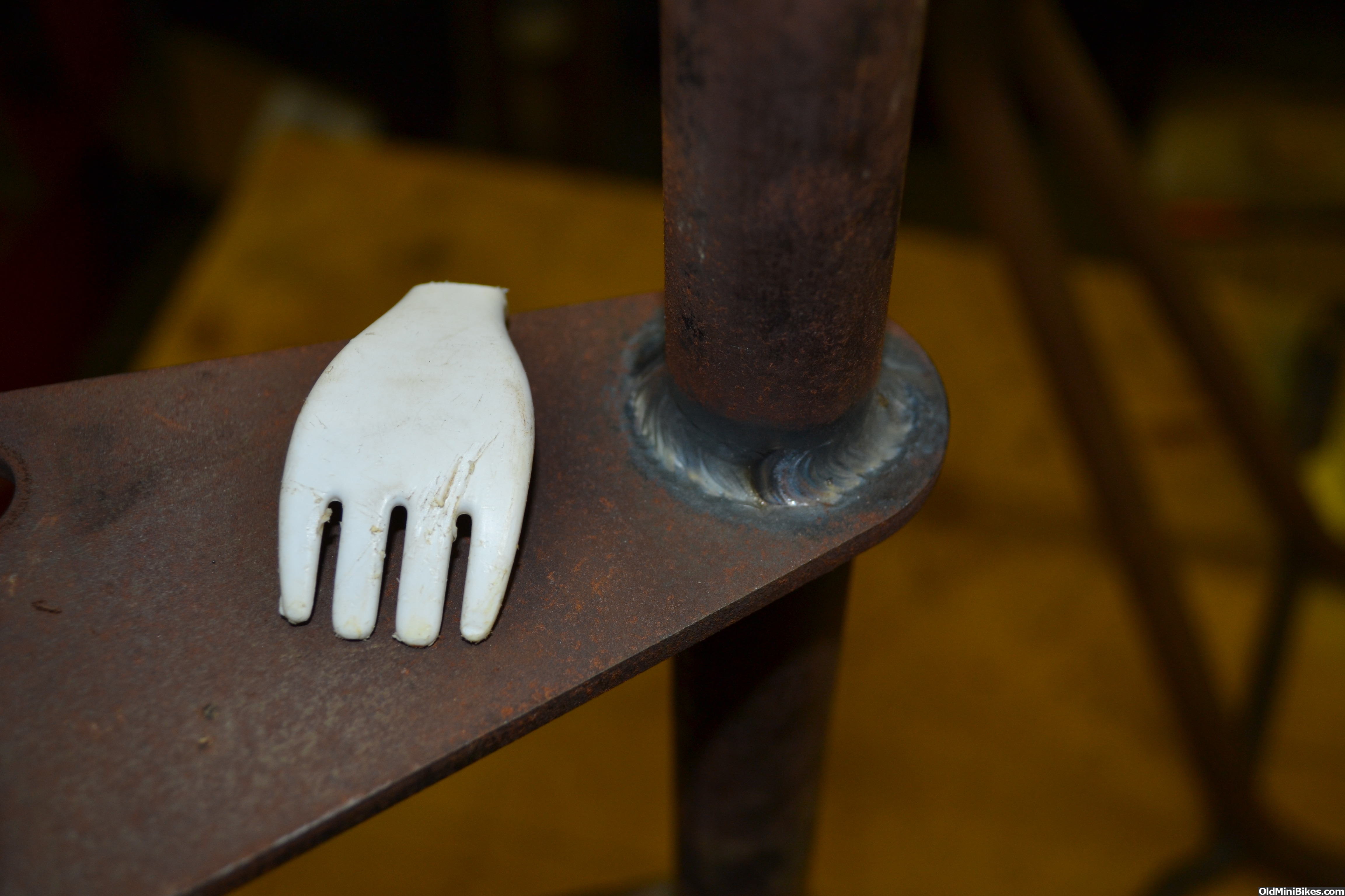

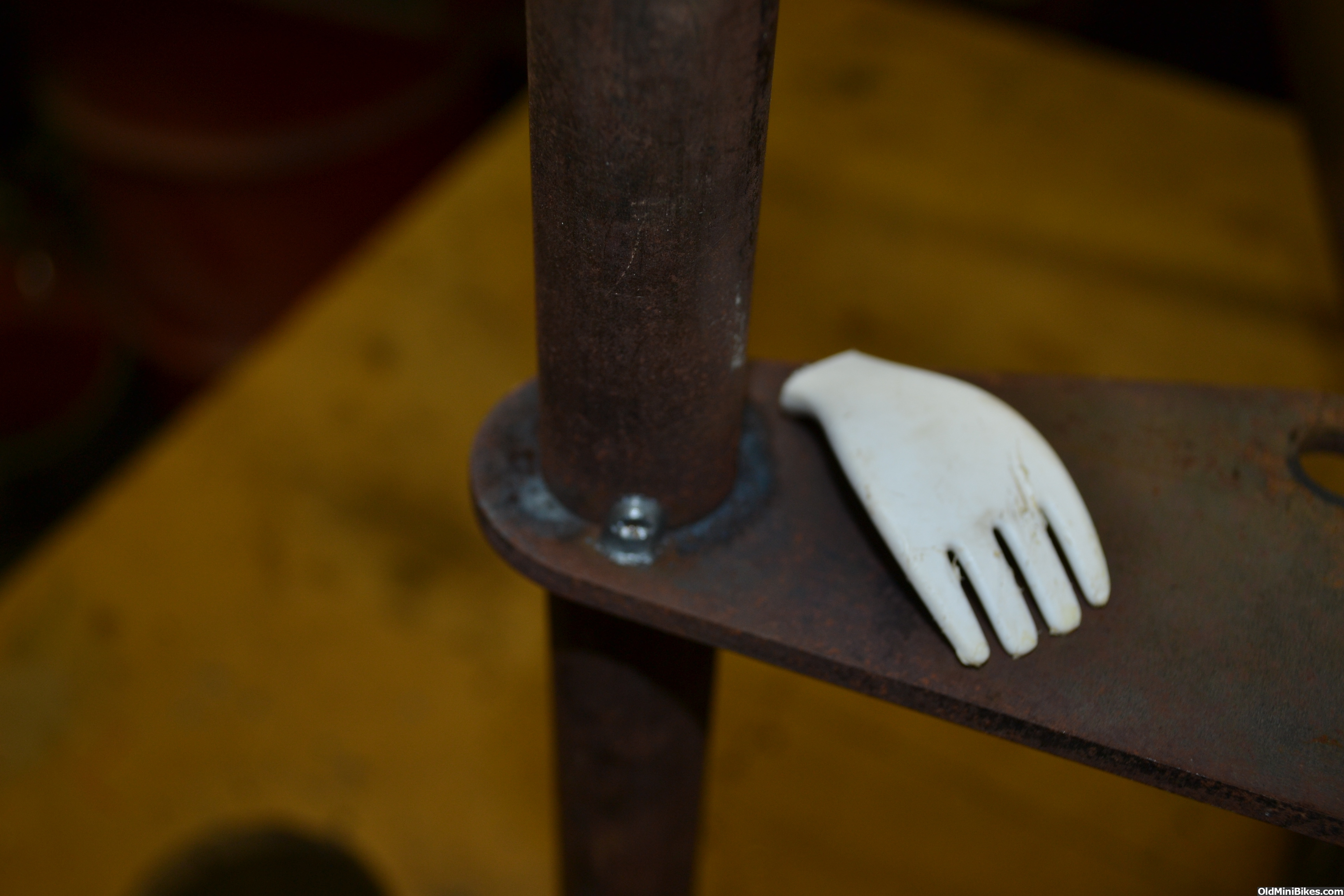

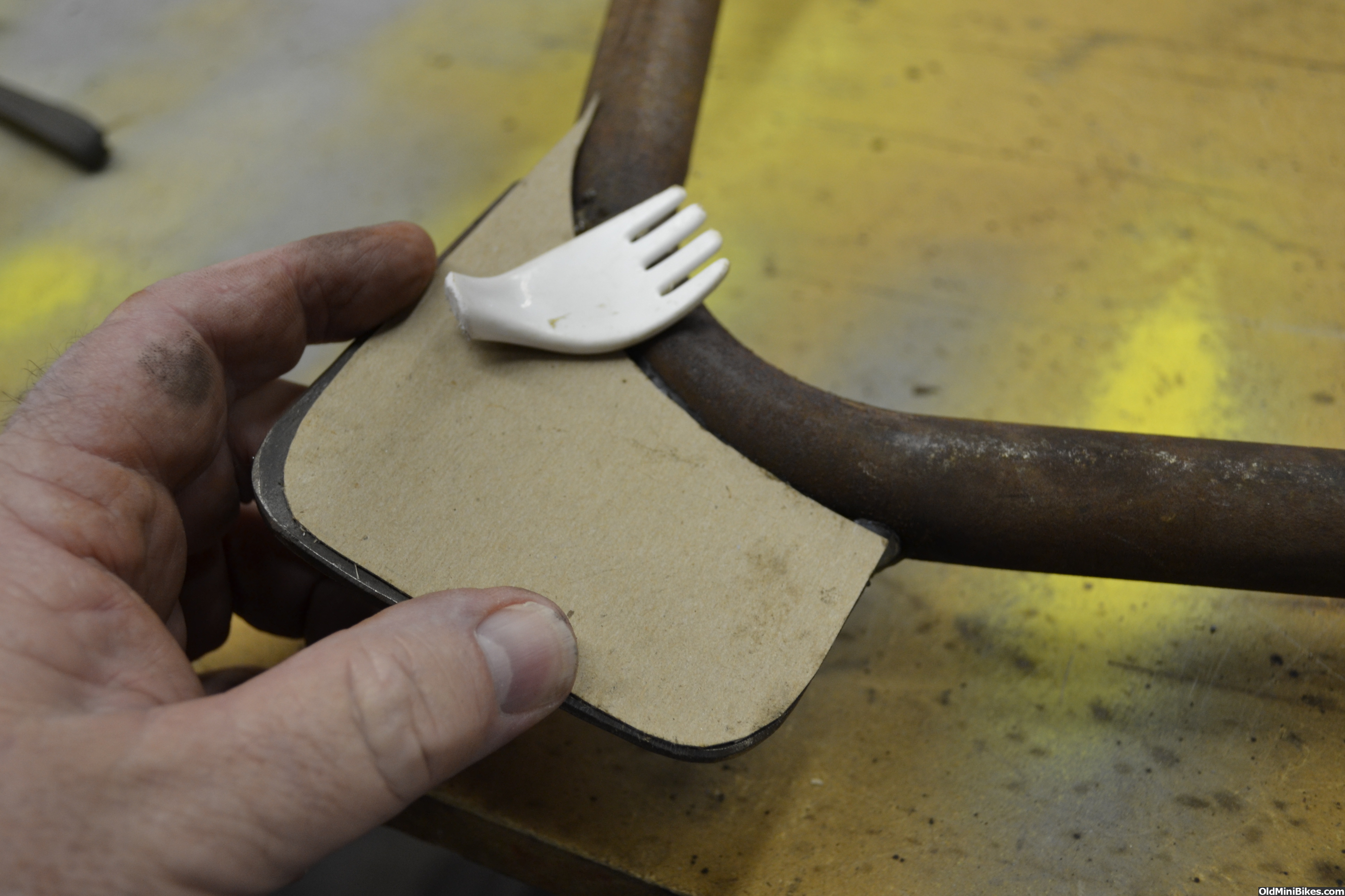

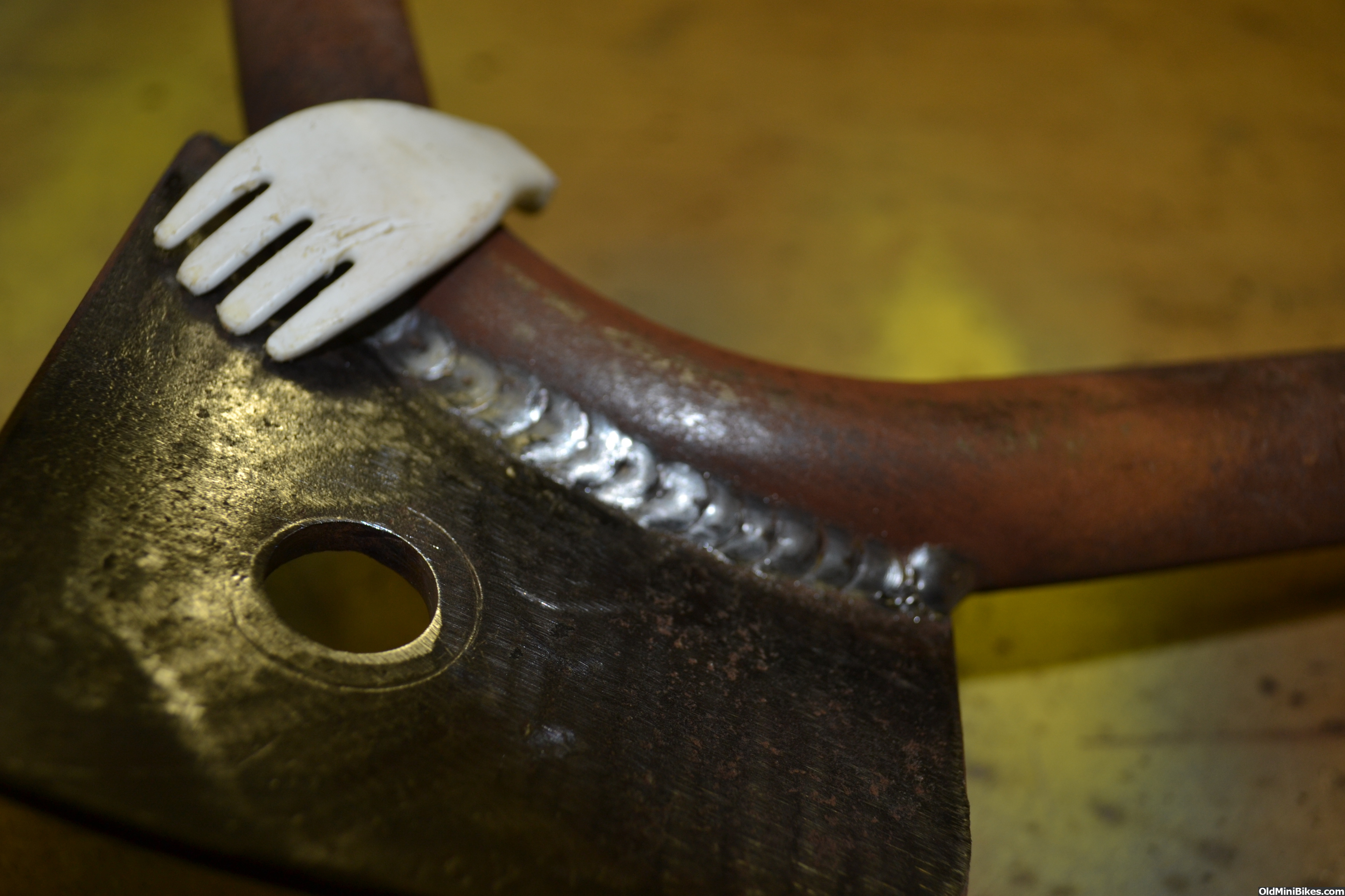

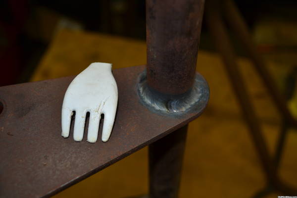

Finished tacking some stuff together and welded up the fork. Made some tabs for the rear axle.
The fork I tig welded......the rear axle tab needed a big fat mig bead, so I mig welded those.

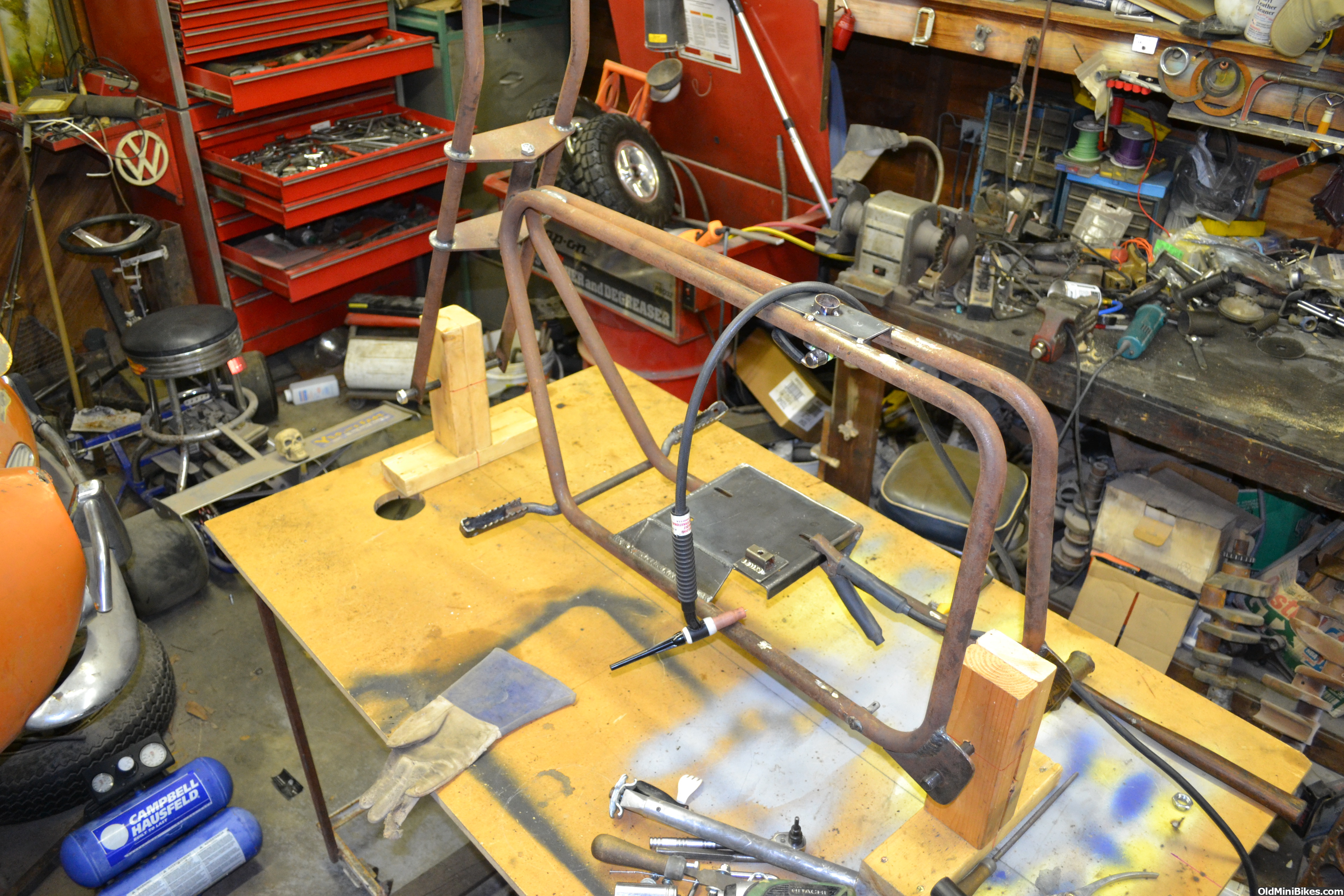

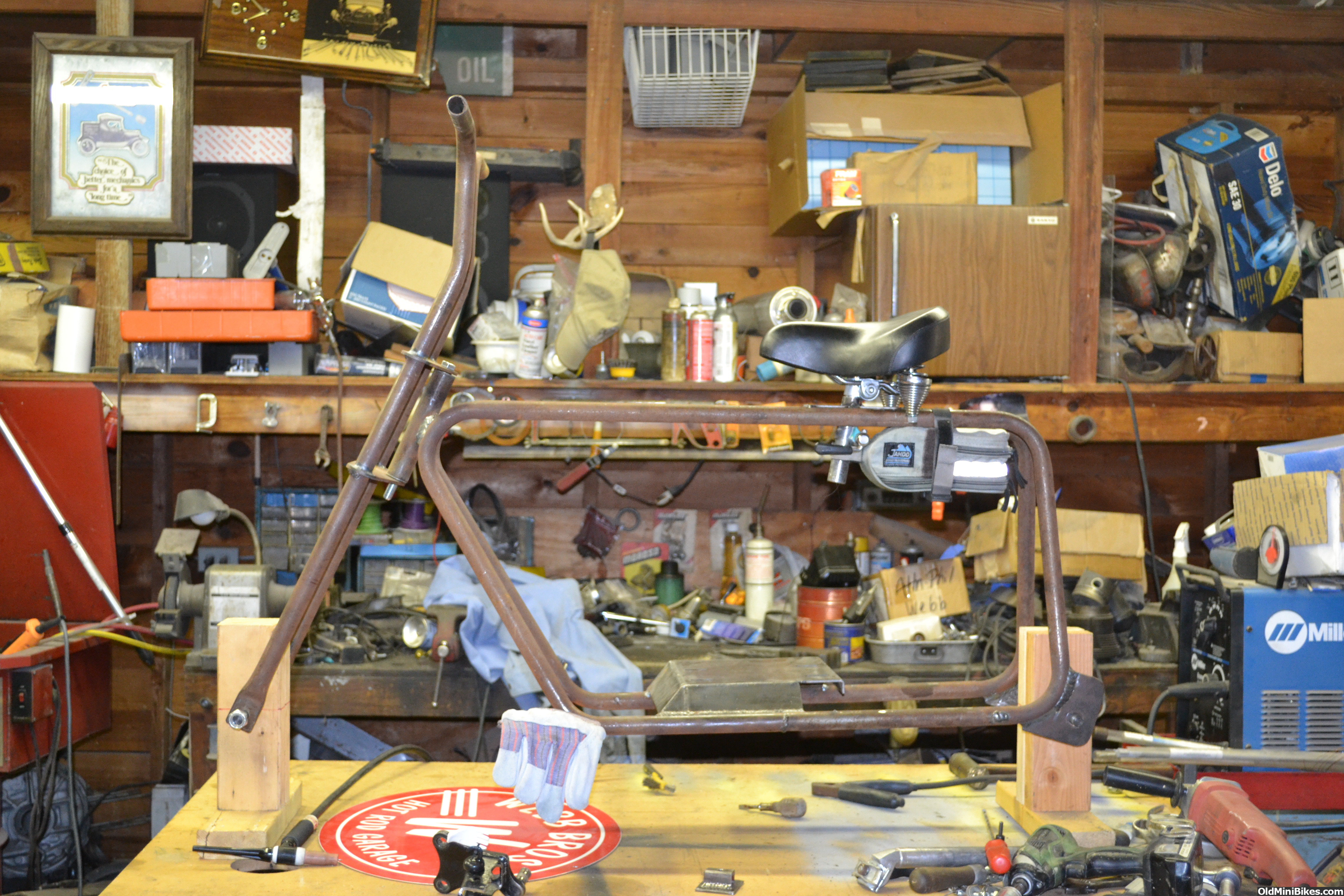

Frame jig
Here is a shot of my Redneck frame jig for this project. It features 2x4 "axle indexers", I knew the wheel/tire radius so that is what located the axle height. There is a center line marked on the table to line up the indexers to one another.
Sorry for the background clutter. About half embarrassing.

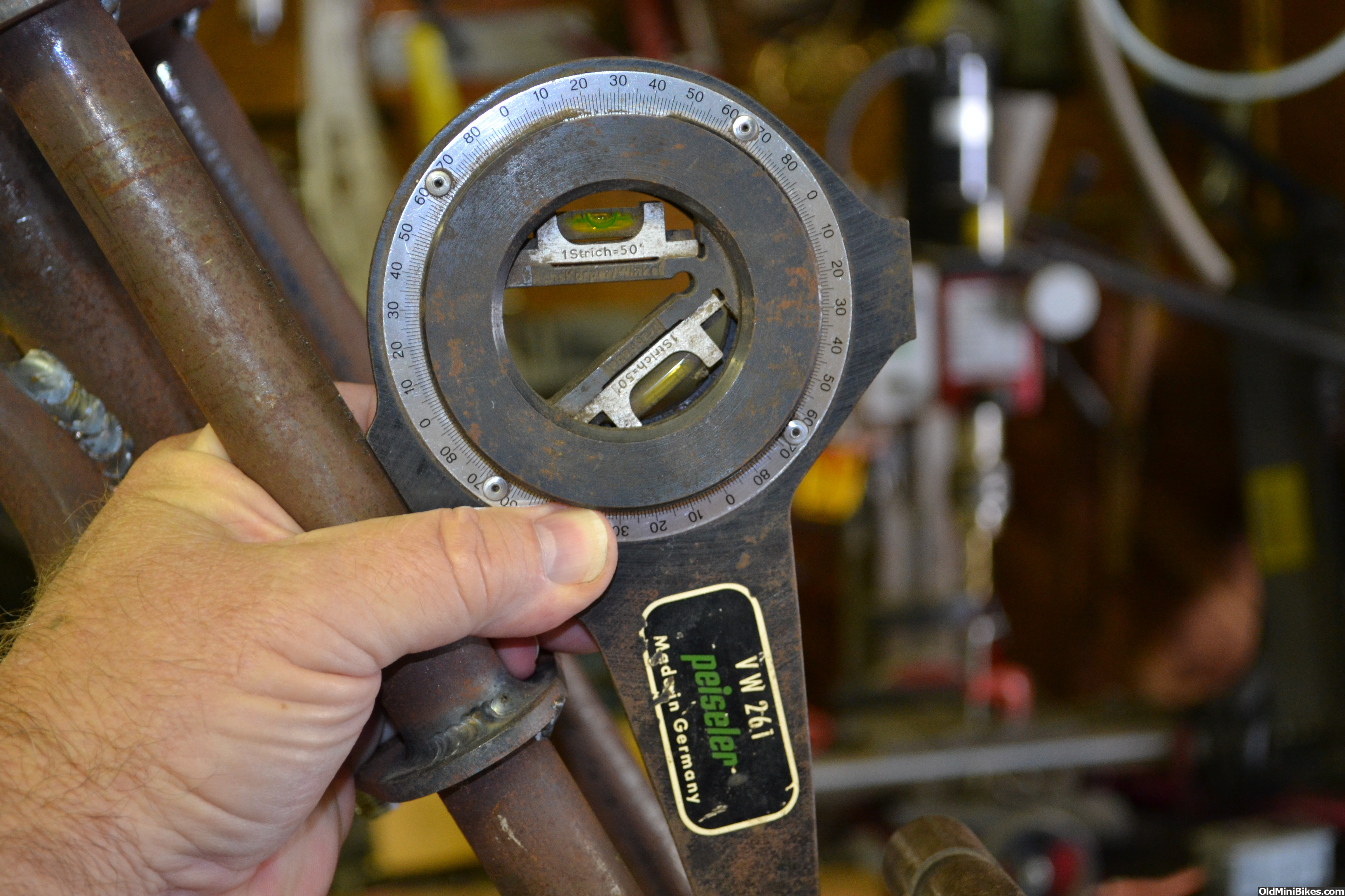

Front fork rake
I have this old VW/Porsche adjustable protractor I used to come up with 30 degrees rake.
You could also use it to see how much your mother-in-law has been drinking....(lean factor.)
