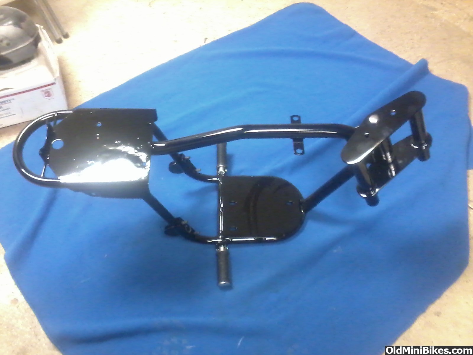

this project started by saving it from the scrap iron pile
this was the starting point,new motor plate cut out and welded in.
after the frame/bodywork done it got a nice new black paint job(urethane)hardened so it should take some abuse.then came the reassembly

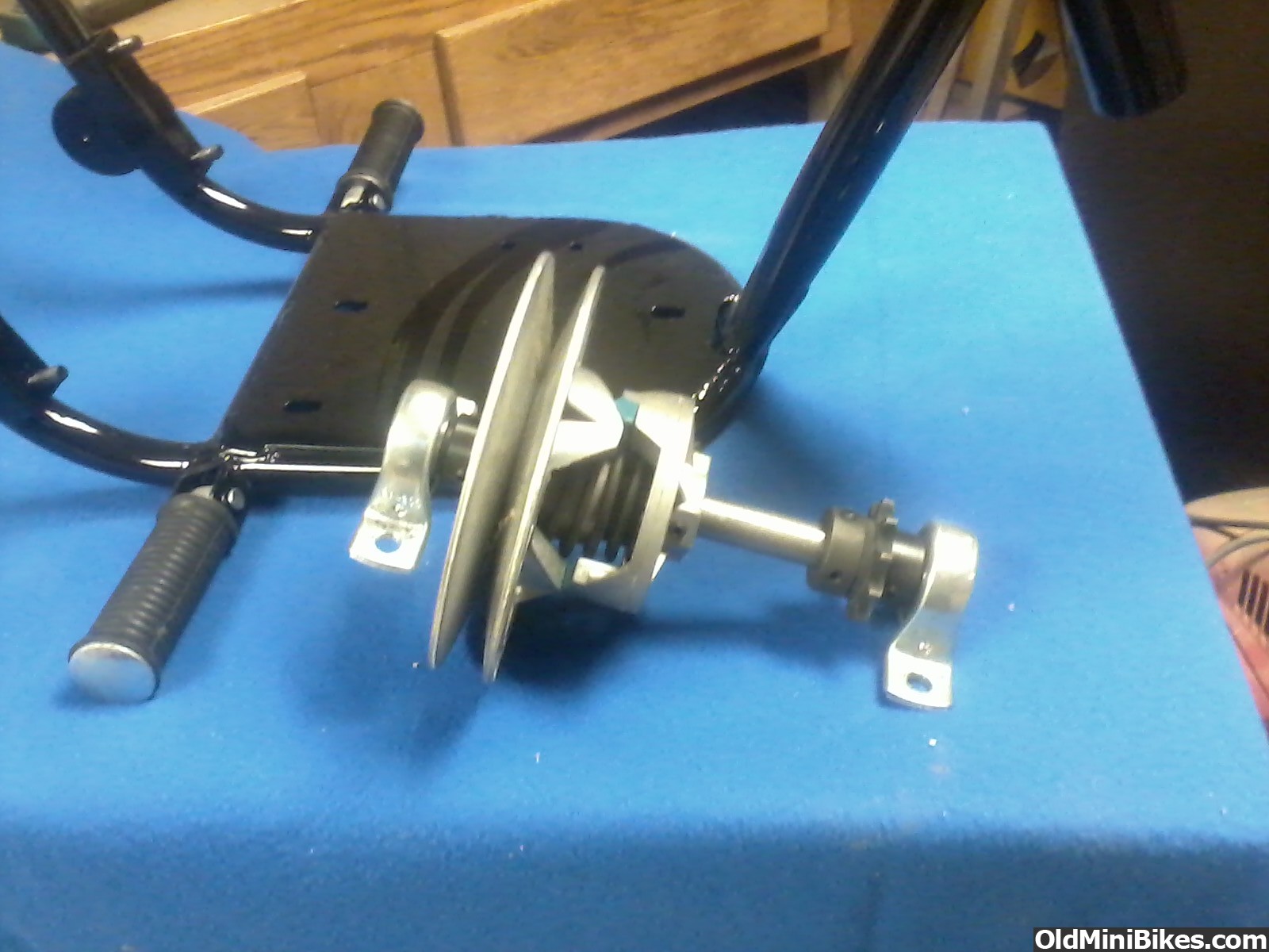

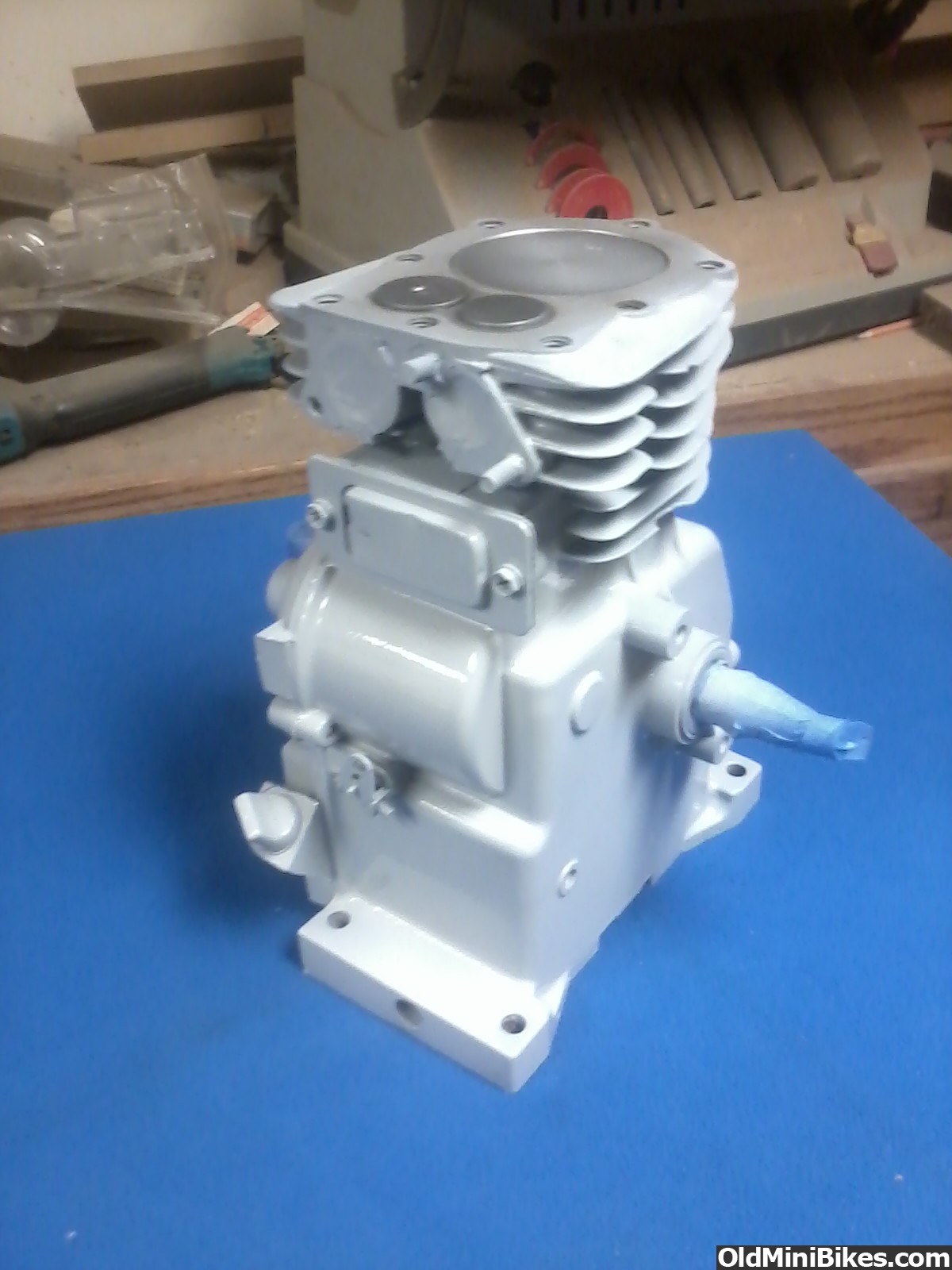

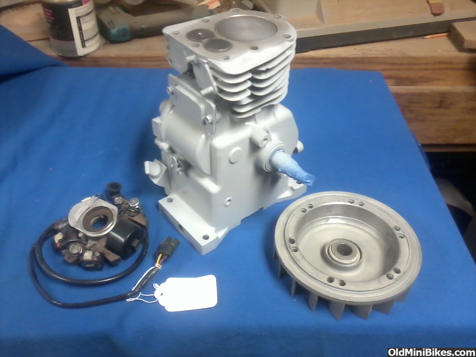

jack shaft,rear swing arm inplace. then it was time for rebuilding the hs40
.now it was the time to mount the motor on to the frame
.the motor was fired up on the stand before mounting it to the frame ,that way the mess from the gas and changing of the oil was not all over the frame,plus Ididn't have to worry about scratching it. made the repro exhaust out of stainless
