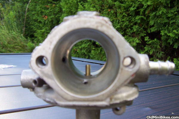

The American made OEM Tecumseh series 3 carbs are crap.
The Chinese after market ones are much better cast and machined.
Once you figure out what the issues are and make some adjustments to the low speed circuit these actually work pretty good and tune very easy.
You don't need the choke so remove that and use the primer to start it.
It bolts up to a Tillotson intake and uses the same filter adaptor kit.
Use some tractor pulling carb tricks like a float spring and a little epoxy to smooth things out inside and its a surprisingly responsive and easy to tune general purpose solution.
It suffers from a couple of problems.
It's hard to make a linkage for, and the throttle response is a little lacking compared to a dedicated race carb.
But I have made 6 of these now each a slight improvement on the last.
I am still working on an accelerator pump for it to try and cure the lag when you slam the throttle wide open on it.
I have yet to try out this last one.
This is a generation 5 carb.
I think its pretty good as is, but I built another that would flow more.
Its a general purpose carb for a general purpose solution.
Its about on par with GX390 carb, a little better throttle response from it and real good low speed performance.
if you watch real close you can see it gets away from Matthew here when he is a little too quick on the throttle at :04.
He may look like a big goofy kid, but he can ride ( well enough I considered having him race this bike at the king of pain )
But otherwise its very well behaved combination that you can ride all day.
I guess my point is if you put your mind too it you can adapt a lot of different carbs.

Ya that is a good carb
304WX I think is the one you want.
Make sure its drill pattern is for a clone.
Listen!
You need to research this carefuly.
And you need to understand the nature of this type of carb.
It races!
It does not go put put put down street.
If you are not going to spend most of your time with the throttle between 1/2 and wide and are not going to keep the rpm above 3500 to the peak of the power curve then this is probably not a wise choice.
These carbs do not idle.
#58
I want something that is going to breath in have very good take off an top end, an idle good. so I guess the minuki is the best choice 22mm
That or PZ22 off an animal.
I am not trying to sell you anything and have nothing to gain or loose by your achievements or failures.
But I'm telling you.
This works.
Tech series 3 off the OHV 11hp engines.
Use a Tillotson intake manifold from ARC and the velocity stack from one of the older tillies ( or make you own from a piece of phenolic )
This is cheap and it works.
Look careful at the linkage that is the hard part ( rod is a clone part cut to fit the series 3 ).
If you are handy, can weld, cut and have all these things close at hand give it a try.
Make it all from scratch...
What have you to loose?
Its no better or worse than the 390 carb conversion a lot of folks really like, but it has the advantage of not needing a choke and you turn screws to tune it.
