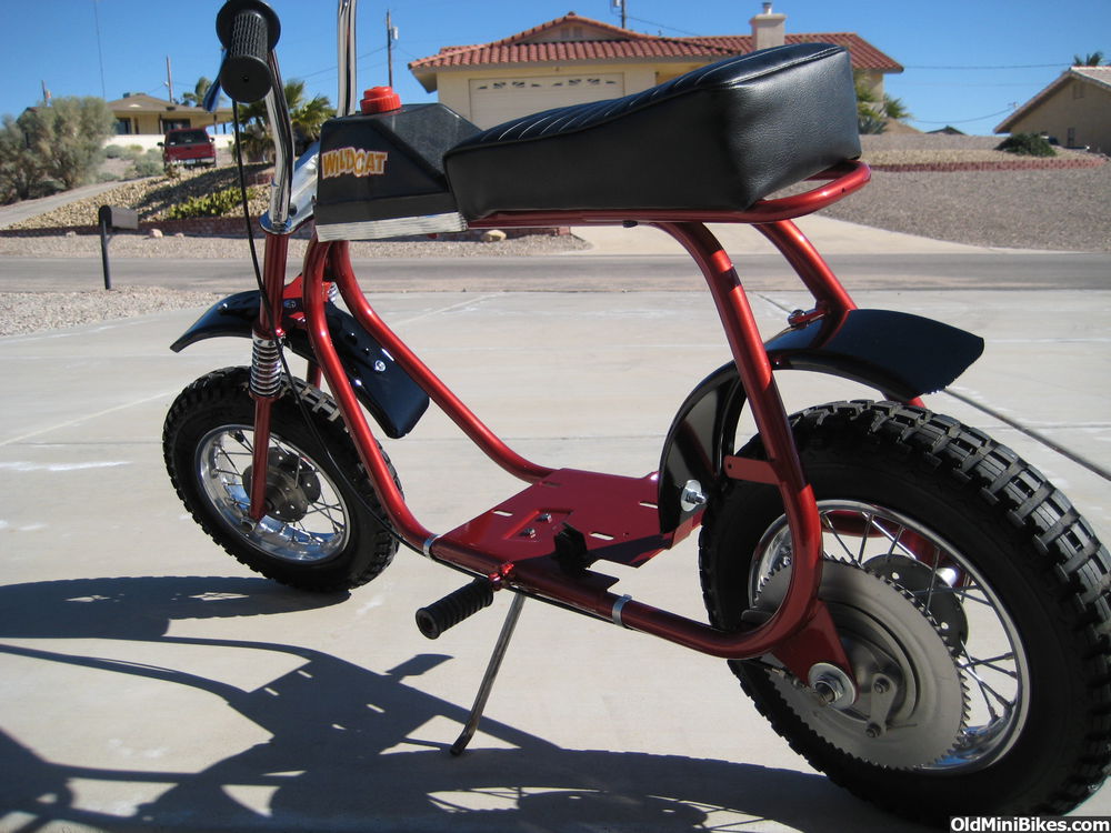

Probably the most uncomfortable, and worst riding bike HPE-Muskin ever produced. It was based on the Cat 400 frame, but with a longer forks, shallow rake, large, easy to bend axle tabs, and a grab bar behind the seat. Badged "Endura," it was nothing like the remaining Endura line, which had swing arm suspension, and TC88 drives.
Known best for being a good bike to take parts off of, I ended up with an original 1974 Cat Wildcat several years ago. I promised the seller, a member here back then, that I would never part it out.
In 2012, I did a light restoration on it, chroming a few things, and rebuilding the original H35 Tecumseh. This is one of my Grandsons and yours truly taking it for a spin back then.

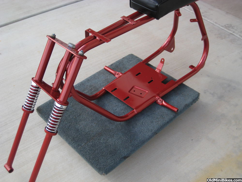

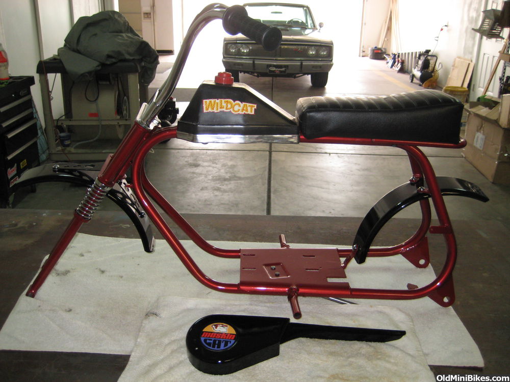

After stripping the original, and badly damaged paint, I sanded it and added turn limits to keep the trees off of the frame. I had more left over red base coat from other projects, so opted to use it. I added a lot of rose pearl to the paint. Then I added more, and more. I applied an epoxy primer, then three coats of the red, followed by three coats of urethane clear.
The plastic Cat fuel tank was leaking badly. I melted the outside splits as best as I could, then coated the inside of the tank with Caswell's Sealer. I'd already stolen the long chain guard, so obtained a shorter one and welded on some 18 ga, sheet that I fabricated to represent the original one. All decals were re-used from the previous restoration by using "goo gone" and acetone, then applying a quality 3M adhesive spray. Tedious job. Kenny seat from 2012.

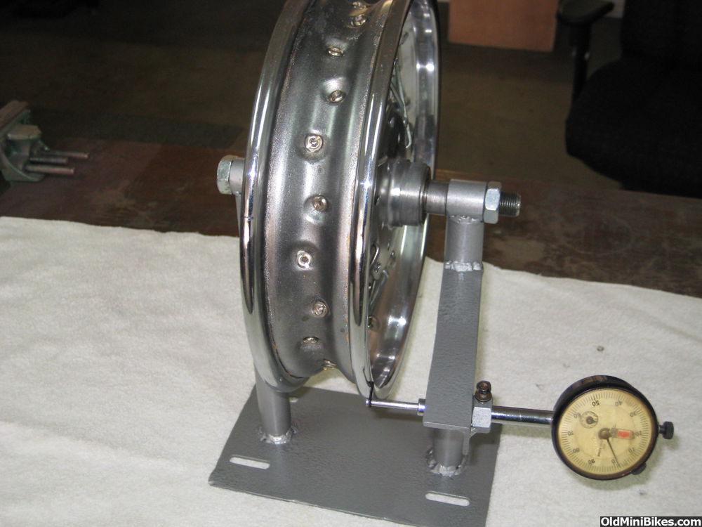

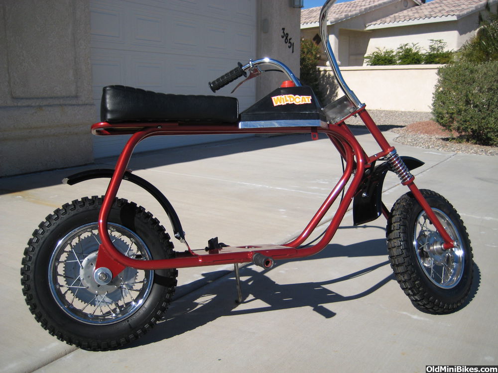

I stripped the wheels down, and cleaned off the surface rust. I made a simple truing stand which uses the Tecumseh timing tool.
It's a roller.

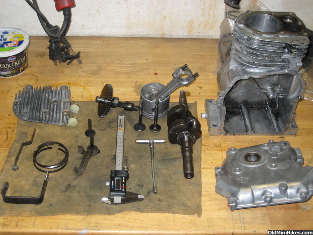

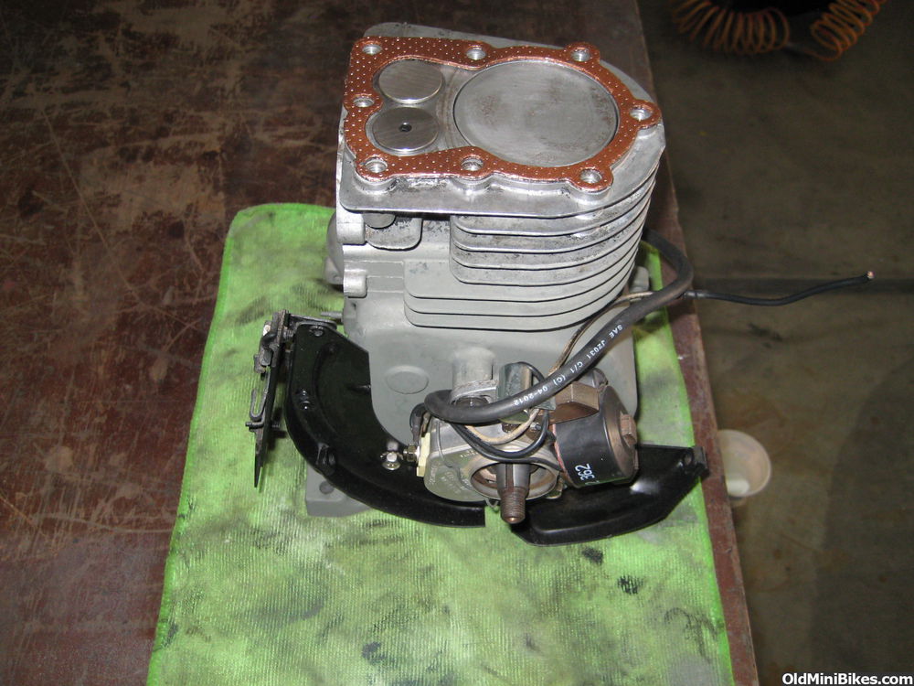

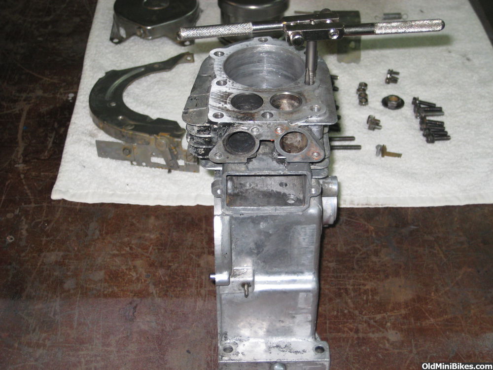

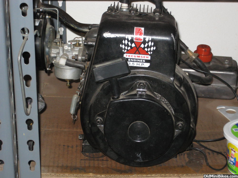

After tearing the engine down, I noted the valves were worn and pitted. The bore had some light scratches, and was both hour-glassed and oblong from wear. Both valves and rings were replaced, along with carburetor, points, condenser, and magneto.

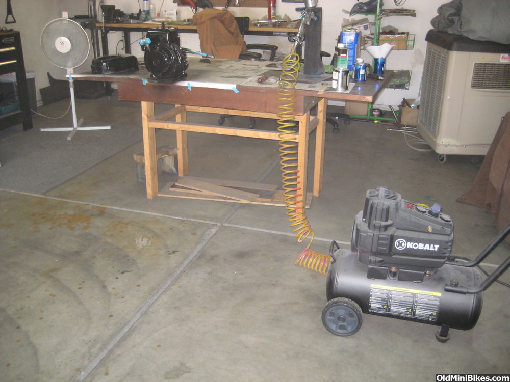

It does not take a lot of money and equipment to paint mini bikes. I have been painting with this setup for years. The little compressors last me five years, and I toss them out and buy a new one. Total cost of my paint system is about $300.

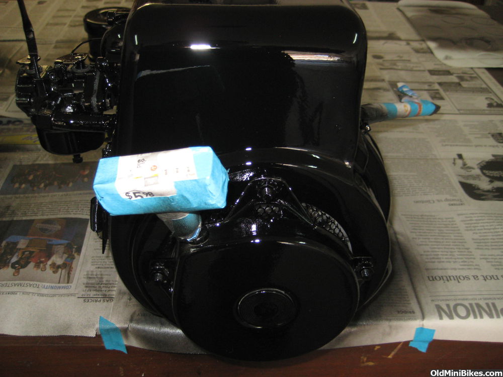

Close up of the engine paint. Urethane single stage, far too glossy for an original looking engine.

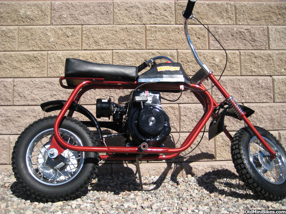

After a quick test ride, (still handles as bad as it always did) I shot these final photos.

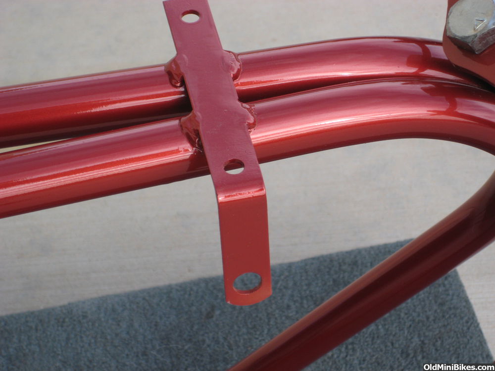

Thanks Derek, I am not surprised you were the first to comment! :laugh: Obviously, I took some liberties with this bike. In addition to welding on fork stops, the pegs and grips are wrong, huge washers on rear axle are there to provide support for the lousy axle tabs that bend too easily. This is the first one I've seen with chrome bars, but some of them did come that way, including the fuzzy brochure photo. Something I did not realize until recently, was that these also sported the Endura plastic seat pan. The bike is very high geared, and the air filter hitting the rear fender prevents me from moving the engine back far enough for the chain to not run in the plastic guide. LOL, this design sucked. I used rubber impregnated washers on the fenders. That was a cool thing to do, because they DO crack.

Thanks, I hesitated to include that photo, since it's not exactly the epitome of safety gear represented in those pajamas! The same grand son was here recently, now nearly ten years old, and was hitting me up for rides on my Tote Gote. This bike is his, although the poor handling characteristics are going to relegate it to garage queen status with occasional start ups by his Dad, 600 miles North.

Thanks Tom. I posted the embarrassing photo of my "paint booth" to illustrate that it doesn't take a whole lot of equipment to paint our bikes. I find using a gun to be far easier than using a paint can. Easier to control, easier to hold the trigger, can adjust the stream to get the tiny bits. You know me well enough to know how much I enjoy the creativity involved with mixing paints and substrates, and doing some experimentation. It is by far, my favorite aspect of the entire hobby. The only down side is having to clean the paint gun, when I'd rather be enjoying a cold one, looking at the finished work. The other bad part, (and I was thinking about this) is having to sweep where the R/T was sitting after I moved it out of the garage.
