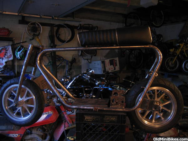

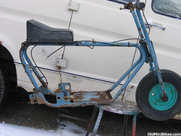

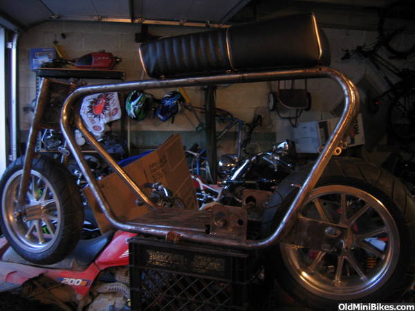

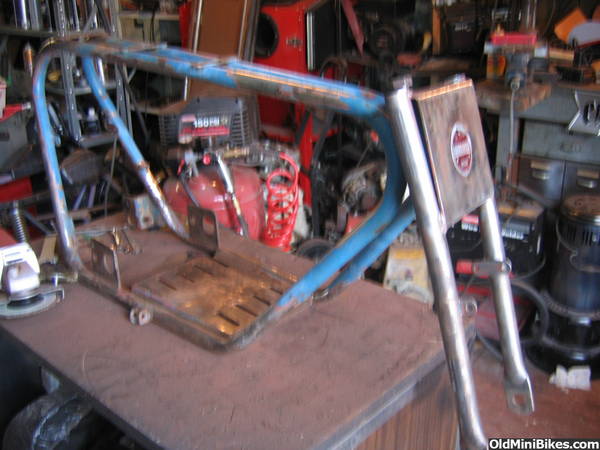

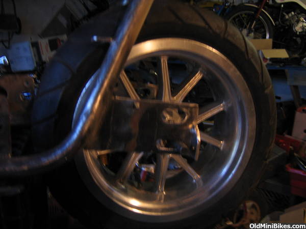

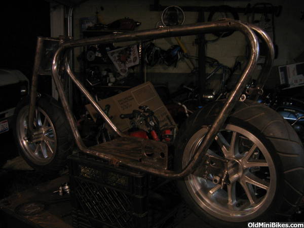

Well after looking at a poor bonanza sitting in my yard i decided to do something with it. I was gonna make it my snow bike but i think thats gonna have to wait till next year. We dont have that much snow here. I decided to make it a summer street bike! I bought these super pocket bike wheels in the summer and was gonna put these on a rupp but sold the rupp. This frame was perfect for these wheels because there is no shocks and it will be primarily rode driven not for off road use. The frame was real rough, lots of crap welded to it. I cut off the handle bars to put on 7/8 bars, mabey drag bars? I really want to make it a 1/8 mile drag bike. I also did some heavy modifying to the rear wheel mounts. Cut drill weld reshape, its gonna be all custom.
