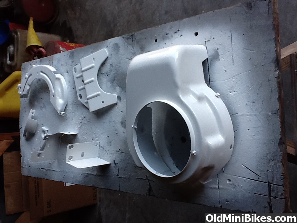

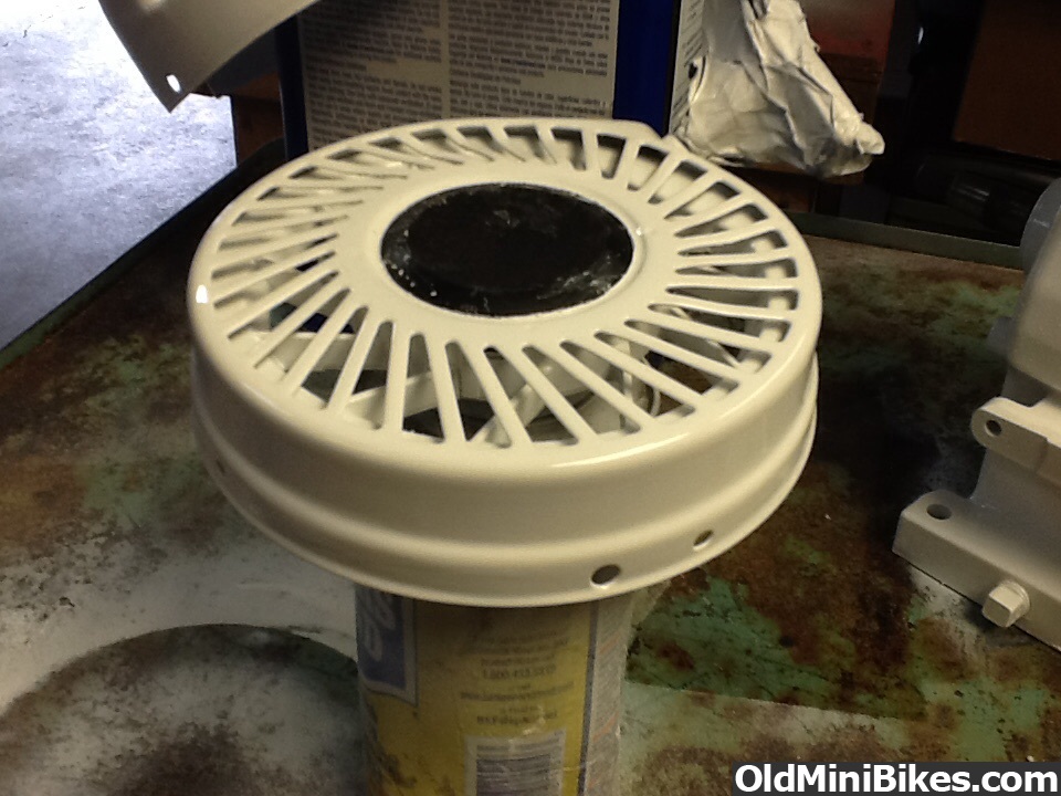

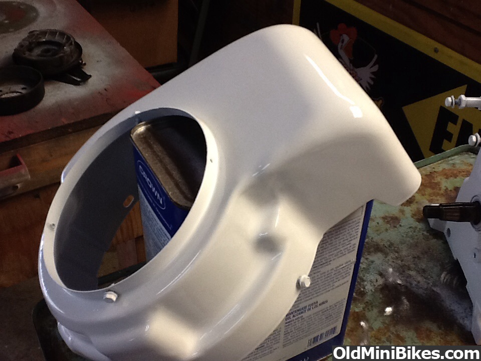

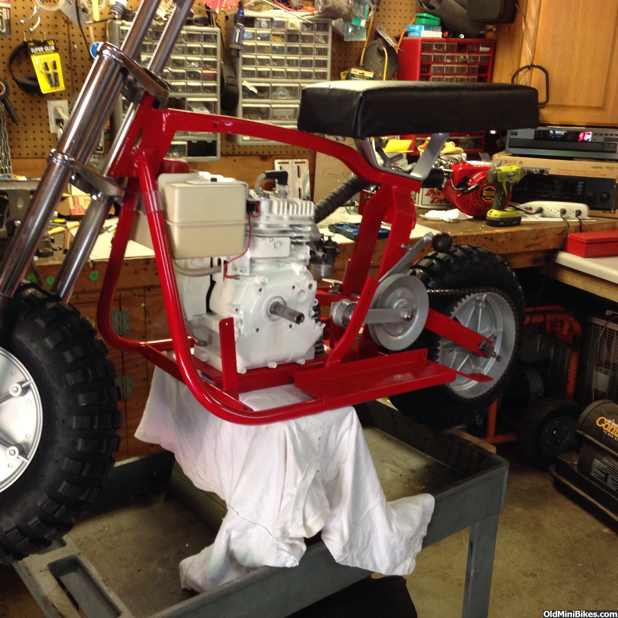

Yes doggie it is , it's duplicolor enamel engine paint . Whis is not that great of a paint , but the 2K clear will make it bullet proof . It's a two part epoxy that gets mixed in the can when you release the red button on the bottom .
You then have 48 hours to use , because it sets in the can after that .
