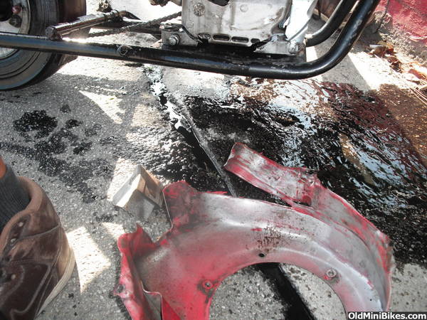

Thank You Edwin for the use of the pictures. Flywheel failure same engine as above video

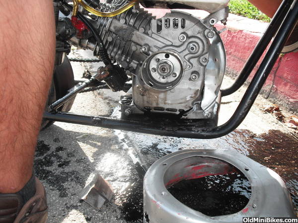

More Pics Thanks MiniDragBike for the use of the pictures.. Flywheel failure at about 6100 rpms slightly modified stock flywheel
