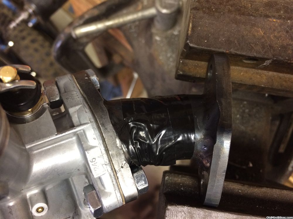

Tried getting the Mikuni to work .. I cut the intake to make it a bit straighter and shorter ...
Grabbed the duct tape to seal it ...

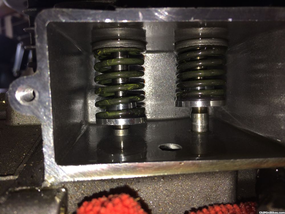

Being 23 year old springs could they be sacked out from being loaded all these years?
It is possible one was compressed for all those years in storage.

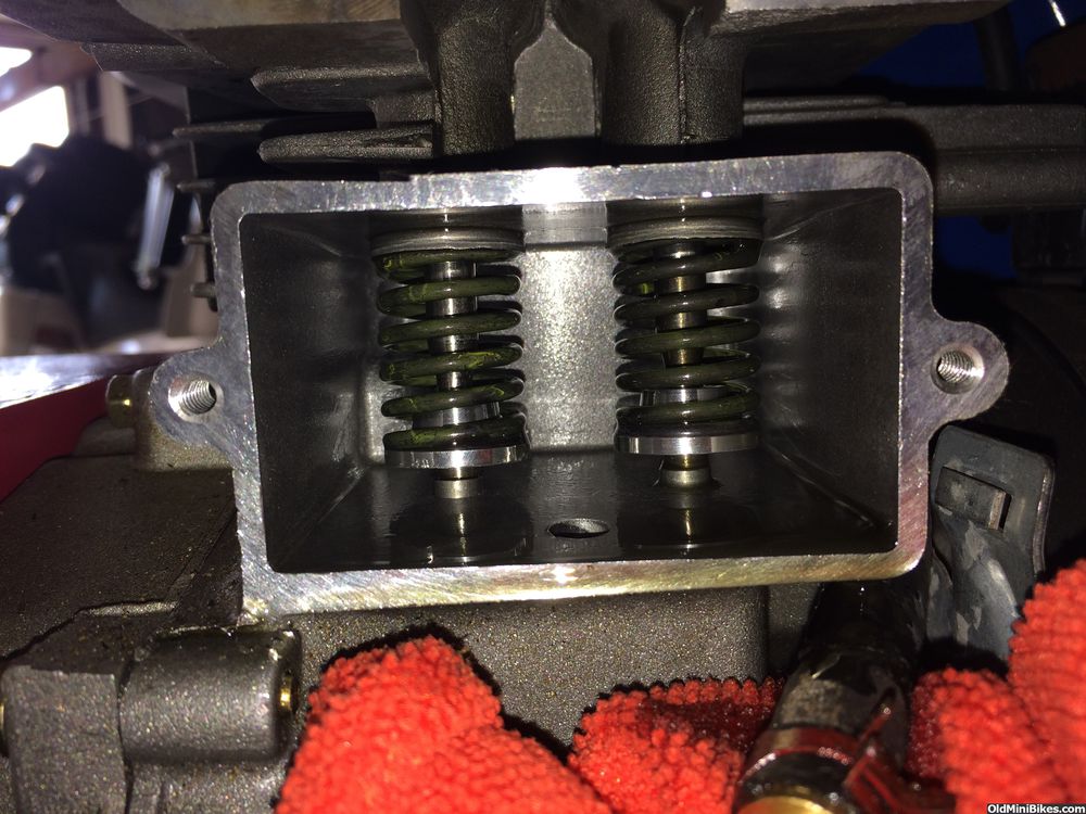

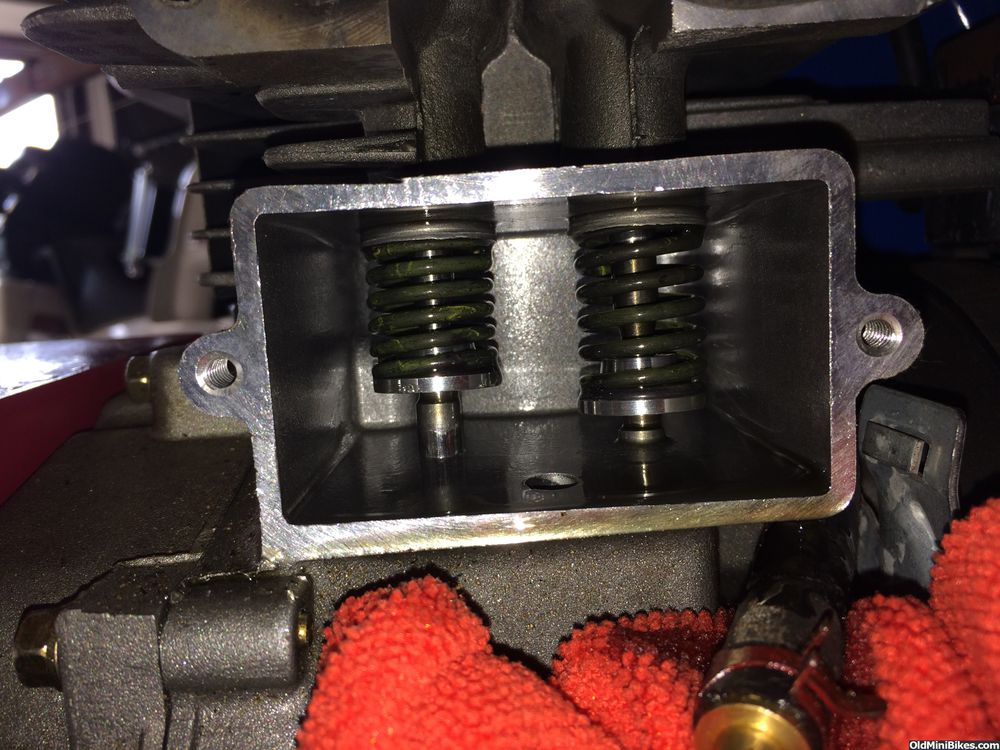

The breather cover was pulled and here is what it looks like in there right now.

Should I consider new springs?
Floating valves were mentioned but someone said my symptoms did sound like floating valves. I don't know what it would do if they were floating.
I am inclined to go this route, either the intake valve spring is weak or if they are different from the exhaust ones they got switch around.

I think you have ruled out reversion. I would not rule out valve float but they came with special springs that were very stiff with alloy retainers. Could cam timing be off?

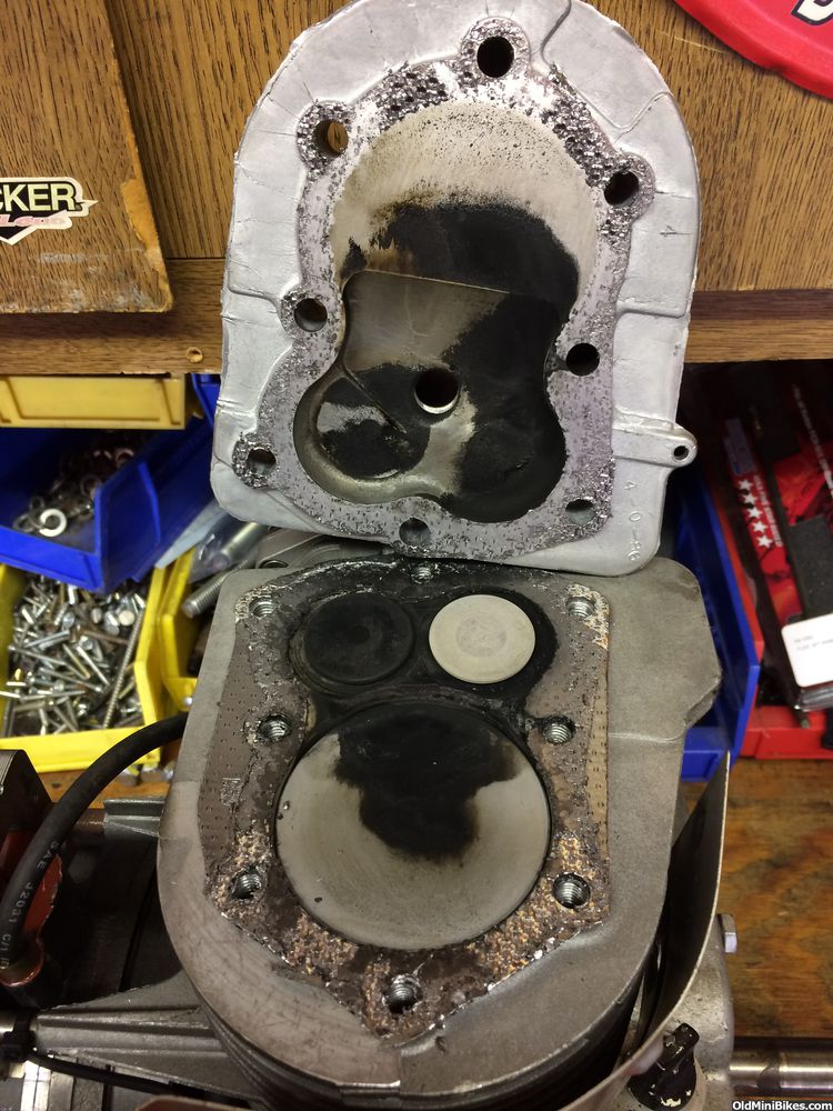

Head and Deck ...

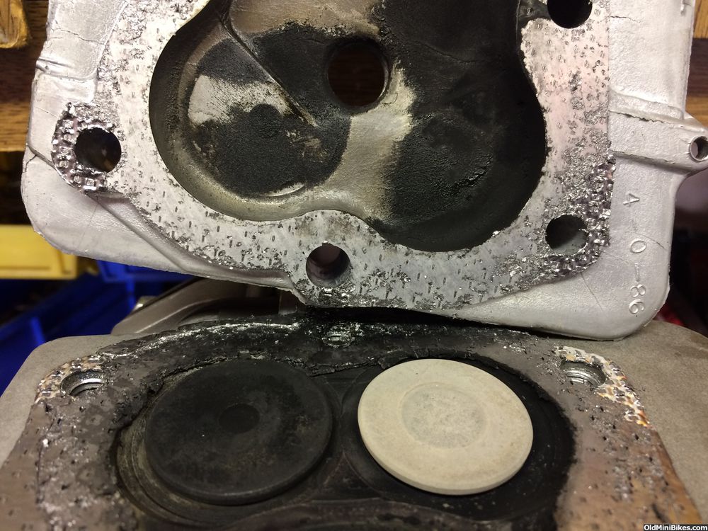

Head and Deck, bigger view ...

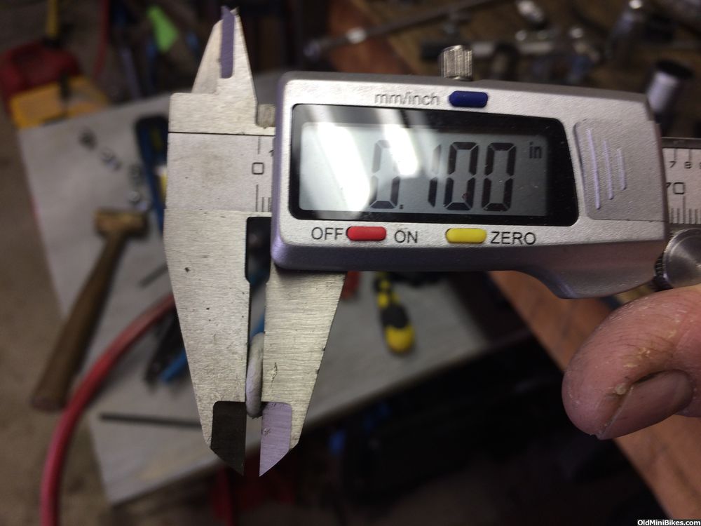

Valve clearance as taken with 2 part epoxy, the head was snugged down while it cured ... .100 on the schnoz ...

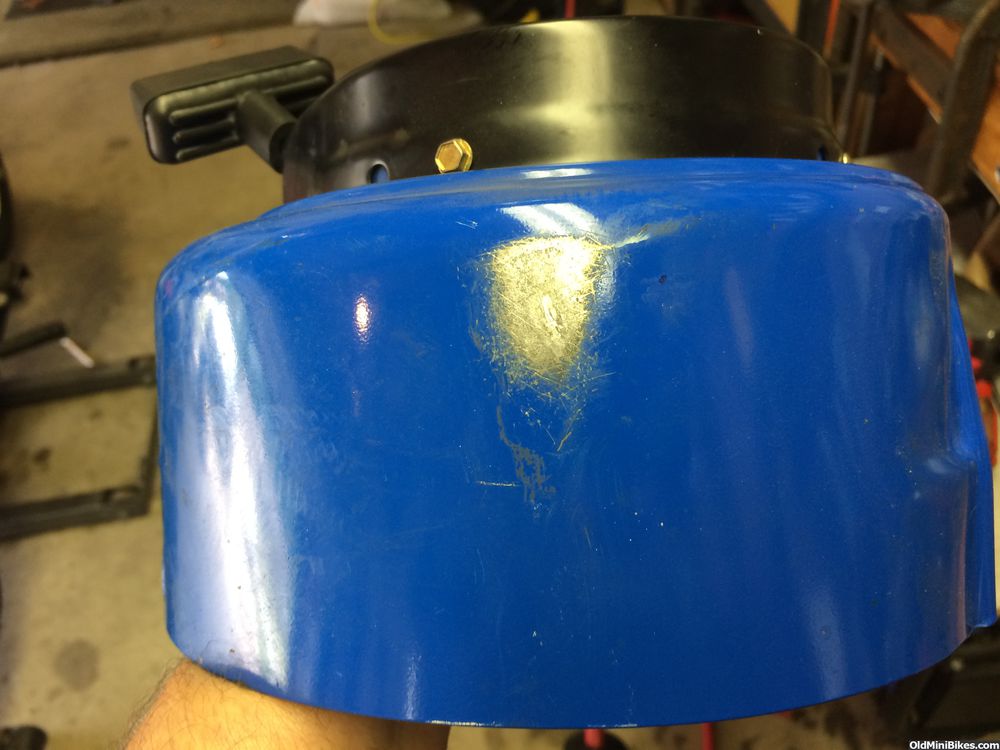

Blower housing has been rubbing on the mounting plate ...

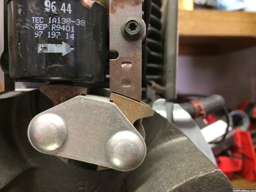

Magneto air gap is .004 on the left and .019 on the right ...
Magneto looks beat up, I don't know if it came that way or it happened after I got it ... nothing ever got in there that I know of and I don't remember hitting it ...

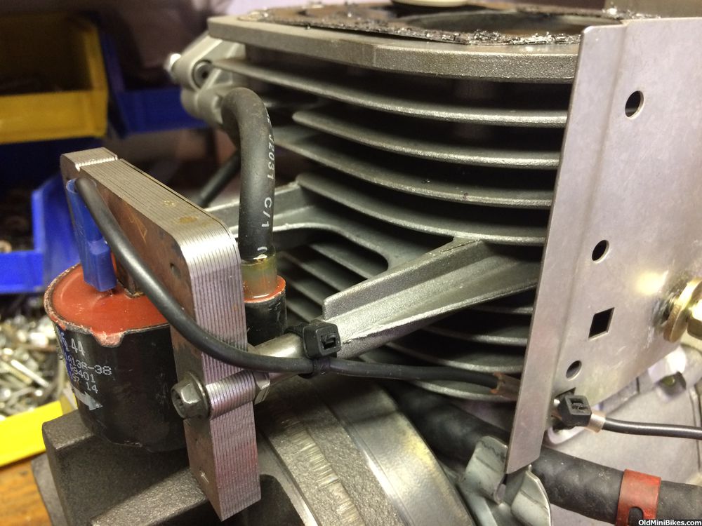

This is the kill wire routing ... a small tube was placed around the wire where it goes through the sheet metal, it was gently zip tied to it ...

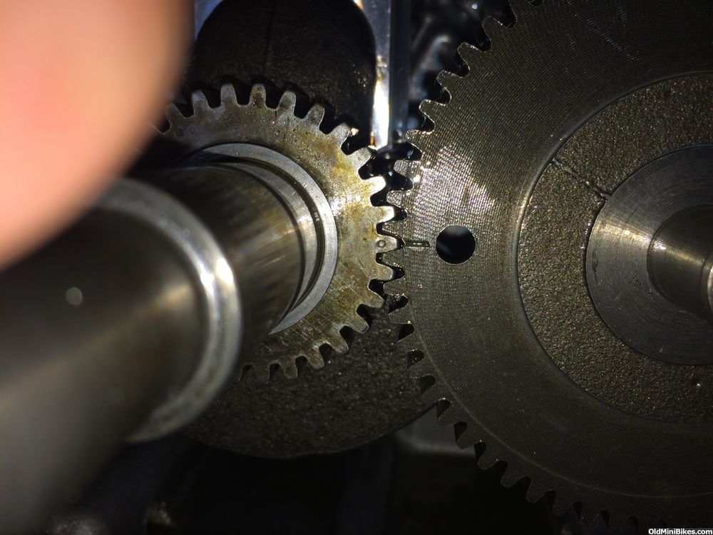

Pulled the side cover, used a puller on the bearing, cam never came out ... here's the line up ...

I am not understanding valve clearance are you measuring to the head? What is the clearance between tappet and valve stem Is it correct?
