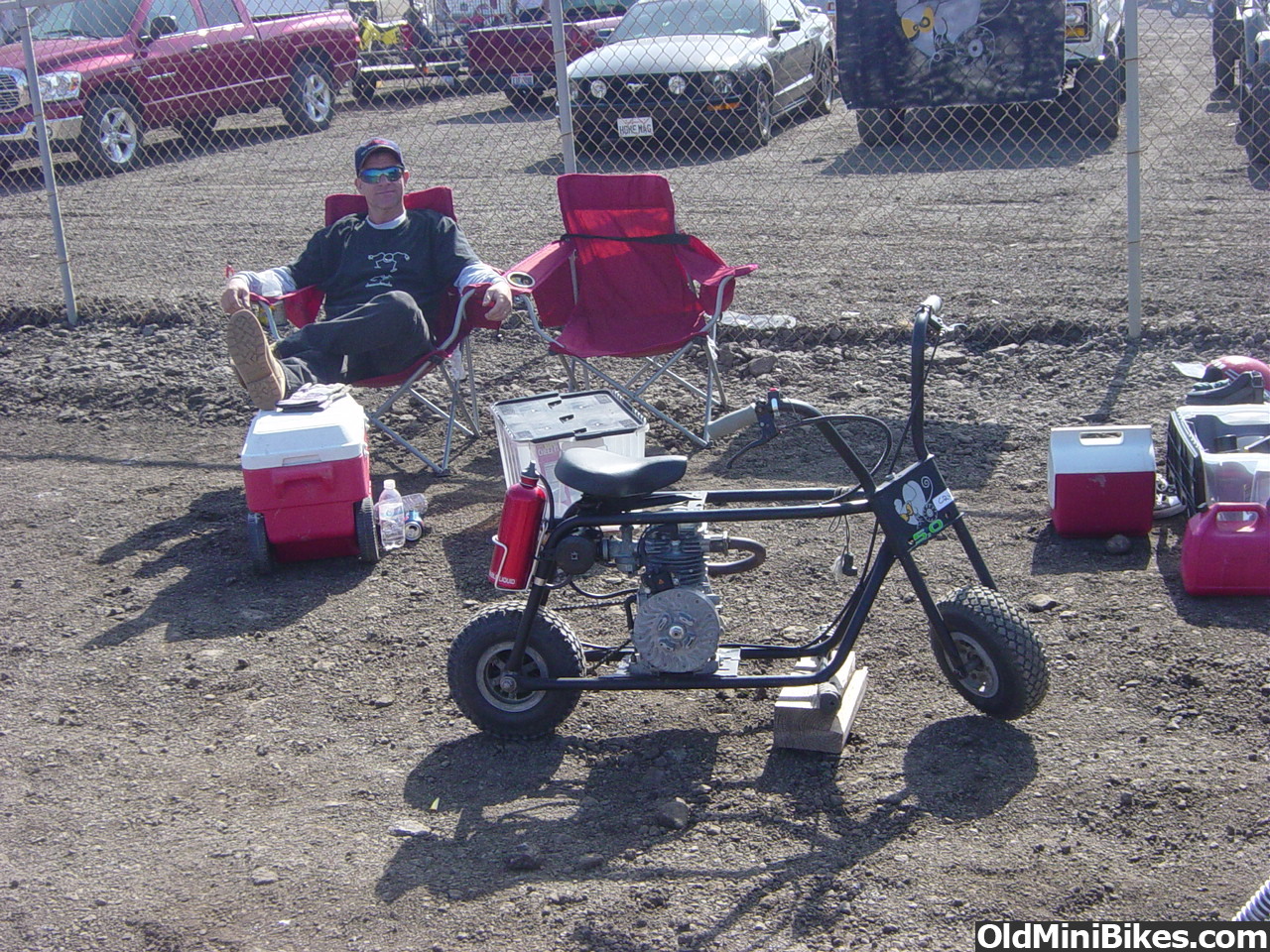

Cool deal Briggs; thanks. btw, Is that an OHV Tecumseh in your bike?

well sorry no pictures, the camera took a dump...it was 109 deg in the shop today, anyway my favorite is the Sigg SIGG Bottles - Swiss Reusable Bottles, Bags, Caps & Accessories - ReusableBags.com 1L (32 oz) good for 2+ races :thumbsup: I dont think they would endorse there product being used this way....oh well, didn't ask and don't care :shrug: disclaimer....kids and paranoid adults don't try this at home, anyway this will require some fabrication but I can give you a good place to start. drill a 23/64 hole on the top (yes top) 1cm off to the side of cap, you are going to make a pick-up tube out of 3/8 fuel nipple and 1/4 fuel grade nylon tubing, the tricky part is connecting them together, once you invent that you can self tap the nipple into the bottle with a small amount of JB on the threads(should be good for a couple years), back this up with a nut on the inside. you will know when you get it right. as for the cap, use a #41 (.096) drill bit to make a vent in the cap..it does not have to be a clean hole...... then you get to make a bracket for frame mounting, have fun!
#16
well sorry no pictures, the camera took a dump...it was 109 deg in the shop today, anyway my favorite is the Sigg SIGG Bottles - Swiss Reusable Bottles, Bags, Caps & Accessories - ReusableBags.com 1L (32 oz) good for 2+ races :thumbsup: I dont think they would endorse there product being used this way....oh well, didn't ask and don't care :shrug: disclaimer....kids and paranoid adults don't try this at home, anyway this will require some fabrication but I can give you a good place to start. drill a 23/64 hole on the top (yes top) 1cm off to the side of cap, you are going to make a pick-up tube out of 3/8 fuel nipple and 1/4 fuel grade nylon tubing, the tricky part is connecting them together, once you invent that you can self tap the nipple into the bottle with a small amount of JB on the threads(should be good for a couple years), back this up with a nut on the inside. you will know when you get it right. as for the cap, use a #41 (.096) drill bit to make a vent in the cap..it does not have to be a clean hole...... then you get to make a bracket for frame mounting :censure: have fun!
Love this; thanks Briggs! How about silicone tubing?
